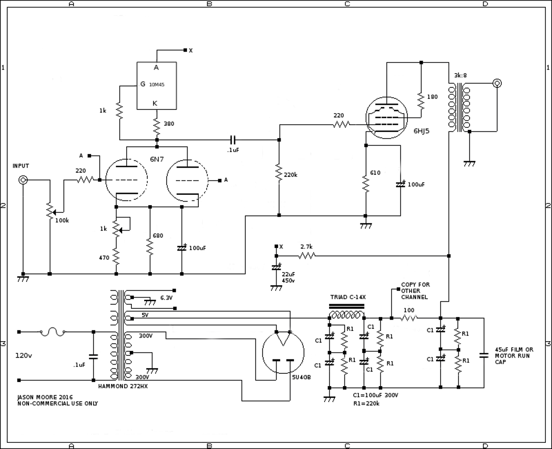

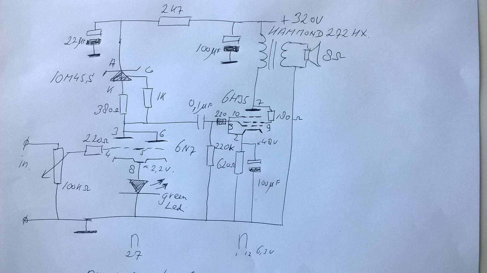

Hi, I threw my back out again so I am hanging on the couch today trying to learn the kiCad software. If I stop responding to other posts I might have the schematic finished up.
Hi guys, sorry for the delay. I have made some changes like putting an RC network at the cathode of the driver stage to adjust the plate voltage to ~200v, I had better results with this OP. Adjustment is made by a 1k adjustment pot at the cathode.
Here is a schematic finally, please let me know if you see any gross errors.
Thank you JosM for getting my back with that schematic!!! You posted one before me 🙂
Thank you both for the schematics.
