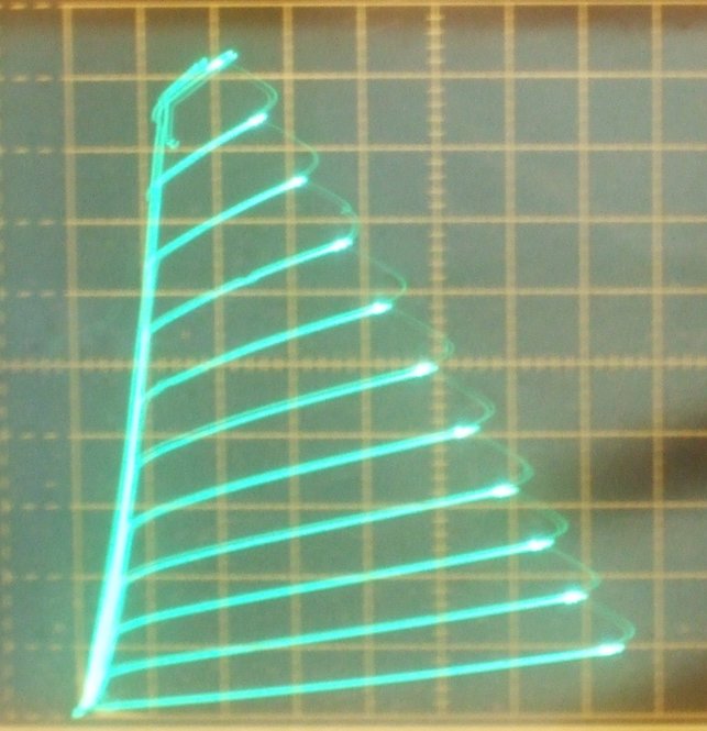

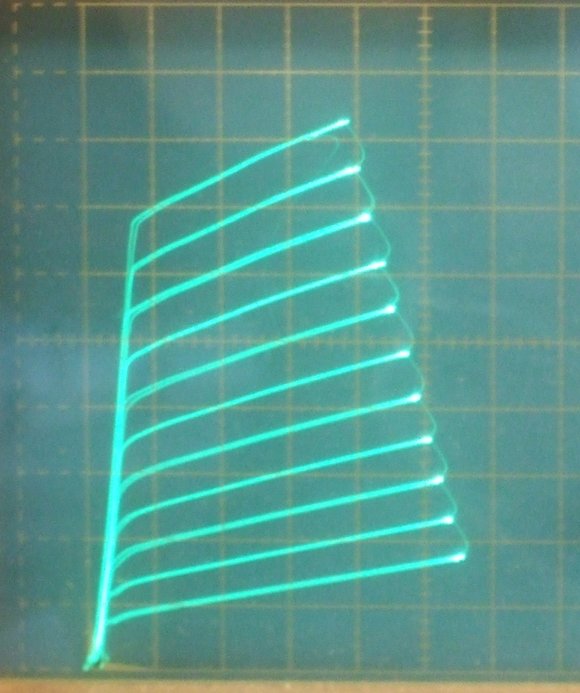

6HJ5 plate curves using "Crazy Drive" or "Twin Drive":
So many options... Those 6AV5 /6BQ6GA are fairly close to 1/2 of a 6HJ5, or to a full 6JN6/6GE5.
12BQ6GA (and 6AV5) in Crazy Drive / Twin Drive: (3.5V steps on g2, 50V/div Horiz., 20 mA/div Vert. I think)

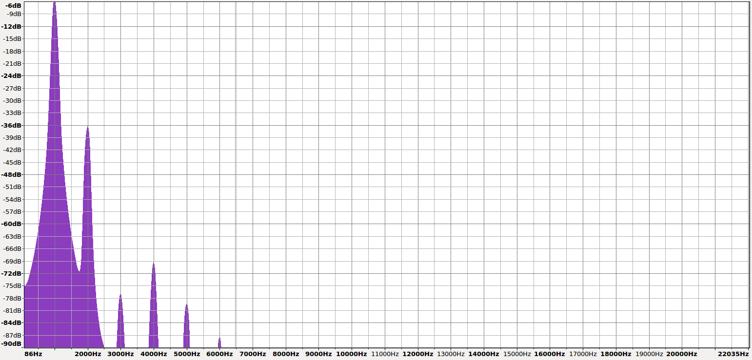

For anyone still interested in my 6HJ5 amp I finally got got around to look at the distortion spectrum on an FFT plot.
I have very efficient horns and probably never go over 1 watt, the amp sounds very nice!
Here is the FFT spectrum at 1 watt and 2 watts.

It never ceases to astonish me that fantastic compactrons like this were and are completely ignored by high end audio manufacturers. The unit to unit consistency is so high and they were so cheap in big quantities back in the 80s and 90s. And all those guys used were 12ax7s, 6dj8s, 6bq5s and junk 6550s. No imagination whatsoever.
A shootout between the two amps would be very interesting.
Yes indeed, I really look forward to hearing George's circuit and comparing a real DHT to a triode strapped pentode.
I couldn't agree more but I am kind of happy that they ignore these tubes, they are much cheaper for me this way😀
I have always enjoyed doing things differently and since this is diy I wanted to take the path that has been walked the least. I bought 5 sleeves of the 6HJ5 and you are correct in that the consistency is very good, these are well built rugged tubes. I am glad I settled on using them. The FFT proves what I am hearing, that these tubes are well suited for audio use.
I await four capacitors and then I can hear George's SE amp!! I may or may not start another thread about that amp.

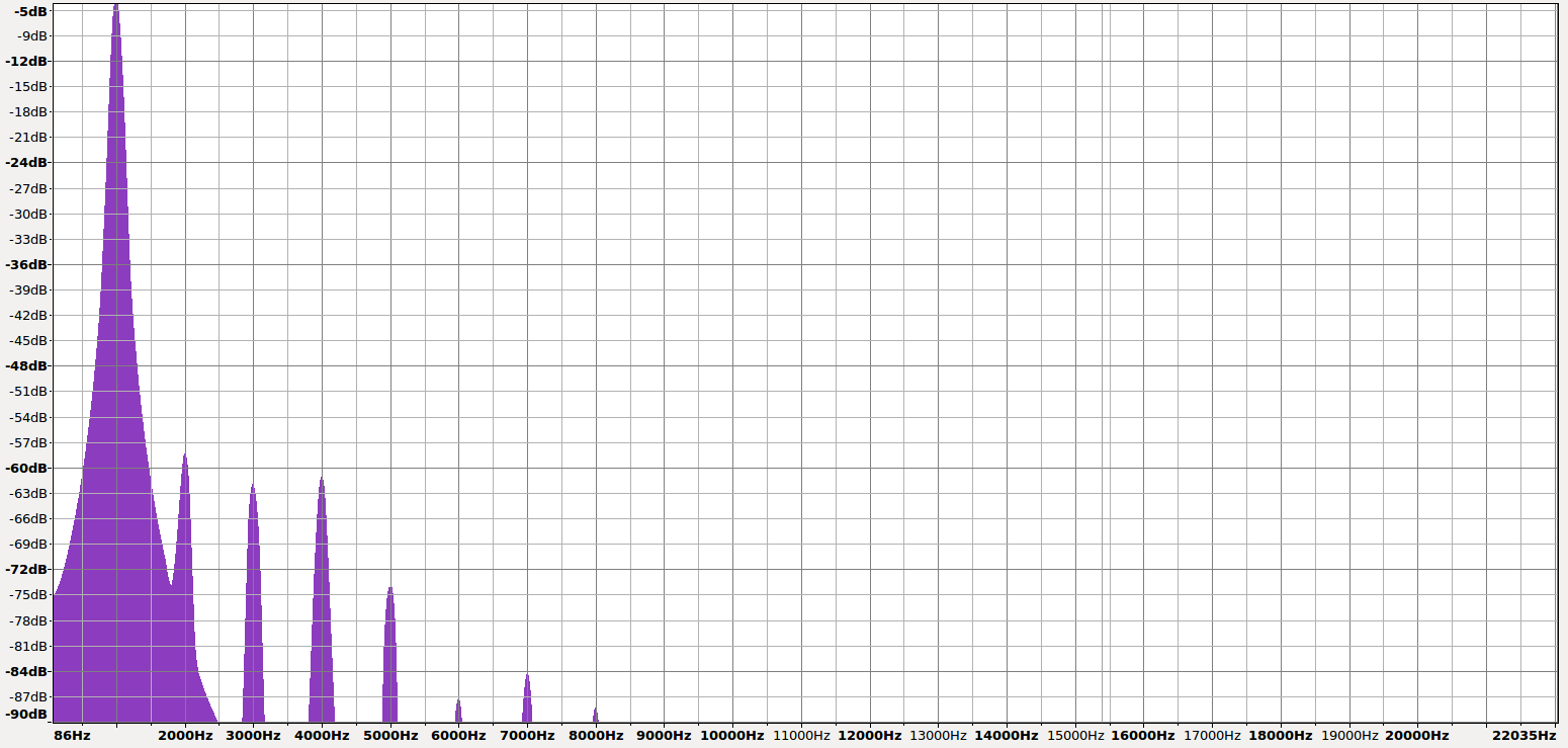

Here is a popular design from the far east.
SRPP front end into a 6L6 wired as a pentode with global feedback, good for 5 watts out.
It's a good sounding amp but not as pleasant as the 6HJ5.
Compared at 2 watts out into an 8 ohm load. You can see that the 2H is much lower but the odds are higher.

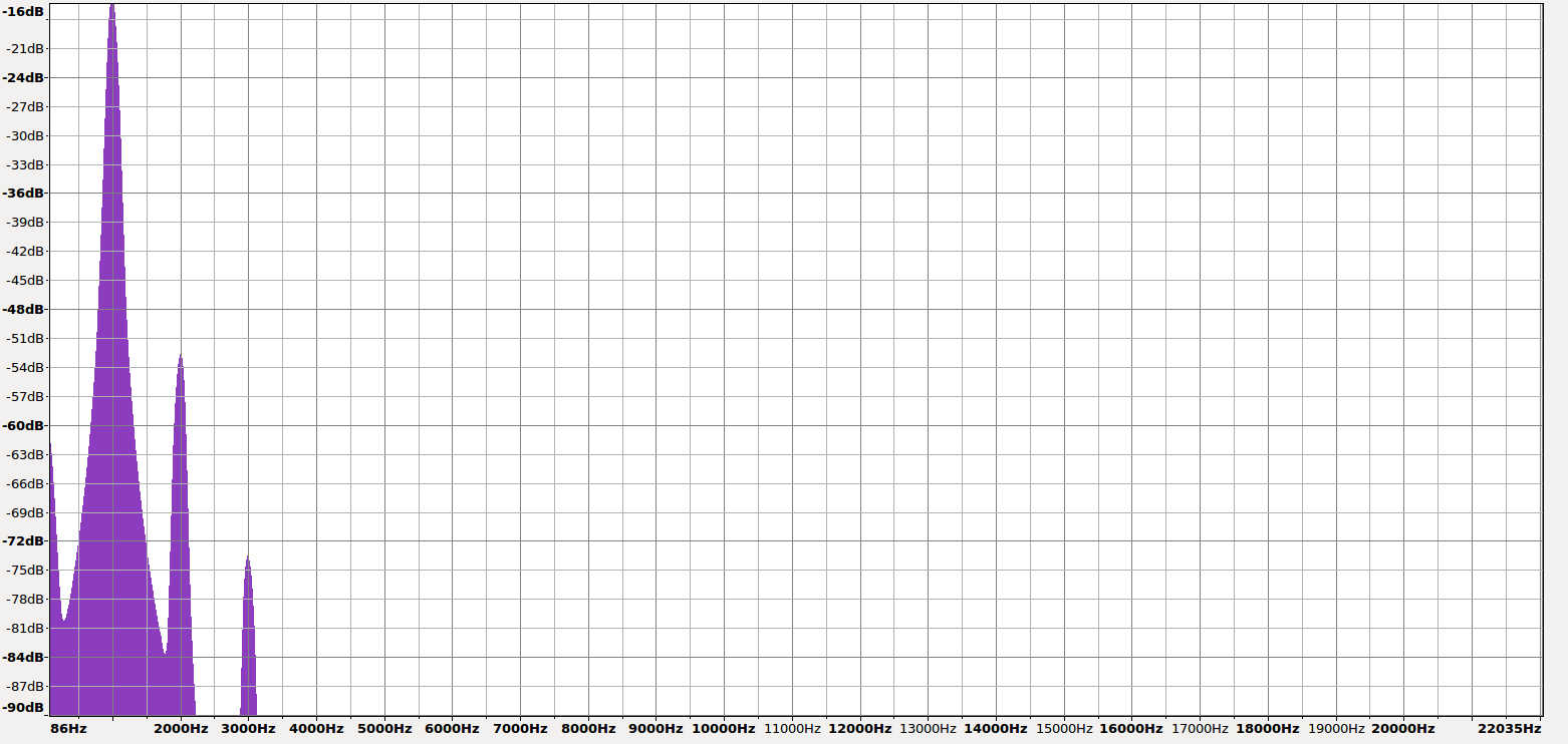

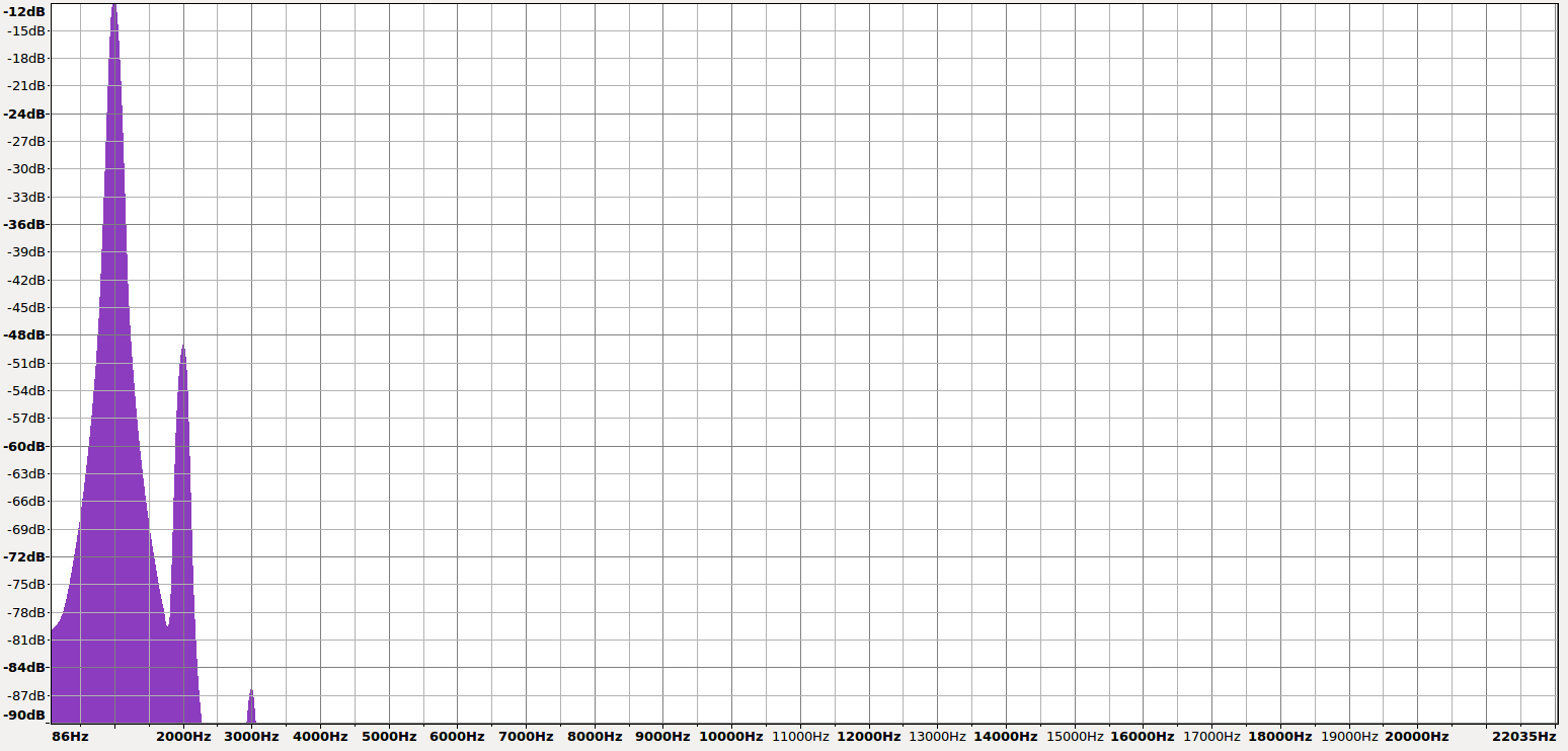

FFT @ 1watt vs 6HJ5 @ 1watt
It's hard to say because in changing from fixed to cathode bias I too changed the operating point by lowering Va-k and increasing current through the valve. I would think where I am not running this amp anywhere near clipping the added sonic improvement was due to the increased current and shifting the bias to the left/hotter side of the curves. Increased current gives increased gm and lower rp, all good things for a zero feedback design. Well at least I think so.

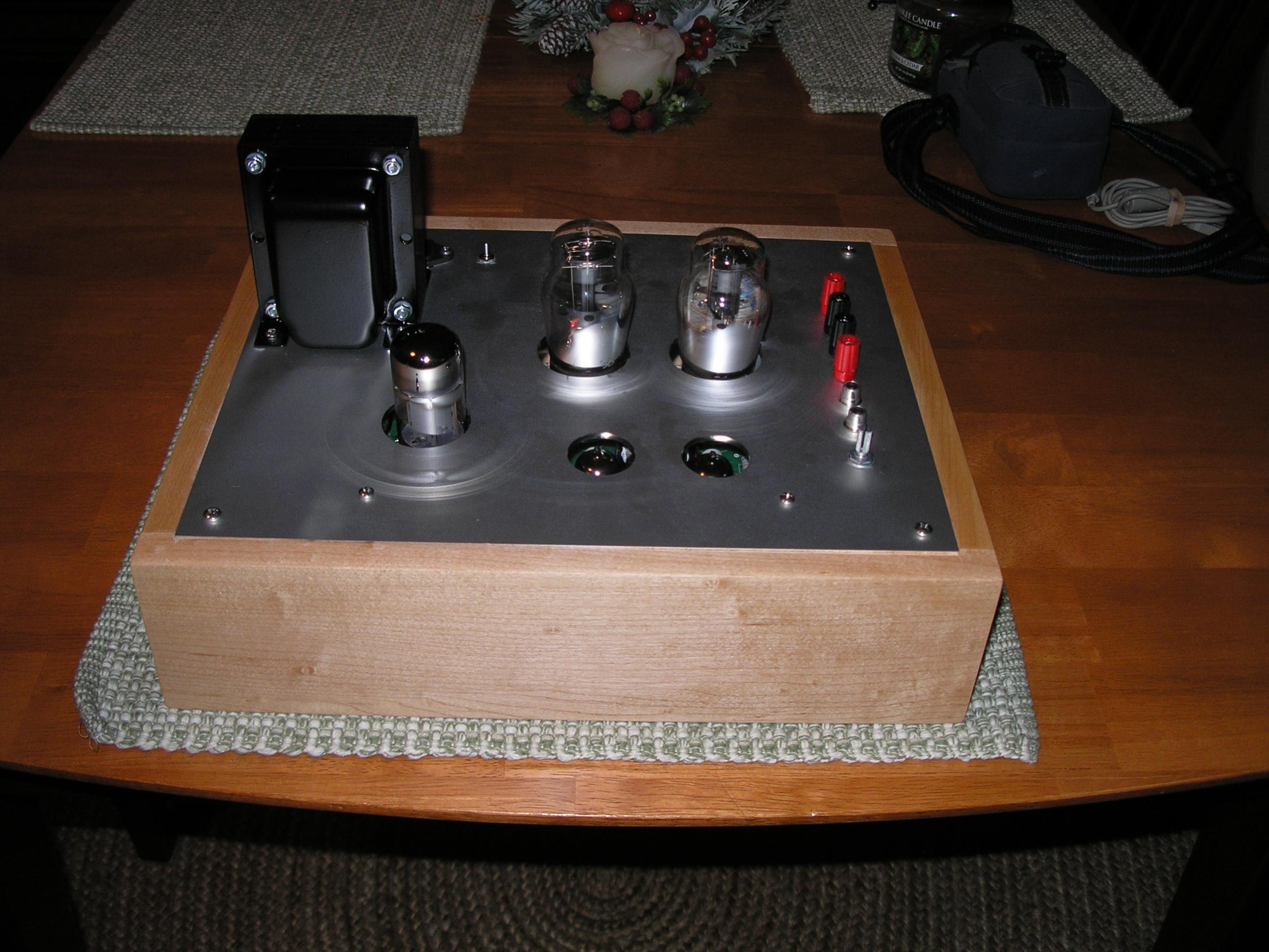

Here is my Tubelab 45SE build 🙂
