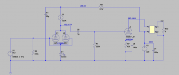

Yes those are 3k:8 10 watt Transcendar OPT.
Operating point is, Va=310, Va-k=260 @ 85mA.
6N7 has a 10M45S @ 10mA loading the plates and a yellow LED @ cathode.
I will post the full schematic soon. I am really enjoying this build, the sound is so beautiful.

For anyone still interested here are some more details.
Pout= 5 watts
Power supply is a CLC and then I branch off separately to each channel via RC networks. The supply is tube rectified via 5U4GB. The choke is Triad C-14X, 6H 150R. The 50uF electrolytic cap value is for two 100uF 350v in series with 470k balance resistors. The reason is for using the 5U4GB and the B+ jumping up to 460v during turn on. I used the 5V winding center tap to feed B+ to the power supply filters. The power transformer is a Hammond 272HX. Current source for the 6N7's is a 10M45S module with a 1k CC resistor up very close to pin "G" and a 380R current set resistor.
Actual Measured data:
C1 (50uF) V=356
C2 (50uF) V=326
C3 & C4 (50uF Electrolytic | | 45uF Polypropylene motor run) V=318
C5 & C6 (22uF) V=297
6N7
Va=170
Vk=2
6HJ5
Va=295
Vk=50 Rk=620
Ig2=4mA
g3 is tied to cathode

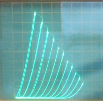

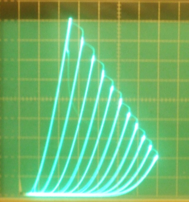

A couple of 6HJ5 tubes in triode. Usually very consistent. Raytheon tubes. (Argh, just found the zero was off by 2V on the left picture, left most curve is -2V then 7 V steps down from that.)
50 mA/div Vert., 50V/div Horiz., 7 V steps on grid 1
I bought 5 sleeves of Raytheon tubes from the same production batch. Of the dozen I put in the amp they all biased up relatively similar so consistency is good with the Raytheon tubes. I think RCA made some too but I don't have any of them.
