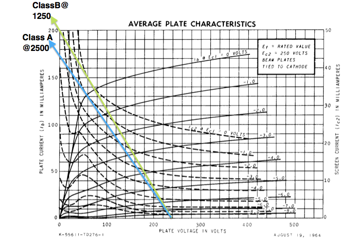

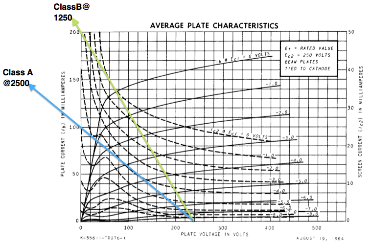

Ok , here is me trying to do AB load line , please feel free to comment on the loadline.
Almost there... follow smoking-amp's instructions and refer to the plot on post #10, do you see the class A load line in light blue? You need to shift your class A load line up by the idle current. It is also better to use the Ep-Ip characteristic (Eg1) with a fixed screen voltage instead of the one you are using which shows Eg1=0V at various Eg2's.
ok ,new loadline, gone with 250vdc
My interpretation of how i see it.. on left right side org is a difference

Ok , this is baffling that class A 320vdc loadline is no longer @ 2k5 it is more like 2k3 , you
use a different primary load to put the class A portion in the linear area where the knee is correct me if i am wrong .
cheers again
skal
No I did the sketch rather quickly, so the slope looks to be off, in reality, the slope should still be 2.5k, the key is to have the load line pass through 250V and 33mA.
hmm, i thought the loadline was the op point , this were the confusion set in { laugh}
So, i still do not fully understand your manoeuvre but i am getting their , i know theirs a lot more to understand distortion , clipping and other stuff , i know i learn't a lot over the pass day's.
