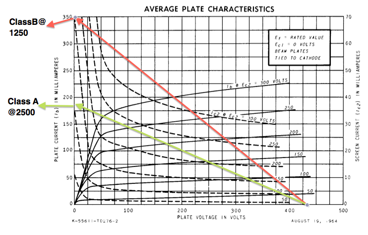

well, i know i need some kind of step by step guide on how to plot a class AB load line with my 5k primary out tx, any takers..😀

well , this is first amplifier and i do not want to give up so easy , i am going to dig a bit deeper , and get some info on plotting AB1 loads...

You should be able to find some good info on plotting loadlines on the Web, or Morgan Jones book. Basically the tubes see 2X the OT reflected impedance when both P-P tubes conducting, and 1X when only one is conducting, so you have a load line with a kink in it. It smoothes out some to a rounded bend when considering the smooth transition from class A to class B given by typical tube non-linearity. You have a selectable parameter as to how much overlap occurs in class A (tube biasing). More overlap (in class A) gives lower distortion, but less Watts out due to hotter running.
One then plots the intersecting load line, re-adjust for plate dissipation limits and distortion profile, re-tweak, on and on.
The other way is to just use a variable Vg2 supply and variable Vg1 bias, adjust for least distortion within plate dissipation and screen grid dissipation limits. (A variable B+ supply is nice too, but an initial load line analysis should get you in the ballpark close enough.) Essential to have a current limit adjust on the Vg2 supply to protect the screen grid. An FFT (sound card) analyzer is quite useful too. Oh, and use the ears to listen to it occasionally. Play something through it. Load lines won't get you to the final fit and trim like this will. They are your starting point.
George (Tubelab) has found that +150 V on g2 is a good starting point for a lot of TV horizontal sweep tubes. Select the B+ to fit the OT primary Z (allowing for minimum tube cathode- plate voltage, ie, saturation, like 60 V), without exceeding the max plate current or plate dissipation limits (leave some reliability head-room). Fine tune from there.
Of course, you need a driver/splitter front end to do all this finishing/'tweaking. So a good idea to build a capable one for testing 1st. Feedback comes into this after the open loop testing is perfected.

I already showed the 6k load line in post #13, so you can just tilt it up a liitle bit, for the actual instructions see Merlin's page here. Just a reminder, that the datasheets appear to be off a bit based on the samples that smoking-amp and myself have traced.well, i know i need some kind of step by step guide on how to plot a class AB load line with my 5k primary out tx, any takers..😀

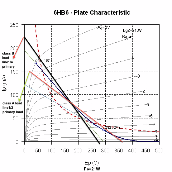

What's your B+ voltage? Class A looks ok but class B looks off - it should intersect B+ on the Ep axis or (Ep,0).Ok , here is me trying to do AB load line , i used jazbo8 curves
B+=375vdc same screen voltage 243vdc
Class B loadline 0.220ma at 1250=275vdc

I see, in that case, the class A load line is wrong as well, so please look at Merlin's tutorials again, the class B load line must passes through B+ = 375V, and Imax = 375/1250 = 300mA. The class A load line needs to be shifted up by the idle current, so it passes through (375, Ia0), where Ia0 is the idle current.
