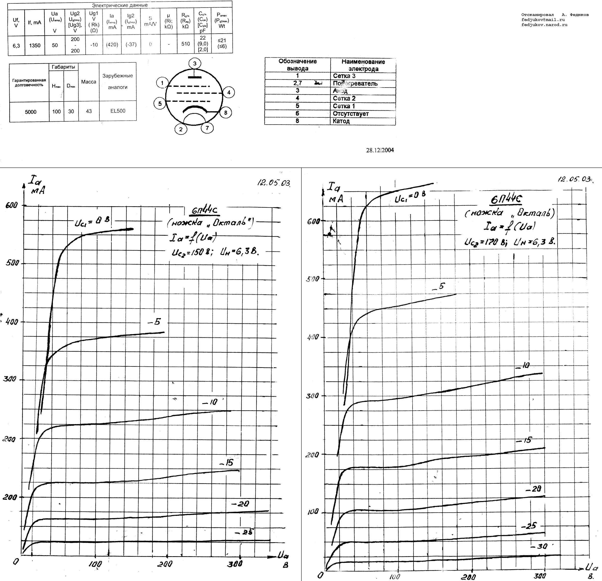

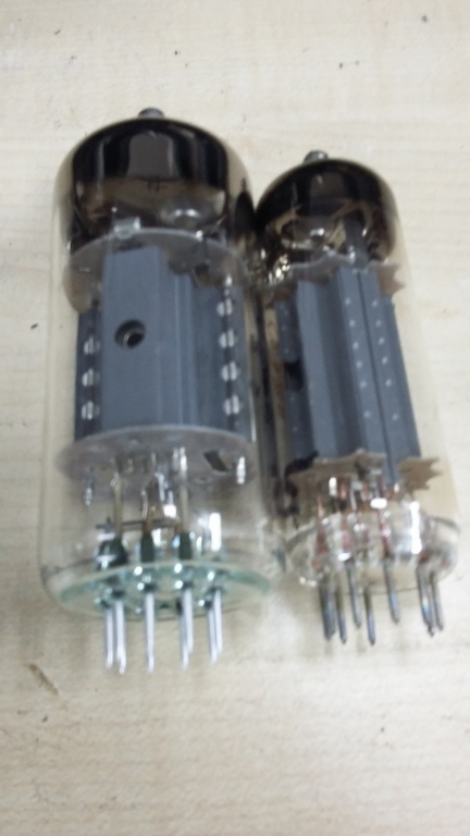

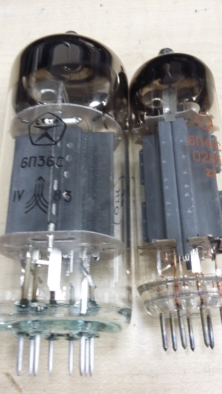

6P44S is mechanical and electrical equivalent EL500/6GB5.6P36S seems to be the EL500/6GB5 equivalent
6P36S by the manufacturer data is also equal to the EL500 / 6GB5, but in practice it is much stronger and more durable tube, and mechanically completely different ("frame grid").

6P44C/S 21 Watt (data curves attached below)

The plate surface of the tubes 6P36S is ~ 2x greater than the surface plate area of the tubes 6P44S, and a heating current is greater (If ~ 2A versus ~ 1.35)!
In practice, I worked a lot with both types of tubes, so I can say that 6P36S serving permanent with anode dissipation of ~ 28-30W in SE amplifier (class A1), and 6P44S not more than ~ 22-23W in equal conditions.
I see, a bigger bottle for the 6P36S too.

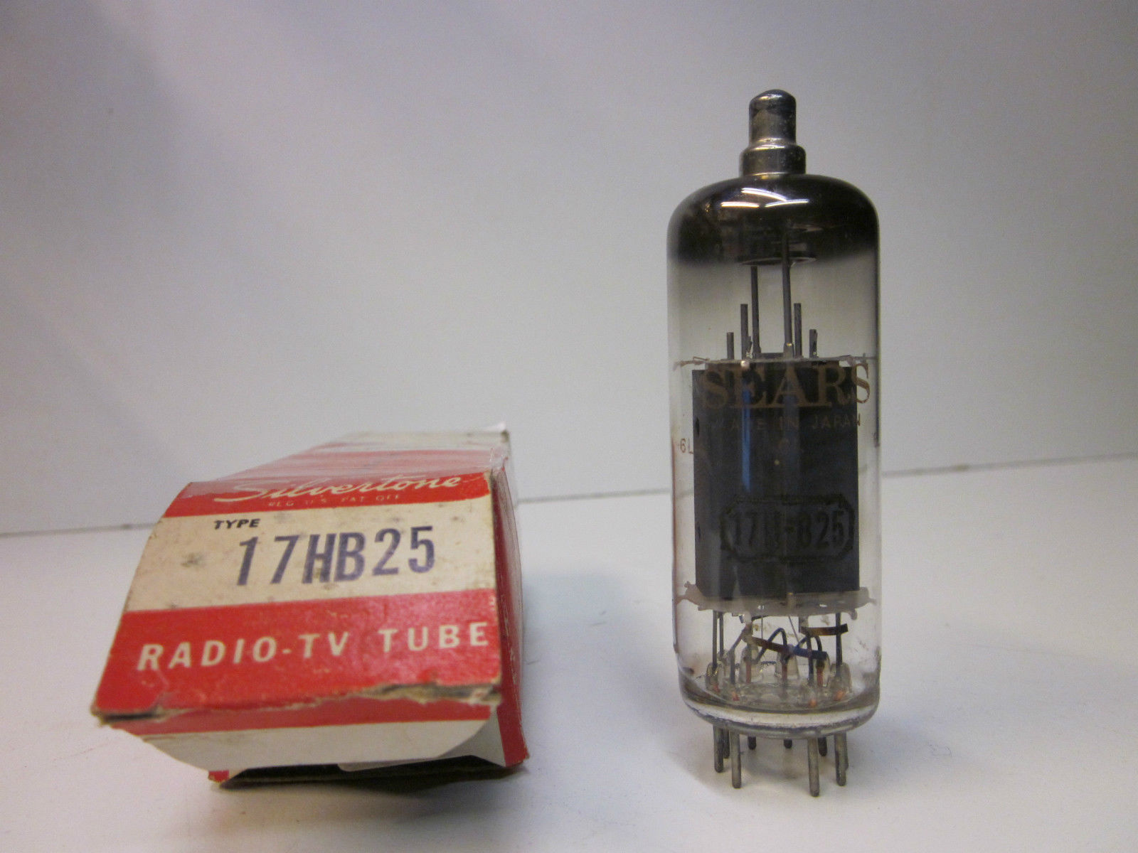

17HB25 is still on the $1 list, cannot find data except Hickok test parameters. Looks like a 6GB5 and tests like one too (except heater V).
Seems there is a 12HB25 also, Novar, made by Toshiba.
And some data:
12.6V/0.26A(6.3V/0.52A) Ehkmax=±200V
Ppmax=13W
Epmax=6700Vpeak
Pc2max=5W
Ec2max=250V
op : Ep=100V Ec1=-7.7V Ec2=100V Ip=100mA Ic2=7mA rp=5.3kΩ gm=14mS μg2g1=6
pins : 1(G1)-2(G1)-3(G3)-4(H)-5(H)-6(G2)-7(G2)-8(G3)-9(K)-TOP(P)
heater variants : 6H-B25(6.3V/1.2A), 17H-B25(16.8V/0.45A)
A 6GB5 look-alike.
The 12HB25 heater current is rather low. (error in data?) The other htr V types are similar to 6GB5 etc. Gives a 100 mA operating point.

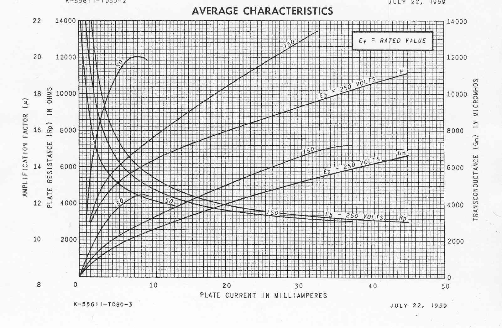

"should I be worried about 6S4A availability " "I have a hankering for a Gilmore KGST amp for my Koss electrostatics"
ESRC has them for $3.
Judging by the Mu curves, I don't think the 6S4A is going to become a block buster for SE amps. But for P-P amps, the near linear ramping gm curves sum to near constant gm. No idea how common they are. TV tubes usually are plentiful until they get "discovered" for something.

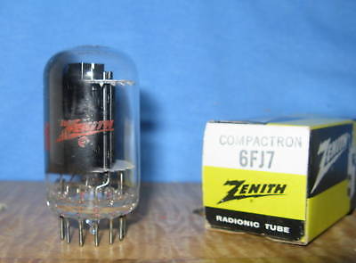

You could always switch to the big 10 Watt triode in the 6FJ7 TV tube. 550 Volt rated like the 6S4A and similar Mu. It's on the $1 tube list even.
https://frank.pocnet.net/sheets/093/6/6FJ7.pdf

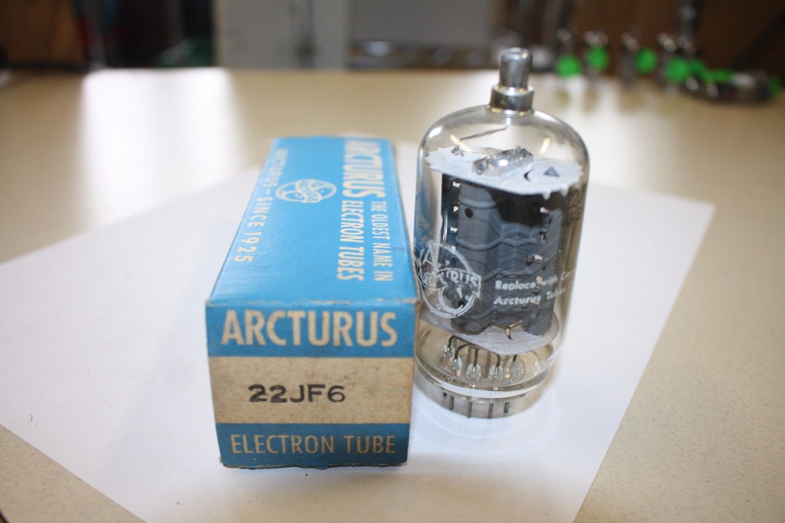

Best I recall, I could get almost 200 watts output from a pair of 6JF6 on 75 meters. Stability and neutralization were, um, problematic.
Not $1 each, but still a pretty cheap tube. I hadn't really thought of trying them in an audio amp.
Win W5JAG
Win W5JAG
Well, I'd be truly impressed if you can get 200 Watts audio out of a 6FJ7,
but I think 6JF6 is a different tube.
Tubelab, maybe.... (for 3 seconds anyway, until flash-boom)

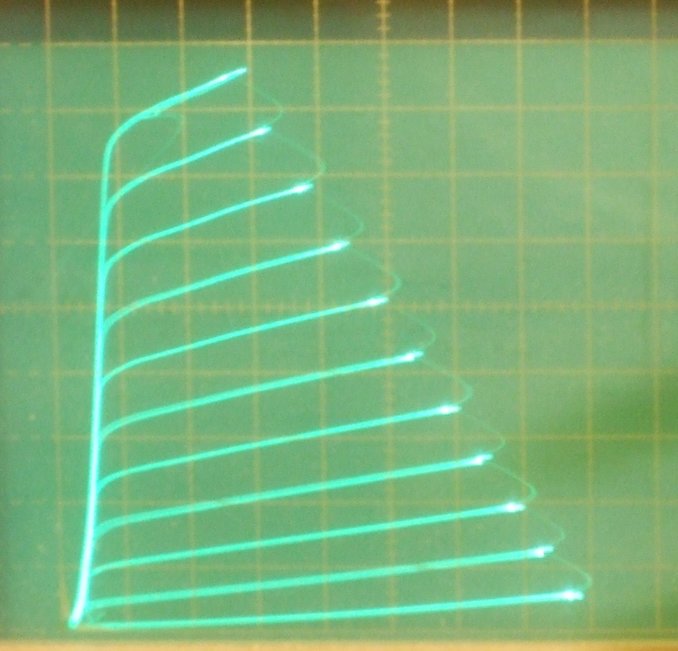

22JG6 (= 6JF6) curves in Crazy/Twin Drive:
No doubt you can get good audio using the 6JF6.
