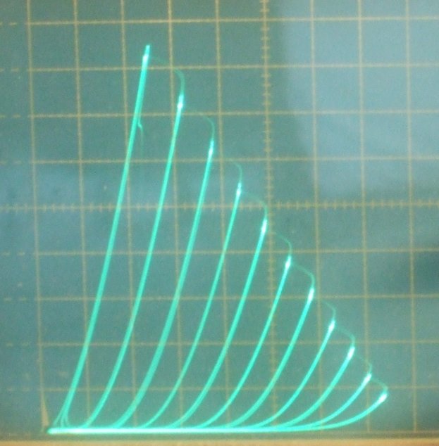

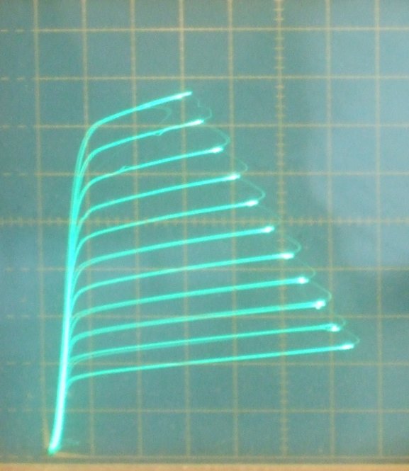

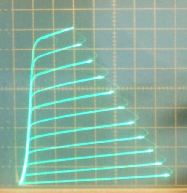

Here are some plate curve sets for 13GB5. All curves are 50 mA/div Vert. and 50V/div. Horiz.
By the way, 13GB5 is nearly identical to 21HB5 for plate curves. (another $1 tube back when, but 12 pin Compactron)
1) 13GB5 pentode, 130 Vg2, 2 Vsteps on g1
2) 13GB5 triode, 7 Vsteps on g1
3) 13GB5 g2 drive, 110 V max Vg2, 7 Vsteps on g2
4) 13GB5 Crazy/Twin drive, 75V max Vg2, 7 Vsteps on g2
