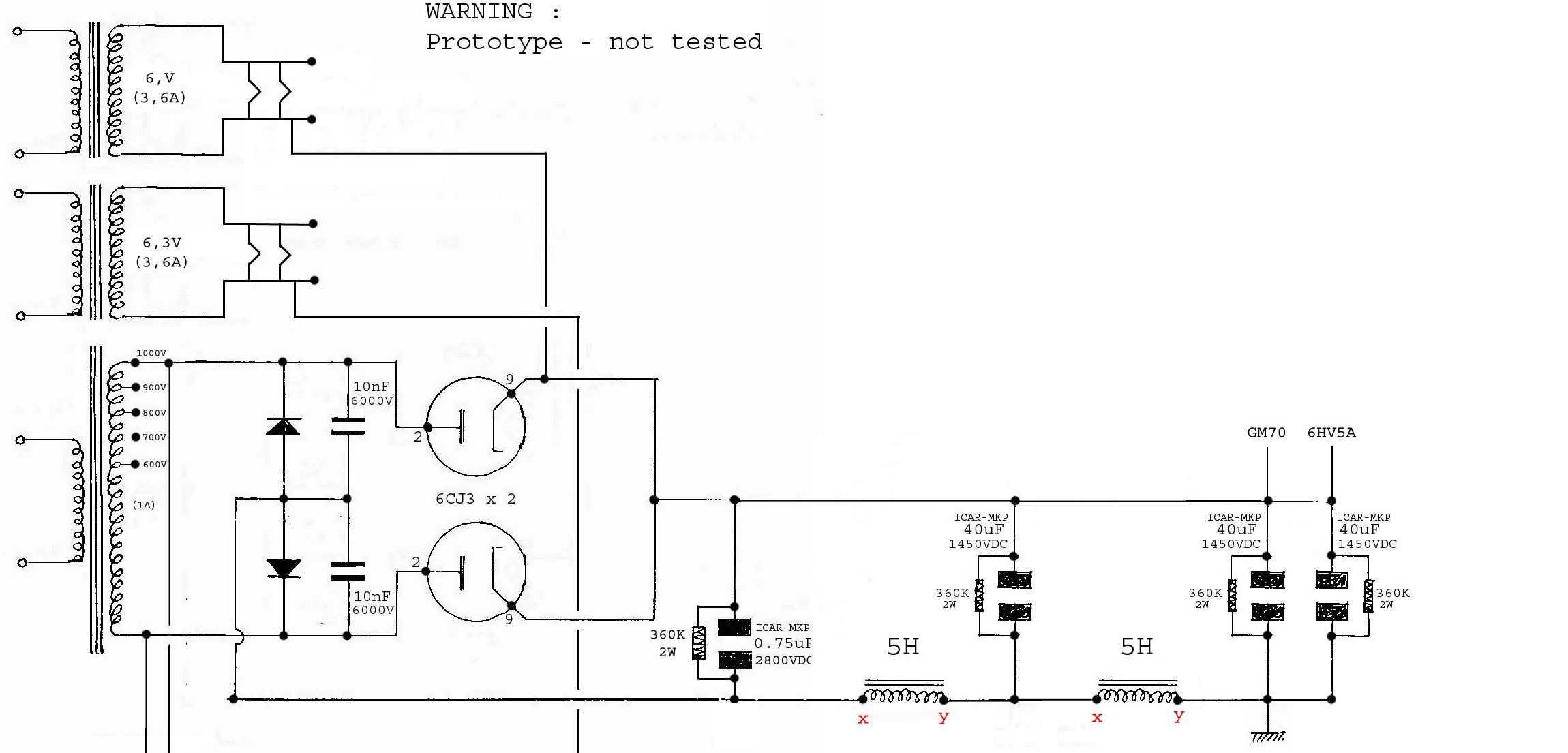

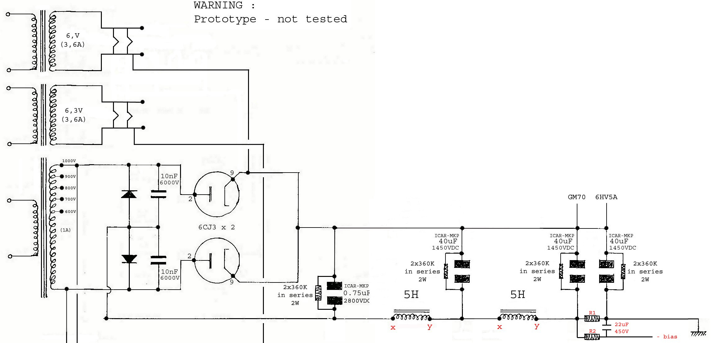

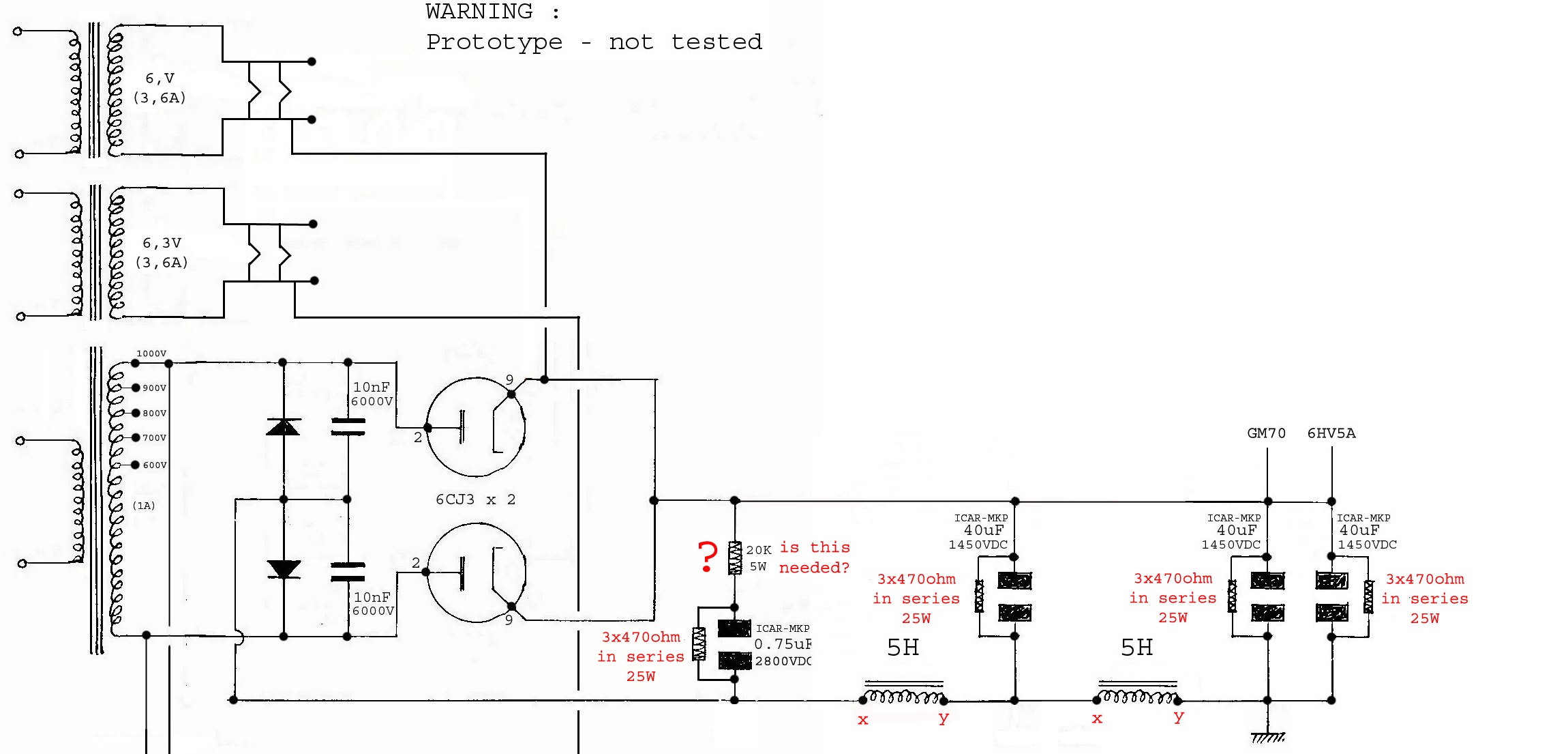

Yes that looks OK, I would recommend stacking 3 or 4 resistors in series on each cap for bleeders as most individual resistors do not have sufficiently high voltage rating. (I use three 450V rated 2W resistors in series for each cap.) You can make this a note (nota bene nb) in your schematic.
No way!! 470R resistors, are you mad?! Here:I modified stealing from a similar scheme that is statp published in a magazine of sound construction. Look a little if that further resistance from 20K-5W I designed the first capacitor filter is good for something.
Or if it's better without.
OK! true! Last night I collapsed from sleep and in redesigning the scheme I did a bit of confusion ...
merlinb : "Nothing that springs to mind. Sometimes the amp runs directly off the reservoir cap in which case you obvously can't do it, and sometimes you have a bias supply derived from the same transformer winding, which confuses matters if you have something in the ground side of things. But if you can do it, I think it is usually worth it."
Through automatic translator can not understand completely the messages, difficult to translate to the technical content. In the cited text talking about bias.
You can obtain it in this way (with the inductors on the negative side)?
Or in this way is to avoid?
I've been looking at the 6CM3 as well, and it's counterpart the 6DN3 both have similar ratings, 5500 peak inverse plate voltage, 400mA average plate current, and the same heater-cathode ratings as the 6CJ3. Both the 6CM3 and 6DN3 datasheets show a Peak plate current rating of 1700mA.
These don't seem to be as common, but I can see that there is some cheap availability. It's got a higher heater requirement of 2.4A, but that's not a big deal.
Then I think I'll be able to go with a 1420VAC HT winding and a 15uF first capacitor.
Thanks for the help everyone.
