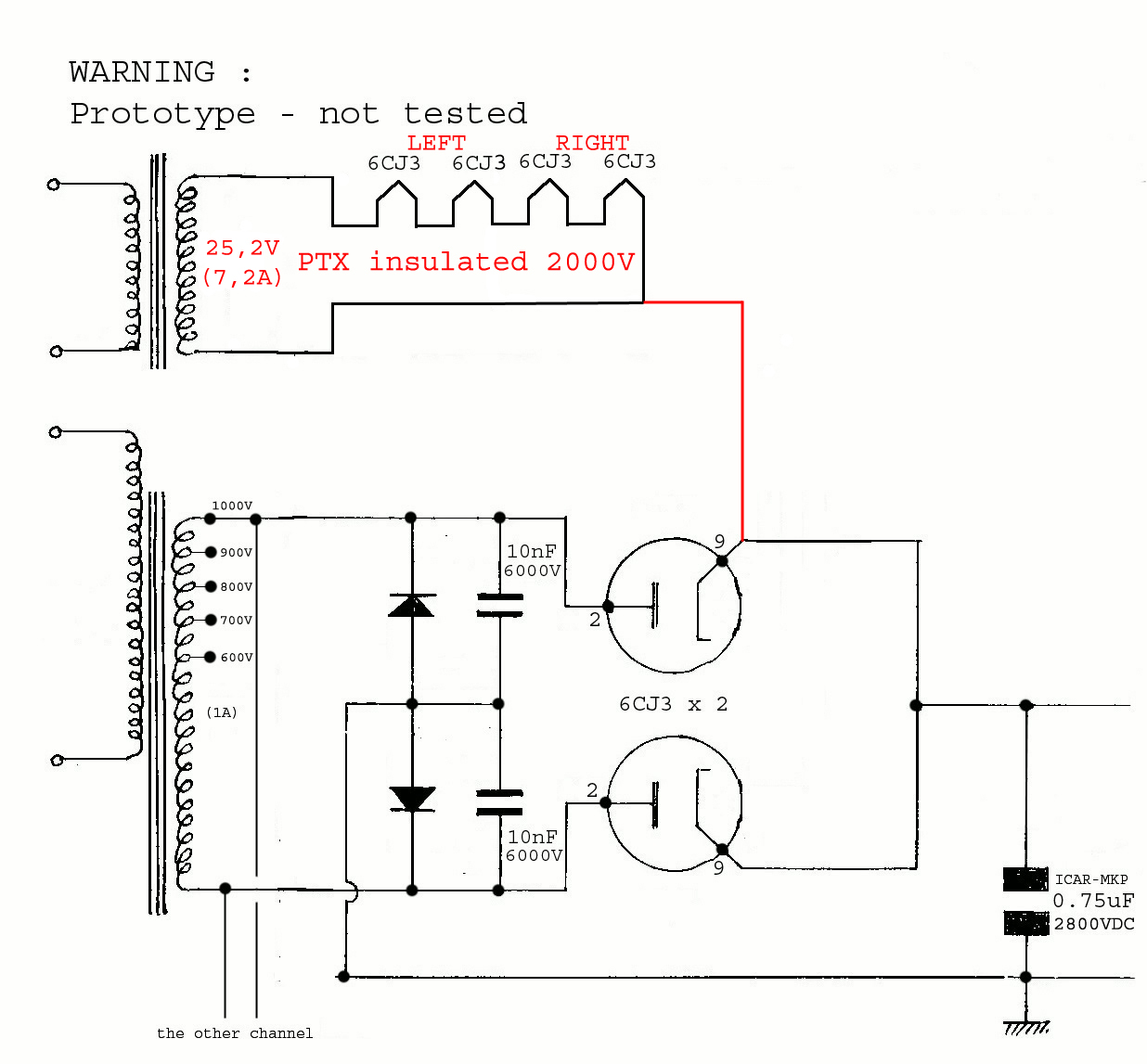

I'm designing a power supply right now for an amp that needs to supply 850V @ 180mA. To do this I will be getting a power transformer with a 1400VAC center tapped HT winding. Upon doing some research I'm thinking I might like to go for 2 6CJ3's in a full wave rectifier configuration.
Now I've been searching online for the safest / best way to do this, and although it seems like many people have done this, I haven't come across specifics with relation to the heater supply and how exactly to wire this up.
Initially I had thought that perhaps it would be best to use 2 seperate 6.3V @ 2A windings, one for each 6CJ3, but I've come across a few posts on the Vinylsavior blog where Thomas uses a single 6.3V winding for 2 diode tubes in a similar configuration.
This design for instance (using 6AX4 tubes) VinylSavor: Single Ended Amplifier Concept, Part 7 I see that he uses a single winding with a virtual center tap for both of the 6AX4's as well as a 6N7.
I've read threads on here where people talk about connecting the heater to the cathode of both tubes in a configuration like this, and others where people just float the winding, and then ones like the one above where people reference it to ground..
I just want to make sure I do this in a safe way, and so what I'm thinking of doing now is using a single 6.3V @ 4A heater winding for both of the 6CJ3's in a full wave rectifier configuration, leaving the winding floating, and not using it for any other tubes. Is this a safe / good way to utilize these tubes in this manner?
Here is a picture of what I'm thinking

I might like to go for 2 6CJ3's in a full wave rectifier configuration.I've read threads on here where people talk about connecting the heater to the cathode of both tubes in a configuration like this, and others where people just float the winding, and then ones like the one above where people reference it to ground. I just want to make sure I do this in a safe way, and so what I'm thinking of doing now is using a single 6.3V @ 4A heater winding for both of the 6CJ3's in a full wave rectifier configuration, leaving the winding floating, and not using it for any other tubes.
One winding is fine, it's the heater-cathode voltage that matters. You should connect one end of the heater to the common cathodes to ensure that the voltage difference is small, and not use this winding for other tubes.
Okay, that makes sense, floating heater winding connected to common cathode of rectifiers and no other tubes.
Like this
That heater winding needs to be HIPOT isolated too correct?
Sure, you can test it for an isolation greater than the B+ value, say twice. Do connect one side of the heater winding to the cathodes though,
because I have never seen a rectifier's heater winding completely floated, although it may work.

In the case of the amp in the link, the B+ voltage is rather low, so it is save to reference it to ground. In your case it is better to have a separate heater winding to which you can connect both 6CJ3. Connect one end to the cathodes.
Make sure the isolation of heater winding of the transformer is rated for the voltages which will be present!

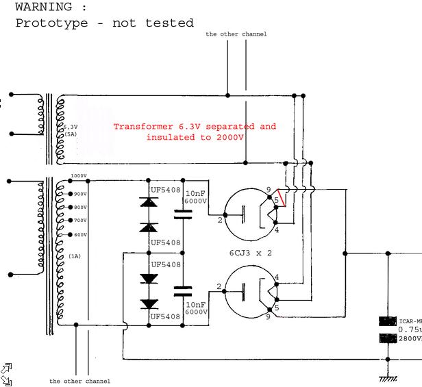

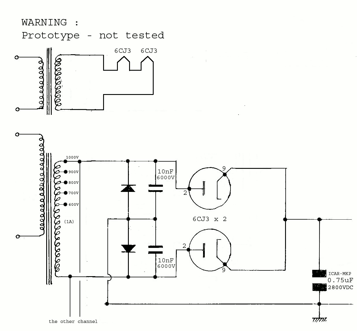

What is the right connection?
I thank those who respond.
Best Regards to all
Best Regards to all
None of them; you cannot ground the heater supply!What is the right connection?
(It doesn't matter if the heater transformer is separated)
Thank you so much correction. It is now clear.

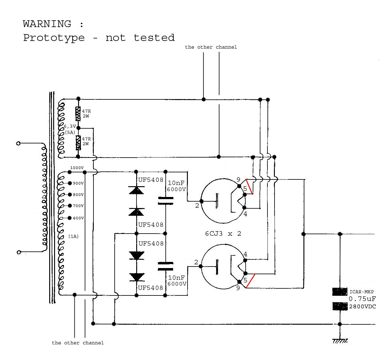

I drew the third variant because I already have the power transformer. But I do not know if the winding 1000v and what to 6.3V are isolated up to 2000V between them. For this thought to connect the filaments of 6CJ3 to a separate transformer as to build with a capacity of isolation the most
high as possible.
high as possible.
Best Regards to all

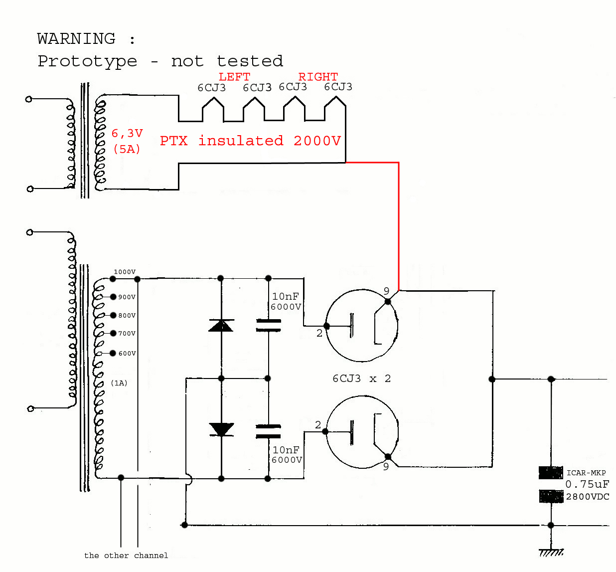

None of the above. Here's how I'd do it:
1) For the negative rail, use one 10KV diode instead of two in series. You can get 10KV Si diodes these days, so series connections with all their problems may be avoided.
2) Separate heater PTX for the 6CJ3s. You don't want to run these heaters off the same LV winding as the rest of the VTs in case you have an HK insulation failure. It's better to float the heaters on a separate winding so that nothing poofs in case there's an HK failure. I'd also use a series connection with a 12.6V heater PTX, but you don't have to.
It's best to give the hollow state diodes their own heater PTX regardless of whether you opt for a series or parallel heater connection.
E😕xcuse my little knowledge of electronics. I do not understand what it means to PTX.😕

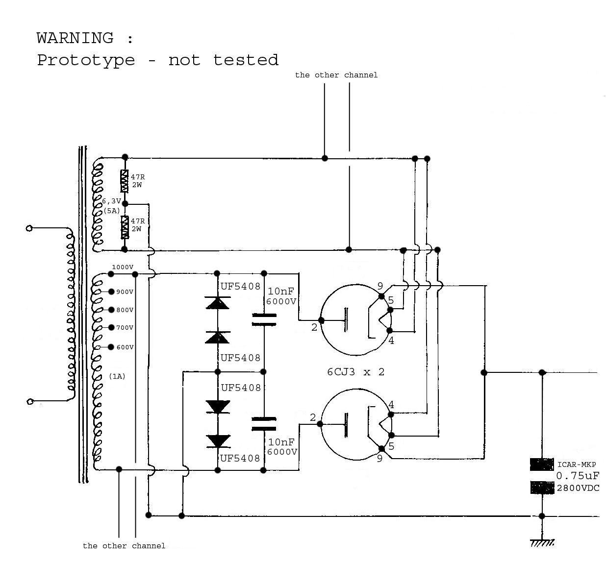

I do not see the connection between the filament and cathode. It 'an oversight or is fine just like that?
PTX = Power Transformer.
He's saying to use a separate filament power transformer for your diodes.
I usually connect filament and cathode. Otherwise you could exceed the heater to cathode voltage rating.
Almost. If all four heaters are in series then you need a 6.3 x 4 = 25.2V heater transformer. Think first, then post! 😉So it should be ok.
