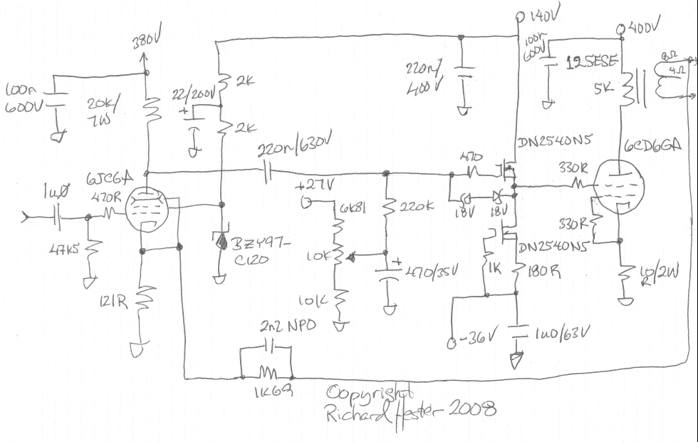

6CD6GA in Enhanced Triode Mode for SE Amp
Here is the schematic I have so far. The pot will be used to adjust the 6CD6GA screen to about 10V to get the desired idle current. The cathode follower current source loading allows me to adjust the grid voltage on the follower for proper 6CD6 screen voltage without the cathode follower bias current varying all over the place. Power supply schematic will follow.

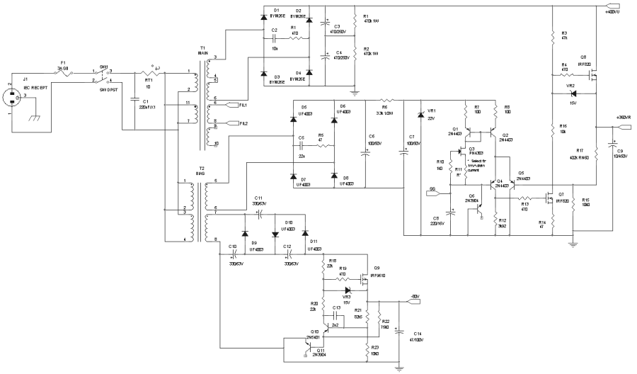

Here is the first revision for the power supply. I'm using oddball transformers that I have on hand, elsewise I would cite part numbers. I'm using a lot of sand in the power supplies because space is tight in the chassis I've chosen.

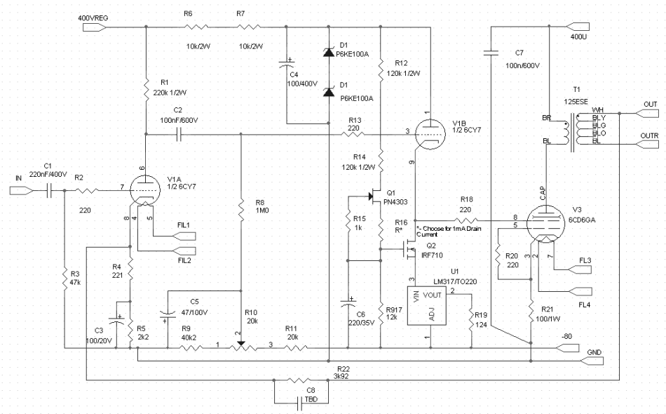

Boy oh boy, this amp has certainly been through a lot of changes since I started it (quite a while back). The current design (4th iteration or so) uses a 6JC6A frame-grid pentode to directly drive the screen of the 6CD6GA (the 6JC6A is another one of those "little pentodes that could", just like the 12HG7) . The design was inspired by Peter Millett's SE triode-connected 813 amp using a 12HG7 as input/driver stage. The screen grid bias resistor on the 6CD6 is only 33k, connected to a pot from a +36V regulated supply, (bypassed by a big cap) for bias current adjust. Screen current draw appears negligible at ~ 20V screen bias. I'm shooting for ~60 mA quiescent current in the output stage, which should net me about 8-9W/channel. I'll post a schematic when I'm more sure about resistor values. I'm using a mixture of fixed bias and cathode bias in the output stage, and will probably cut the cathode resistor down to 100 ohms from 120, so I have more freedom for bias adjustment.
One thing I've found is that the GE 6CD6s I have on hand require substantially less positive bias for the same plate current than the RCAs. I originally plotted screen-driven curves for the 6CD6GA using a GE sample, and used these curves to plan for the screen bias. No biggie, since I wanted to use the GEs anyway, and only had the RCAs in place as sacrificial goats while I was tuning in the circuit. Anyway, the GE tubes are in place and the output stage bias is where I want it. Next is to apply a signal with a resistive load and look at open loop gain, also sniffing around for antisocial behavior such as oscillation in the input tube. If all looks well, I'll close the loop, dress the wires, and try to drive some speakers. Finally! This was supposed to be my first quickie tube amp - instead, it's a rather distant second. The "Shrine" was my first, and is still doing duty in my living room.
Measurements tonight indicate an open loop gain of 15X, which doesn't give me a whole lot of room for negative feedback to tighten up the bass response and lower the output impedance. I could shift a couple of wires in the filament supply and drop in a pair of 12HG7s in place of the 6JC6 input tubes, which would almost double the open loop gain. I may try just that to see how much juice I can squeeze out of a simple circuit before resorting to more desperate expedients like dropping a follower stage between the input and the 6CD6 output.
On a brighter note, the waveforms I've measured look reasonably clean, with no tendancy to run away and tweet RF-wise.
Well, last night I tried a 12HG7 in place of the 6JC6A, without a substantial gain increase, probably because the tube is running only at 9-10 mA plate current. There is also clipping at the positive peak of the output waveform due to the screen current draw.
Peter Millett got around this in his 813 design by using the 12HG7 with high plate current and smaller plate resistor. I don't feel like blowing all that power in a plate load resistor, so I'll opt for the chicken-livered approach of inserting a source folower between input tube and output.
I'll switch back to the 6JC6A input tubes and save the 12HG7s for a situation where I need a bigger gun. The follower will need a different supply with some negative bias, but I think I have just the little transformer for the job - I'll know tomorrow. I'm eager to finish this amp, so I can get it off the bench and move on to some of the other projects I have lined up for completion.

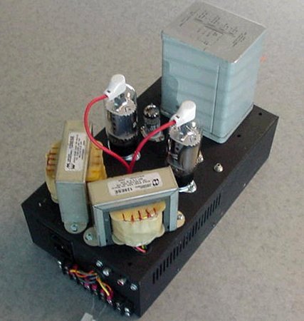

Screen Driven 6CD6 (Introducing Miz Piggie)
Attached is a picture of my screen driven 6CD6GA SE amp, "Miz Piggie". She is in debug stage - one side biases up ok, the other has a problem with the source follower driving the screen. As soon as I fix this and check for hmmmm, I'll post the schematic. Front end uses a 6JC6 video driver pentode, follower by a source folower directly coupled to the screen of the 6CD6. I call her Miz Piggie 'cause she weighs a ton with that big, grey power transformer on top. The output transformers are no slouches, either.

With the pentode input stage, and the source follower to lightly load it, I'm not likely going to be short on gain. The 6JC6 has a lot of transconductance - that's why I'm using it. This design is single ended, after all, so a whole lot of positive drive will be wasted. I only need about 20-30V or so P-P to run the tube from maximum current to cutoff. I really want the extra gain around to have some to feed back, as the screen driven 6CD6 has a pretty high plate resistance, and I don't want to go to all this trouble just to end up with flabby bass. Screen bias is 10-12V on the side that's working correctly, for a bias current of 60mA. Since the B+ is around 400V, this is technically over the 20W plate dissipation rating for the 6CD6GA, but I'm using GE tubes with big plates, and they show no signs of distress. The screens are just fine, of course.
When I was messing around without a follower, the positive excursion was being rounded off via the loading imposed by the 6CD6 screen current draw. I was also using a relatively small value screen resistor , so this was limiting gain as well. The source follower fixes all this. I just need to get both sides working right so I can start hammering on the thing and get some real data. It looks preliminarily like the follower MOSFET is shot on one side for some reason. Since the followers are each on its own "stewie" board, I can take the offender back out and bias it up on the bench.
Here's the schematic for the Missus in my own scrawly hand - nothing really remarkable going on here. This or something very close to it may become my basic schematic for dealing with SE screen driven sweep tubes if it sounds ok. I'll know that by the end of the week. The high gm video pentode tubes are very plentiful and very cheap - I may use one as a front end for a future 6HV5A SE amp, as the pulse mode beam triodes have some similarites to screen driven sweep tubes (though much higher gain and gm).

After fixing some silly-a** mistakes, the missus is up and running. There'some hmm, but also some nice, crisp sound. Square wave response is exceptional, even with the so-so Hammonds 125 series output transformers. I'm bringing it to work tomorrow, both to audition it on some speakers there and to try running the filaments with DC in an attempt to do a little hum isolation. Both channels hum about equally with no input. I'm hoping it's not the HV smoothing.
I have two 6V windings on the monster power transformer poking out the top of this thing- it would be a good experiment to run the filaments in series, especially as the 6CD6s suck up 2.5A apiece - definitely one of the drawbacks of messing with sweep tubes.
Miz Piggie was greatly appreciated at work today, and may have won some converts over to he tube side of the force. I drove a pair of so-so Infinity speakers using a portable CD player loaded with some jazz bombshells from Kahil El-Zabar (the Delmark label rules - check it out). The hmm is not so bad (though I may be able to better things by re-routing some wires), and imaging and placement of instruments is excellent. Not bad for ultra-cheap TV tubes in A2 mode, with a pentode front end. I'll be bringing the missus to Burning Amp, along with a couple of less massy brothers and sisters. Look for me there...
I looked at the output hmmm oin a scope, and it looks to be a faithfiul replica of the ripple on the HV supply (a sawtooth with softened edges), and about 50-100mV p-p. It looks like some extra filtering is in order on the 400V supply. I have the bias set now near 70mA per tube, so the inductance needed for a CLC filter is likely to be fairly modest. I have a PFC inductor from a PC power supply sitting on my bench that might be worth a try.
