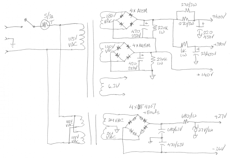

For the sake of completeness, attached is a file showing the power supply schematic for Miz Piggy. It was dictated in part by the unique nature of the power transformer I happened to have lying around - a one-of-a-kind surplus buy. I used a second PC-mount transformer for the bias voltages. All the power supply stuff is on a piece of perf board that is attached to the transformer mounting bolts via spacers. If I had used a less cramped chassis space, things would have been laid out a bit differently. Folks wanting to duplicate this more or less with available iron would need a 540-560 VCT, 200 mA or greater transformer with a 6.3V filament winding with at least 6A capacity. Hammond has one. You would need to use a dropper resistor and a filter cap to power the source follower. A separate small transformer would still be needed for the bias voltages. A 24-0-24V transformer would work - these are readily available.

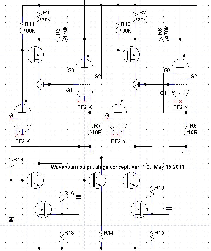

You will need more drive voltage swing from the front end with the local output plate feedback setup, assuming the Mosfet buffer will get a resistor after it to simulate current drive. The Schade scheme does work well at linearizing the tube, better than triode configured, but global N Fdbk will always give the best linear results if it can swallow the gain. (stay stable)
Wavebourn came up with a Schade variation a while back, where the (attenuated) output plate signal was fed back to a source degenerated P type Mosfet hanging from B+, which then acted as a varying plate current load for the input tube. That avoids the need for additional voltage swing from the input stage (no series R after follower), and also references the Schade feedback to B+ (instead of the usual ground), so avoiding (via current feed only to the input) the power supply noise issue in the feedback (which the typical Schade config. has).

Here is Wavebourn's idea and a link. It's a little different than I had remembered it yesterday.
But then I realized last night, that what I had mentioned, had the phasing wrong. One could also put the driver plate directly to the drain of the P-channel Mosfet (and bias the gate down from B+), but then it would need a buffer yet for driving a screen grid.
This type of approach has good PSRR, since only current sources cross between ground reference and B+. Unlike the usual shunt Fdbk resistor (usual Schade scheme).
http://www.diyaudio.com/forums/tubes-valves/205965-unusual-amps-64.html#post2919395
