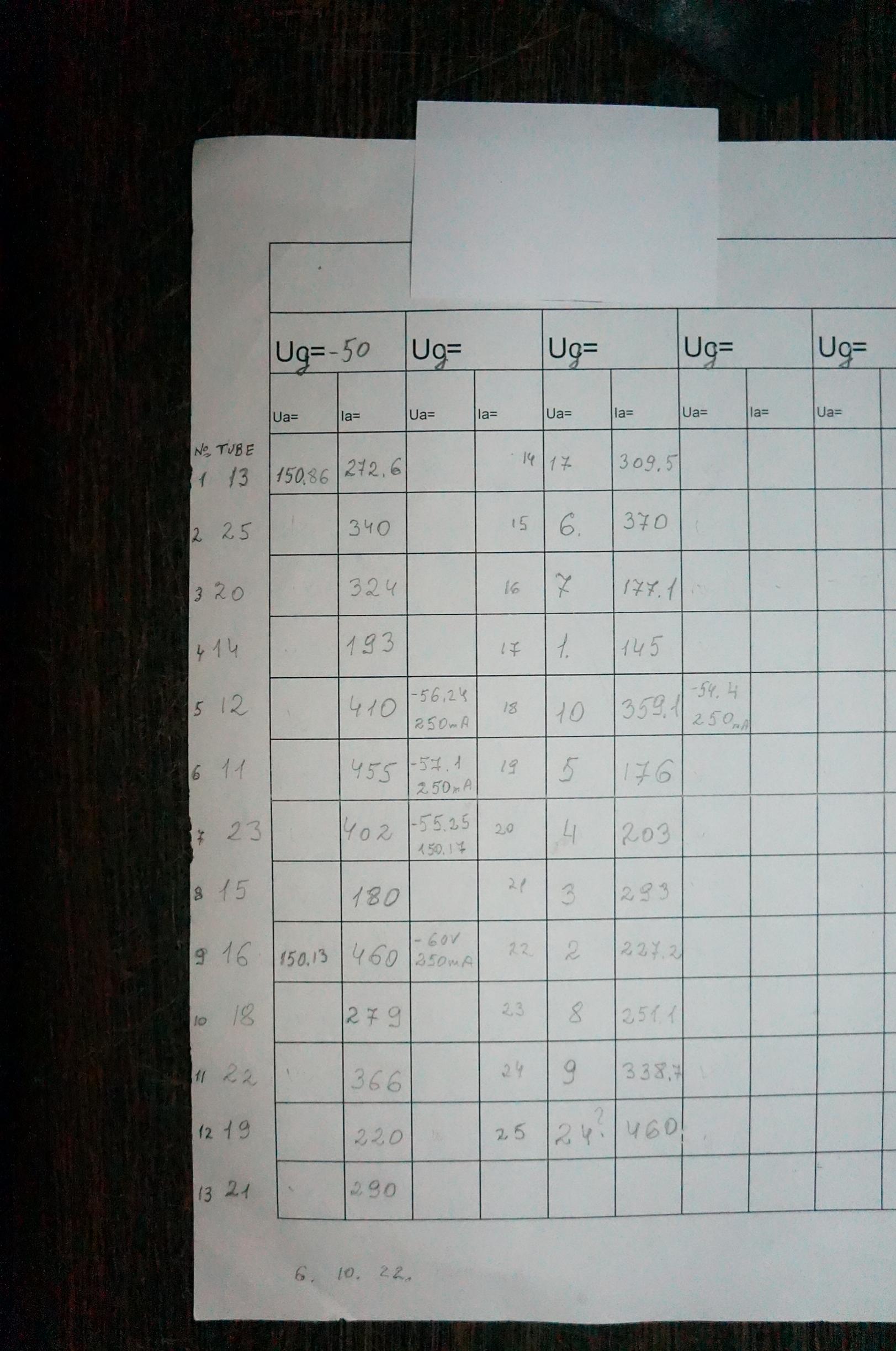

I don't know what 6C33C they do it on. I have 25 new tubes from the Ulyanovsk factory.
One of them is killed!, # 24, the rest cannot be paired:
