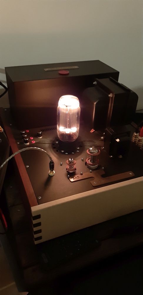

When I ordered they didn't have a web site like this. Back then it was fully custom order with black covers.
See attached picture.

Very interesting looking build you got there 😀
Thanks. It was a build that took about 2.5 years and I'm still upgrading.
I've been running a pair of GM70 amps for over 9 years, 1kV plate voltage, fixed bias, 100mA into 7K, interstage transformer driven by triode connected D3A. I get around 20Wrms output.
I do not ever work on the amplifier with the 1kV B+ enabled. Have never had problems with corona discharge, used HV wire and in some places reinforced with teflon tubing.
Around 12,000 hours of service so far without major problems. I change the tubes roughly every year depending on hours of use. I usually like to change them at about 1200 hours. Current ones have about 1600 hours and are still OK, will replace around the end of December.
