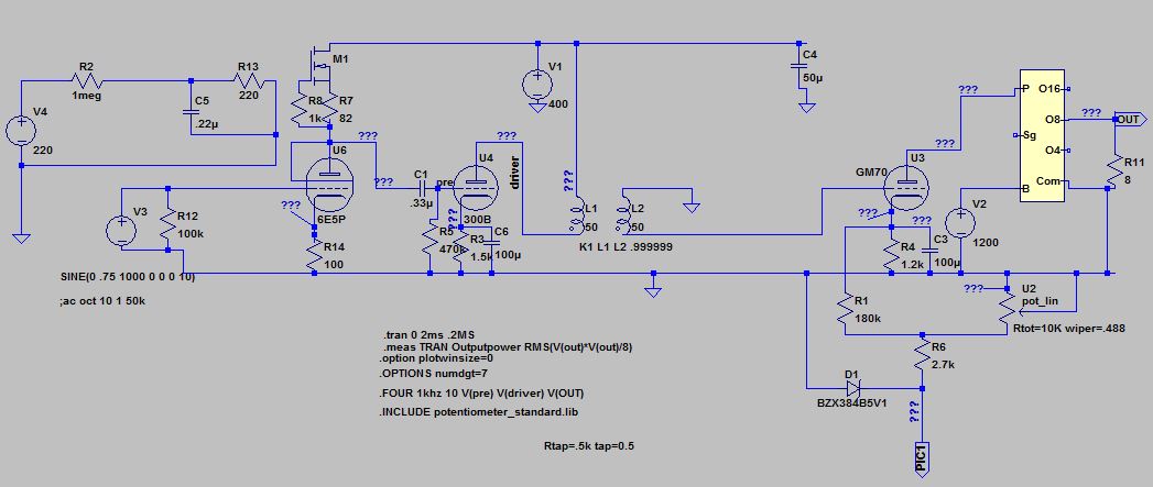

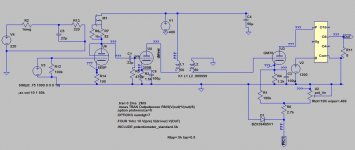

This circuits works really well and drives a pair of ribbon speakers

I've been running a pair of GM70 amps for over 9 years, 1kV plate voltage, fixed bias, 100mA into 7K, interstage transformer driven by triode connected D3A. I get around 20Wrms output.
I do not ever work on the amplifier with the 1kV B+ enabled. Have never had problems with corona discharge, used HV wire and in some places reinforced with teflon tubing.
