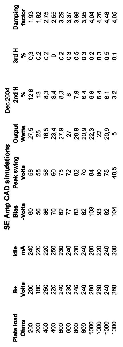

LOAD IMPEDANCE FOR TRIODES
Yes, it is true that after some 6xRp you start to get deminishing returns -- but the point is what the Rp would be for the tube used at the operating point chosen.
I cannot completely agree on your findings with the 300B output valve, or others -- mainly about the issue "significantly less then limits of dissipation". If we are "playing" with a 45W anode diss. triode, it might be possible to obtain better sound at i.e. 30W dissipation. On the other hand, if the triode has 15W dissipation, at 10W diss. you are throwing away too much, because what you started with was not that big.
From my experience, if output power is needed, and a superior sound as well, the "king" is voltage thru the tube. If we choose a higher (even more than 2x the usual 2xRp -- I believe in 2.5xRp to be the usual -- hence i.e. 5xRp) Ra, the result will immediately be lower distortion, especially 2nd harmonic. Further, in order not to loose too much power, we can go up to the maximum allowed voltage thru the tube, while we stay at a lower current, thus at a lower dissipation rating... if tried, or simulated, what I just offered as an idea can easily be proved, or disproved.
Why I think this issue is relevant when we speak/write about 6C33C-B? Well, the usual way to use such a tube (as a matter of fact, all tubes originally intended for voltage regulation, like 6336, 6080, and similia), no matter what the connection between driver and output tube is (original DC approach by Ari P. or "dusty" cap coupled approach) -- is to go for a low Ra, very high current and relatively low voltage in order not to surpass anode dissipation ratings. In all such cases, the results are what Kuei Yang Wang refers to as "sonically much superior DHT's".
Furthermore, those of you in the "101-level EE espertise" (whatever does that mean, since electronic tubes theory and circuits are not being taught at EE faculties and the like -- unless the persons mentioned are 60-80 years old, and I believe they are not) league most probably recall that the 6C33C has a different max. voltage rating in case the dissipation is below, if I recall correctly, 30W -- something like 450V. After this idea/proposal, I hope that even die-hards will acknowledge to the fact that a different approach to 6C33C circuits is possible, and might give better sonic results.
To put this one step further, if we presume the output power of a 300B (if you ask me, overrated by audiophiles in every sense of the word, especially since NOS WE specimens are outrageously expensive, and Chinese tubes are not in the same league) is perceived like 8W, how much more power do we actually need, and for what purposes?! I personally think that approx. 10W is more than enough for most people -- outrageously high for high-efficiency speaker owners, quite enough for "normal-efficiency speaker owners". What speakers (efficiency) are you people using, if you are running after that last "squishable" Watt?! Or, at what levels do you listen to music?
A fact, that I would like to change, is the absolute sonic superiority of DHTs like 300B, even 211, as compared to 6C33C and the like. I've listened to lots of amps that would get in the mentioned cathegories, and the 6C33C was never a winner. And, I believe that such "myths" can be changed -- but not with the usual approach.
Just a few words about 6336 -- well, I recently got hold of a few... while I do not seem to be able to get any 6C33C... of course, I am talking about gifts and findings, not about "going out there and buying". Just as you can buy some 6C33C, I presume it would not be much of a problem to buy some 6336 (since I did not try that one, I cannot say what the prices would be).
Ari P.'s approach to DC coupling is very interesting indeed, not at all dusty -- after being called "audio designer" on that account, I have done some homework on that, since I immediately found the idea more than just interesting.
But, let us assume someone might go for what I suggest, higher voltage-lower current: the problem to face would be how to get much higher drive voltage output from the driver tube, since my approach would mean a much higher relative -Ug on the output tube. Of course, it is feasible -- I've succesfully simulated a similar driver for an amp with 6AS7s, where relative -Ug would be approx. 130V (feasible both with 5687s and E180CC/5965, just to mention a few. The only issue here, if I am allowed to comment, is the fact that the approach to DC coupling needs some additional control or safety circuitry in order to be what I like to call "idiot proof" -- as compared to the more dusty approach.
One question -- why is there so little mention of simulation results and similia when comparing ideas? What some happily advocate as "101-level EE expertise" should include such things to, or am I wrong?

6C33C-B load
Dear Aleksander,
You will find attached a list of alternatives, worked by the SE Amp CAD sofware.
The loads are from 200 to 1K.
For each load I selected two alternatives of B+ and quiescent current, except for the 1k load, where you can find 4.
The last line gives you the parameters if you have a power output of 5 W ( for 10 W you need a swing of 55 V peak and the distortion will be H2=4.7 H3=0.2).
The software I used is an old edition and does not optimize automatically. Anyway, this program proved most of the times to be quite realistic.
Take the results as an indication of what happens with a higher load to the power output, distortion, damping factor.
Sorry, but I do not have anything better.
Ari.
Dear Aleksander,
Ari.

DIFFERENT APPROACH
Ari,
Thank you very much for your time and effort -- still, not what I had in mind. I was not thinking about 1k loads instead of i.e. 600 ohm loads, which all seem very usual and conventional to me.
Actually, I was thinking about 3k and even 5k loads, lower currents, <30W dissipation, etc. Something completely different.
I am attaching a little illustration (from SE CAD) just to show what I had in mind. By reviewing it, you will most probably find the distortion outrageously high (2nd order), but do not consider it as a project, just as an idea. I do not worry that much about 2nd order distortion, because among various solutions, it will be relatively easy to have the driver generate 2nd order distortions (among other reasons due to the high voltage swing needed). The 2nd order distortions will in some measure cancel.
No matter how odd such a proposal (just a guideline) this might seem, I think this approach should be given some attention -- at least, by those who would want to see 6C33C amps sounding different than they usually do (meaning that as I previously said, I still have to hear a 6C33C amp sounding overall "better" than DHT and similia).
A comment about SE CAD -- yes, the results are quite similar to what you will get in practice: but for 6C33C it is supposed you will use both halves of this double triode in parallel... which is not strictly necessary, especially since you can avoid heating both heaters (that might be a further discussion topic).
Aleksandar
Ari,
Aleksandar
