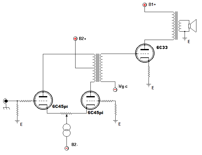

Dear Aleksander,
I understand you are looking for a different sound, but I am
afraid you will be putting a very large voltage to the grid, too large I suppose.
This is just an opinion, but I happened to examine a broken 6C33 and noticed that the distance between cathode and grid is really very, very small and your simulation shows - 372 V peak.
Honestly, I wouldn't try that, but if you decided to go on with your
project, let me know, I am interested.
Thanks.
Ari

Sorry Alex for polluting the air even more but this schematic I found, looks promising for tube newbies like me. No SRPP or cathode follower stage, distortion cancellation (ala Borberly) and little bit of negative feedback, to make the complex loudspeakers more happy.
argo
Alex Kitic said:
Regards to all... no fresh air on this thread, as far as I can feel. No new ideas or anything... we are back to the admiration part, mostly because none of us has a metal workshop at hand
Aleksandar
http://www.tubescreen.com/diy/se_6s33s/6s33s_se.htm argo
hi!
Try this one.
Hope it helps!
Try this one.
Hope it helps!
