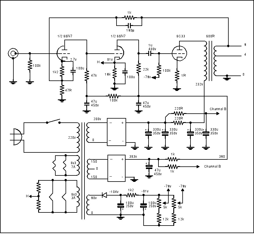

hi,
this circuit was I got from japan, I did it already. reallu sound good & easy to funish.
it running at 200V 200ma.
At first I prepare to use two tubes in one channel, but when I try to match the 6c33. Its not easy to match. So at last I tried this circuit.

Dear Hans,
You are right to say that one must not push the tubes to their limits. However, this is how I use them.
The 6C33 seem to be sturdy valves. The advantage is that I get
15-16 Watts ( 11 V RMS on 8 ohms ) with one tube.
Maybe I am less concerned because I have two dozen of 6C33 that I bought at good prices.
And maybe one of these days the valves I am using will give up.
Regarding the pilot section, I must add that I used ( again ) just one 6SN7GT to drive three 6C33s in parallel, to get 50 W ( 20 V RMS on 8 ohms ) of power. You can find the article, schematics a

The advantage is that I get 15-16 Watts ( 11 V RMS on 8 ohms ) with one tube.
This seems low, I got 13W RMS, (measured) with one tube at 220V and 200mA, I also have seen people mentioning up to 20W when running the tube at max dissipation. I use a 12BH7 CF direct coupled to drive the tube but as you say a 6SN7 should be enough if the tube is not driven to grid current as the input capacitance of the tube is not that high.
Regards Hans
Dear Hans,
Of course you can get more than 15-16 watts, by optimizing the circuit, as you did. Good result .
What kind of OPT did you use ?
Ari.

Tango XE-20-600S
Note, 13W is without driving the grid positive, I have never tried to drive it positive but it should be possible to get slightly more power then. I am very surprised that you don´t get more then 13W while dissipating 60W, what primary impedance do yo use?
Regards Hans
Hans,
I get 15-16 W .
I use 600 ohms impedance ( Ratio about 8.5 ).
The OPT you are using is suitable.
You can use it, if you decide to build something like the Simplex, with very good sonic results,
Ari.
I get 15-16 W .
Ari.
