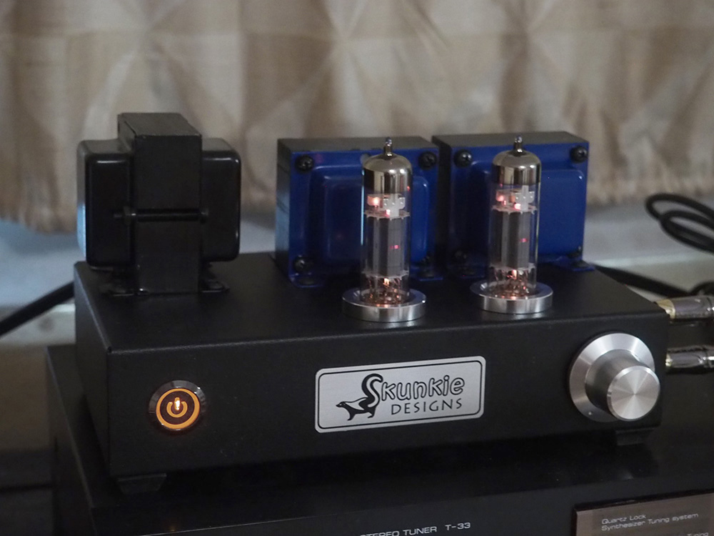

Finished project
Here is what the finished amp looks like with my logo on it 🙂
Smelly mascot - got a few of those in my neighborhood, though they are the ratty-looking Cali variety instead of the larger and fluffier East Coast types... Nice amp, too. I have Klipsch speakers in my living room - wonder how loud a noise the little amp would make with them.

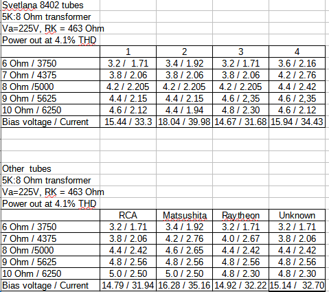

Out of curiosity I dug out my 6BM8s and bread-boarded the amp.
I used an Edcor GXSE 10-8-5K transformer with a 4 Ohm resistor in series with a 6 ohm pot for a load and measured power out vs load impedance by varying the 6 ohm pot. I set the amplitude into the load at the beginning of clipping and used 4% THD as my set-point using Audiotester 3d to measure distortion.
RL=4 R Rp = 2500R Pmax = 1.09W
RL=5 R Rp = 3125R Pmax = 2.048W
RL=6 R Rp = 3750R Pmax = 2.16W
RL=7 R Rp = 4375R Pmax = 2.52W
RL=8 R Rp = 5000R Pmax = 2.65W
RL=9 R Rp = 5625R Pmax = 2.56W
RL=10R Rp = 6250R Pmax = 2.3W
Based on these measurements I believe the 5K transformer is indeed a good choice for this amp.
Ok, here is data for four Svetlana tubes along with four from various sources.
The same trend shows. The 6BM8 with 40% feedback to the screen has it's impedance lowered to the point that a 5K OPT is better suited than a 7K opt (which is recommended for Pentode mode) for the operating point of the amp as posted by the OP.

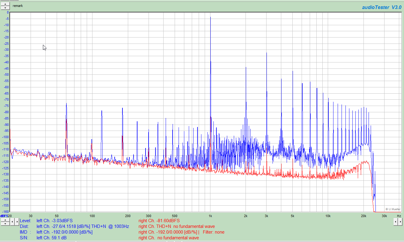

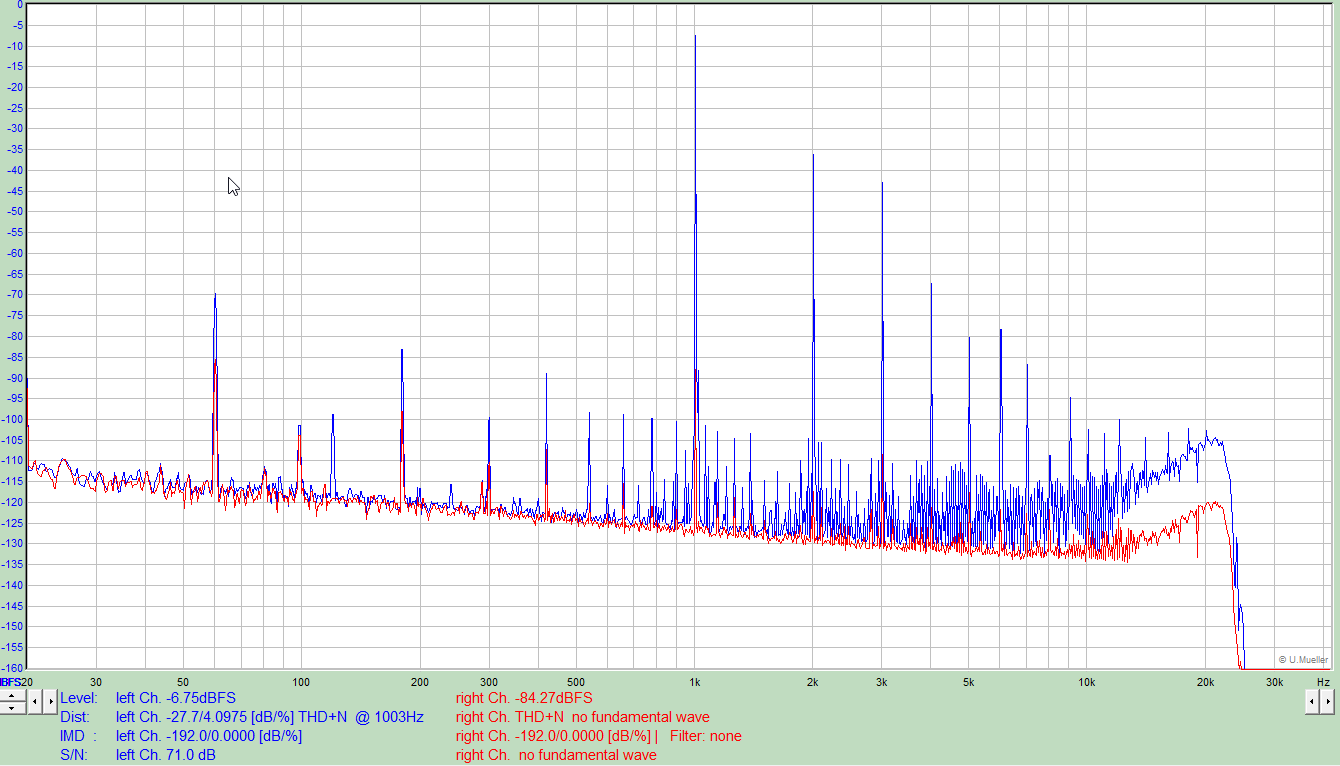

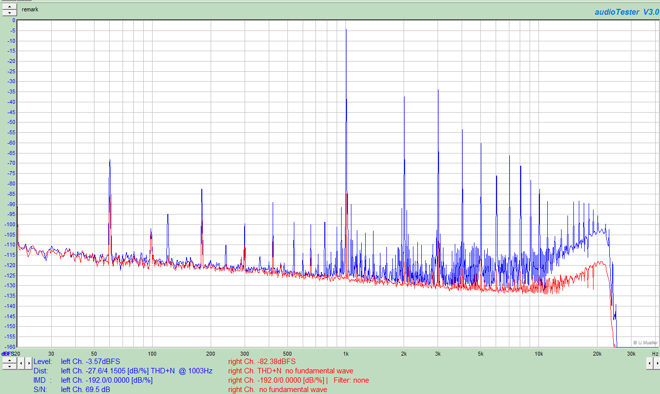

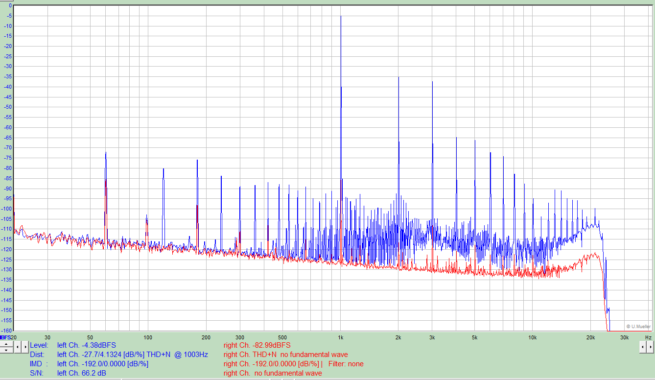

Another observation. There is a distinct difference in the distortion profile and S/N ratio depending on whether the input Triode or output Pentode or both are cathode bypassed.
1 is Pentode bypassed, triode not
2 is Pentode not bypassed, Triode bypassed
3 is both bypassed.
4 no bypass for either
PRR, the voltage is 225V, tube currents are listed in mA in my previous table.

The diodes will act similar to a bypassed cathode resistor in that they will result in slightly higher gain, with slightly higher distortion since there is no or little cathode feedback as there is in an un-bypassed cathode resistor.
If you compare the graphs you will see that #2 (and to some extent #4) without bypass on either cathode has the lowest IM distortion and greatest signal to noise ratio. It also results in the lowest gain of the amp, and requires slightly more drive.
Another thing to note is the distribution of harmonics. In some configurations the odd harmonics are greater than the preceding even harmonic. I find this to be harsh when it is great enough. I believe that monotonically decreasing harmonics sound better.
Whether or not this is important can only be discerned by listening tests.
