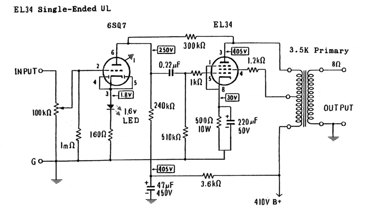

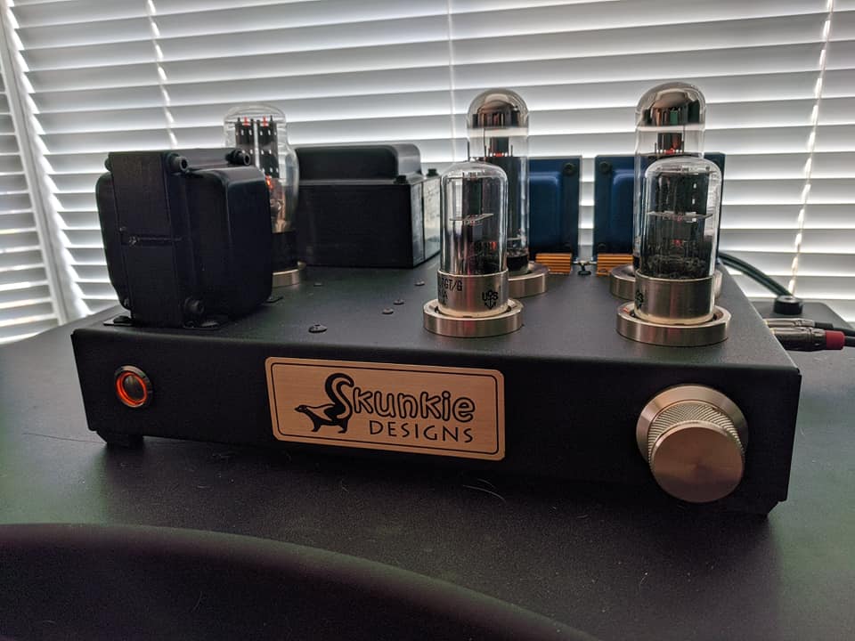

Anyway, here is the schematic for my previous build that sounds unbelievably good to me. Then again, I'm sure there will be someone here who will want to explain how this one can't work either.

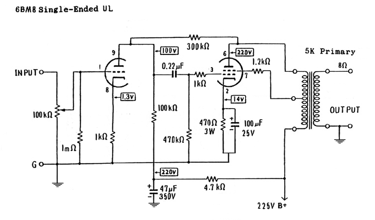

With regards to 5K vs 7K transformer, I would like to point out that a 7K transformer would be correct for a Pentode amplifier, and this value is called out in the Svetlana datasheet.
However, this is not a Pentode amplifier, it is a UL amplifier using a Pentode tube. With the typical 43% UL tap a 5K transformer isn't far off from ideal.

The 6BM8 pentode's dissipation rating is 7 watts. As a common rule of thumb, the load impedance's optimum is plate voltage ^2/plate dissipation, hence 240²/7 = 8.2 kohms.

I checked these examples and found it off somewhat, if I applied it correctly:
1. 300b SE
WE specified 7 watts output at 350V anode, -78V bias with transformer load (Za-a) of 4k
Your rule suggests Za-a of 2.1k
2. Dynaco ST70 EL34 PP, UL with Za-a=4.3k
Your rule suggests 5.7k
3. Williamson KT66, Triode, PP 450V anode, -38V bias, with Za-a=10k (as originally specified).
Your rule suggests 6.8k

I recommend to not compare apples with oranges. We're talking about SE pentode mode here, not triode nor PP!

Both examples you mentioned in your last posting are exactly the ones that grossly exceed the pentode's plate dissipation rating at 10 and 9.2 watts, respectively. I'd really not recommend that in SE and other class A designs.
A plate load impedance of about 5 kohms fits well for 6AQ5's and 6BQ5's, running in SE at 250 V plate voltage and 48 mA plate current, hence a plate dissipation of 12 watts.

Anyway I dare to insist that plate load of 5 kohms isn't proper if the 6BM8 7 watts pentode is running at a plate voltage of about 250 V.

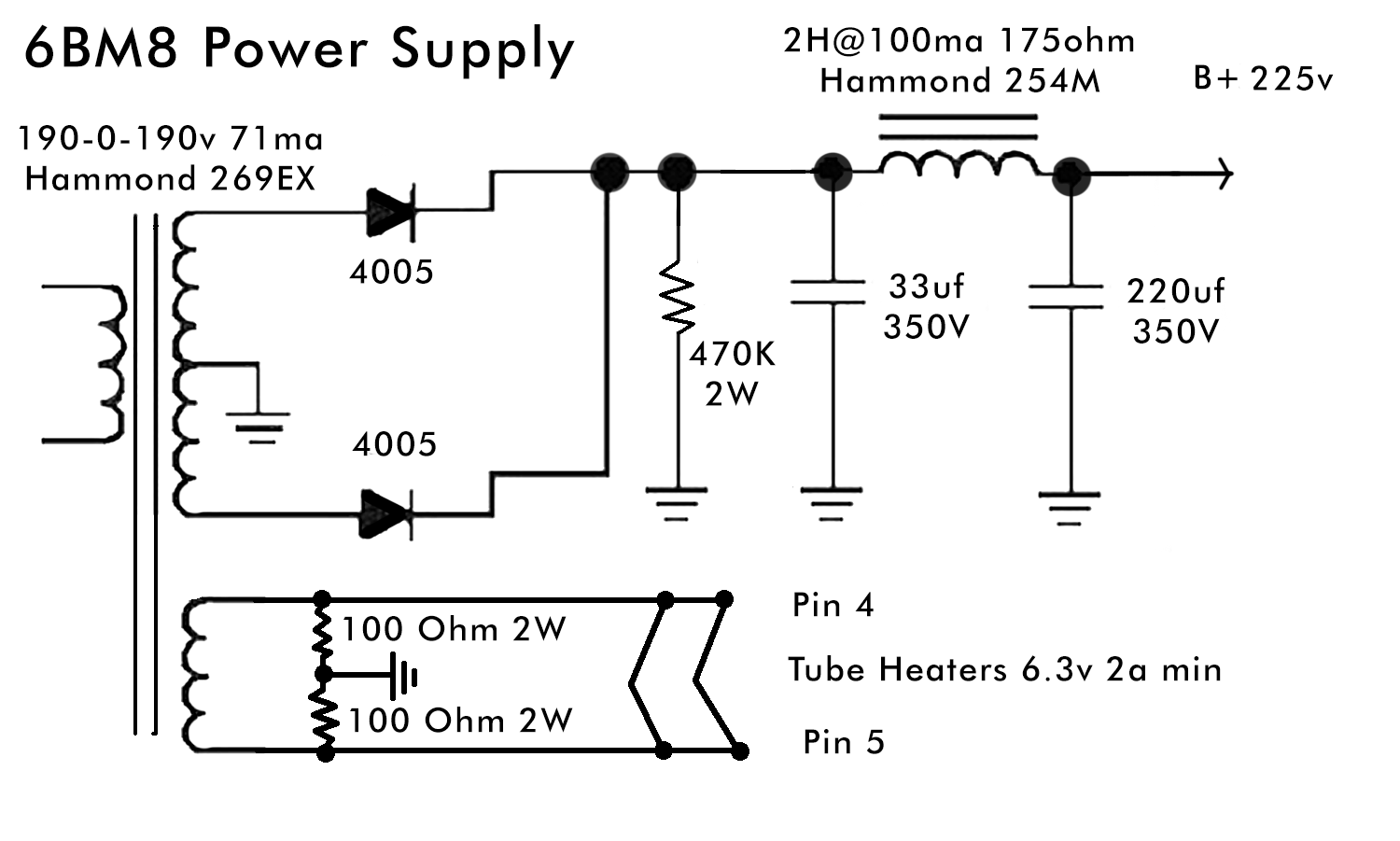

I've got this amp running and it sounds good. I simplified the triode cathode arrangement to an unbypassed resistor, but plan to play with other options, as well as the Schade feedback value by ear. It looks good on the scope, a nice clean square wave and doesn't show clipping until right at full volume.
I did realize the schematic I drew up had the pins numbered wrong! The B+ came out a little lower than I thought it might be, but at ~200V across the output section, it should be fine. I also cooled off the bias a bit to respect the transformer rating and not stress the tubes, this isn't being built as a powerhouse. The output section should be at aprox 80% now.
Francois G: Kay could have been more explicit: the rule of thumb is for SE pentode mode, and doubled for class A P-P. Class AB will be lower. Triodes can be used over a wider impedance range; 3 times the plate resistance is frequently used.
