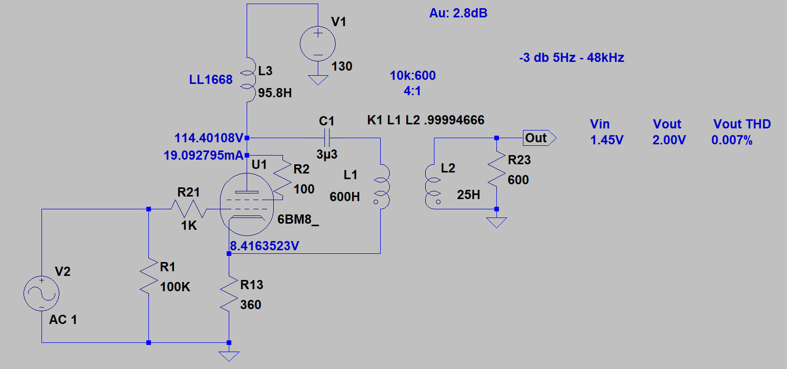

Many thanks. Do you think a good, conventional output transformer would have better data compared with a good anode choke when it comes to bandwith and resonance peaking?
Hands down. A choke has to deal with DC, whereas differential transformer doesn't, in a big picture of things. Theoretically, you can make a better choke by using a very highly sectioned winding and avoiding turn-to-turn arrangement, but you will have to wind it yourself.

OK, Now we have a number, not a relative but unmeasured value.
What I always did before I used a choke as a constant current source, is measure the impedance from 20Hz to 20kHz.
That told me if there were loss issues, and if there were distributed capacitance issues that would prevent the choke from being a good fit for the application I used it for.
Of course, the DC current and low frequency was a separate issue. Inductance at 120Hz and a DC current level, is far different for the same current level at 20Hz. Very conservative current levels applied, versus the rated current level, makes for good low frequency performance with DC current applied.
My Lundahl chokes are build the same way as their output transformers are mostly build. For some types they use kraft paper between winding rows, but for others they have some sort of foils between the layers, so I don't think that their chokes have narrower bandwith compared to their signal transformers.
Anyway, I've spotted cheaper chokes in gear, in this case it would be an anode choke for an ECL82 and it looks much cheaper compared to the Lundahl ones. And still its working sufficiently.
One solution for HF problems of a plate choke is adding a second series choke of lesser inductance, but designed specifically for high frequency. An example could be a choke with sectioned winding, wound on gapped ferrite or amorphous core with silk-clad wire.
I have LL1668 choke (100H), measured it with DER EE DE-5000 LCR meter:
95.8H; DCR:668; RP: 576k; Cp: 42.6pF
It's enough good for anode choke.

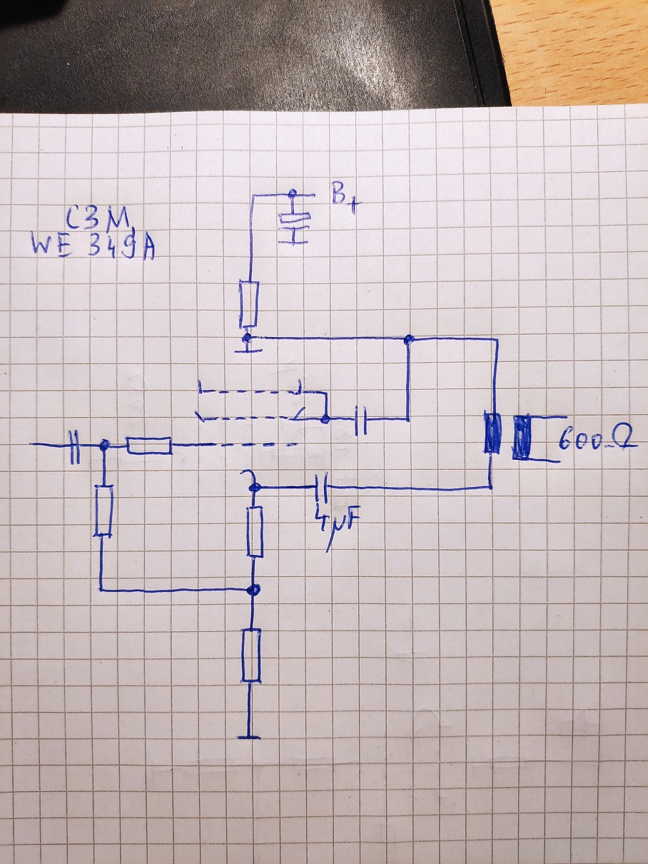

P. S. Still don't have a clue why someone mix a cathode follower with an anode load resistor. Its no phase splitter, nor makes use of the cathode followers low impedance output. But it must be something very special, the amps were talking about cost a fortune.
Someone got an idea? Whats the big advantage here?

Euro21,
does this phase-splitter/cathode follower make any sense with your simulation programm?
Is it usable for a single ended wired S217D output? Lets assume B+= 250V, Ia=10mA.
Many thanks in advance!
