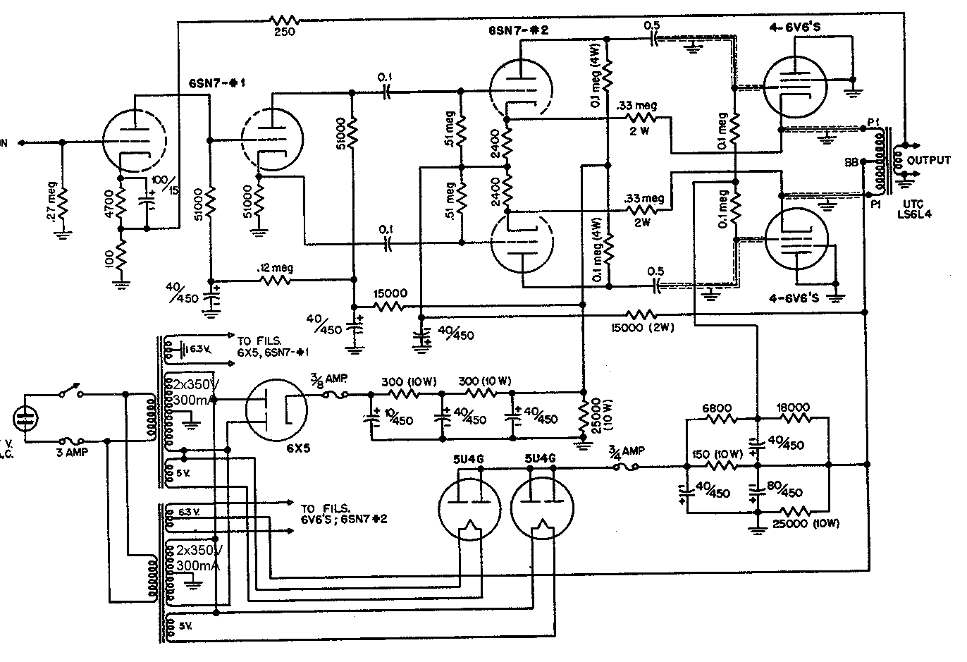

Actually this will be a pair of mono-blocks.
If you're trying to economize, why not go with a single chassis amp?
I like the schem you showed earlier, but was put off by the filter chokes.
You could build it without the chokes, but they're there for a reason. Personally, I'd use one in a CLC config., but your PS trans should be no more the 300vAC, otherwise you're going to end up with way too much B+.
And it doesn't look complex, compared to a couple other designs I've built it actually looked fairly simple.
As Kevin points out, the Williamson has issues, and could result in an exercise in frustration. 6V6's are easy to drive with a concertina, and you can get away with cheaper OPT's.
What circuit were the other amps you built based on?
Good point, Vanity, I've always wanted a mono-block pair and there seems to be some advantages I'm curious to explore.
My power xfrmr is 350vAC

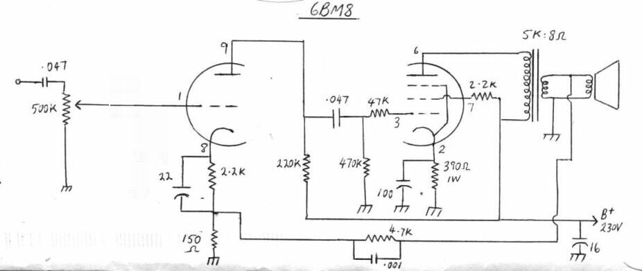

The first amp I built was the little 6BM8 SE, 3watt stereo below

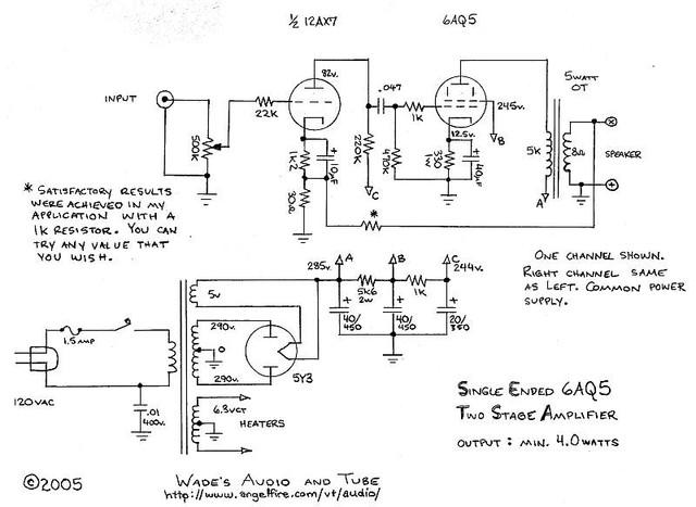

And then the 6AQ5 SE below

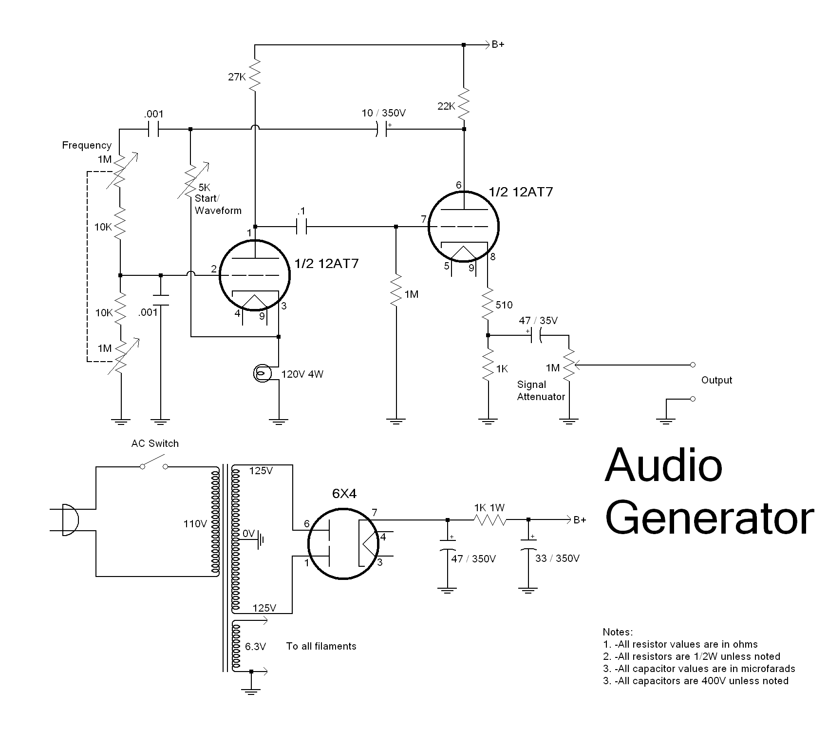

Also just finished the 12AT7 audio generator

Yes, it usually involves space for more iron, hence a better power supply for each amp.
That's really 6L6 territory.
Which one sounds better?

I liked the 6BM8 3-watt (which I just realized I posted the wrong schem, correct one below). I'm no audiophile and I've been doing living sound engineering for so long my hearing probably wouldn't pickup most of the anomalies talked about on this forum. But both amps seemed to be thin, lacking in low end 200hz and below maybe. And just not very loud. I listen to rock n roll and so a little volume is desirable.

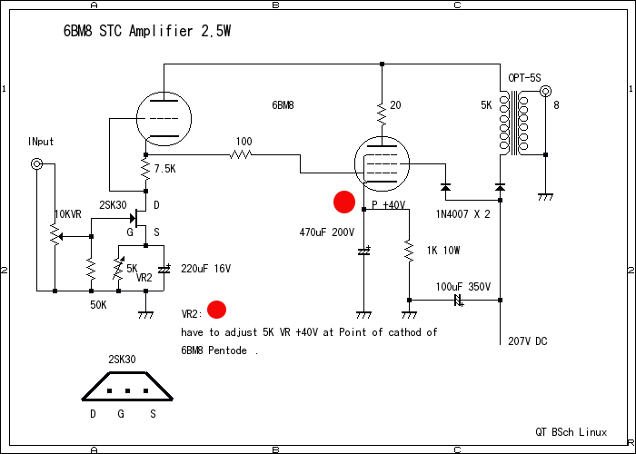

Why don't you just stick with your original idea ? Buy 2 7-pin sockets that fit into a 9-pin sockethole and you are done. If you don't like the result change it into something else. In the mean time try this design to change your 6BM8 amp. I tried it and it sounds really good.

@Jaap: I've decided to save my stock of 6AU6 tubes for another build. I really want to find a design using 6SN7's and 6V6's. Thanks for the the upgrade, I think that's just what I need cause I really want to get to work on something.

You can exchange the 12au7 for the 6SN7 without any problem, at least that is what I am going to do in the near future (with CCS and led on first tube). I prefer local feedback in all cases to global feedback, that is one reason why I want to try this design.
In a RCA handbook I saw that you can also scale this design up with parallel 6V6 in het outputstage and get 20 Watts from it.

Are you talking about the schematic below?
With the CCS, are you going to use the LED's voltage drop to derive the constant voltage for the CCS? What about using an LM317 regulator.
I posted a schema for what was identified as a Williamson type design with 2-6sl7 and 2-6v6. But I was informed it was not a good choice. So I'm still looking
Just use the 6SN7 where you had 12au7 in your original RCA-design. Take other component values, for instance from post 56. If it works you can try to use a (v)ccs on top of the first tube and a led for the cathode resistor. You can find a lot of info on this forum.
I like that idea. Sorta build of an old design and experiment with it.
That is what I think. You could also make the 6V6 outputstage differential by putting a LM317 under it.
