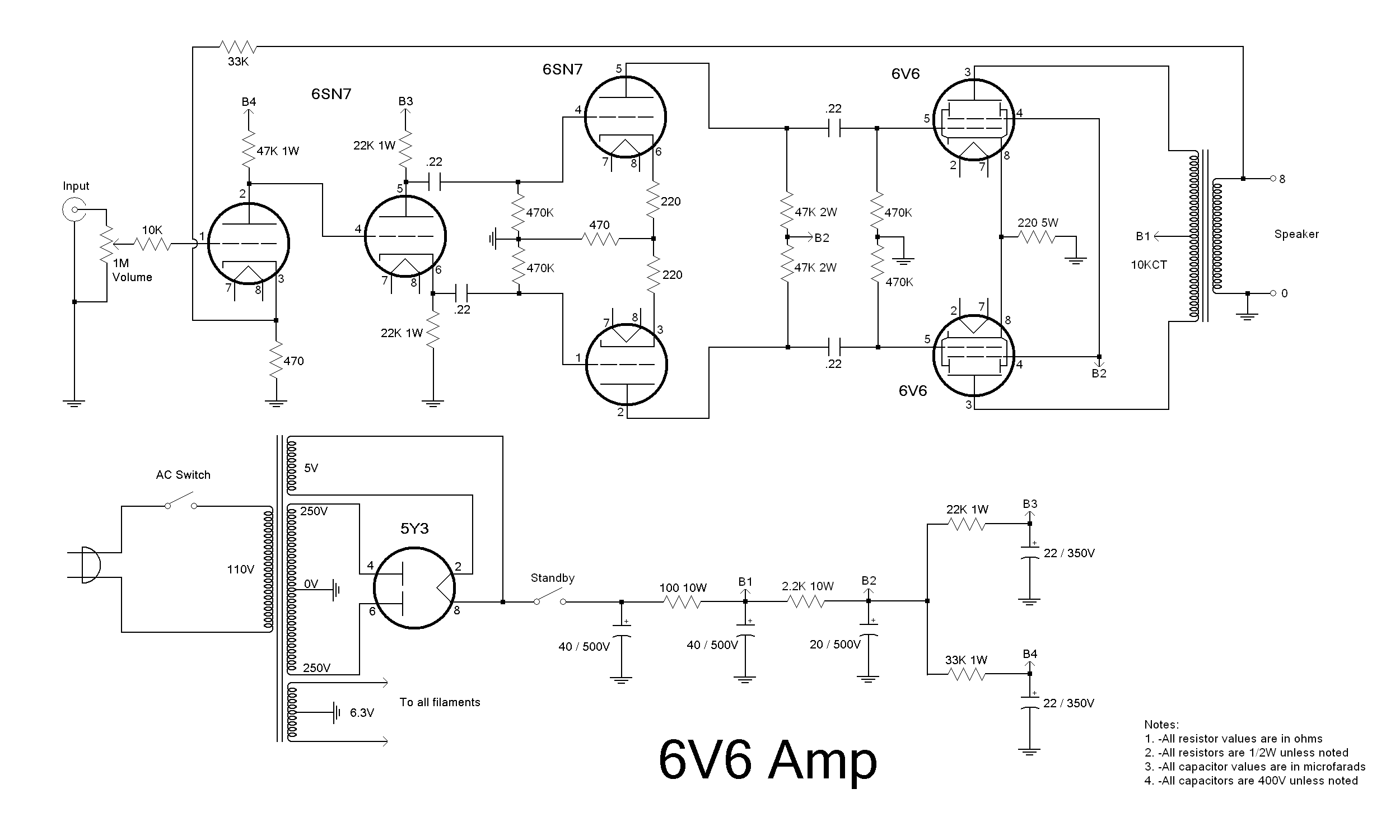

I've decided to go with this design. Any suggestions on improvements?
![IMGDEAD]](https://www.diyaudio.com/forums/[IMGDEAD]http://i263.photobucket.com/albums/ii151/cameramanlink/6V6StereoAmp-1.gif[/IMGDEAD])
Yea I can't seem to figure out if I can post an image that's on my computer, or does it have to be a URL.
This is essentially the Williamson circuit which has way more gain than required for use with the 6V6 even with pretty significant levels of global feedback applied. It also frequently exhibits LF instability that is almost impossible to eliminate if you do not have profound understanding of loop stability criteria and the equipment required to measure the open loop phase shift and gain.. (Think Bode plot here)
A variation of the Mullard 5-20 circuit with a high mu triode like the 6SL7 in the front end might be a better (sounding) choice. Gain while still high may be made more in keeping with modern sources like CD players and DACs..
Thanks kevinkr. I never thought it would be so difficult choosing a good design using the tubes I have available. I'll check out the Mullard 5-20.
Why?
Needlessly complex with a mediocre power supply. You're building a "mono" amp right, not a pair of mono-blocks for stereo? I like the schem. I posted earlier way better, I'd just change the PS a little.
jeff
vinylkid, Actually this will be a pair of mono-blocks. I could tell the ps was weak and was looking into beefier alternatives. I like the schem you showed earlier, but was put off by the filter chokes. I'm trying to build this with parts on hand. Kind of a garage junk build with a sound of gold 😱. And it doesn't look complex, compared to a couple other designs I've built it actually looked fairly simple.
