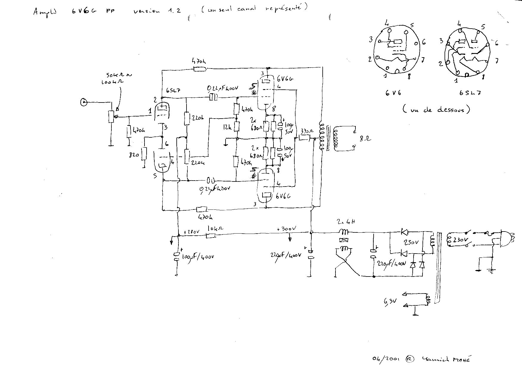

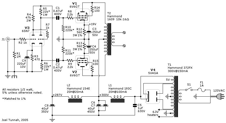

Can anyone suggest a simple, quality 6V6 push pull amp design/schematic. At this point it looks like I'm gonna have to back track anyway. I'm looking at schematics using 6SN7. Any suggestions?
Here's a schem. I had sitting on my HD. The 6V6's are strapped as triodes, but you could change that.

thanks everyone for your suggestions. Vinylkid, I think that scem is the one i'm gonna use. I wanted one using the 6SN7. Thanks, I'll post how it's coming along.
