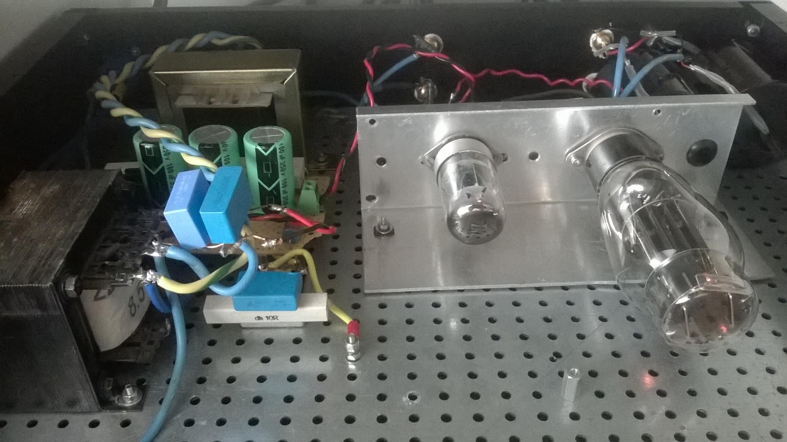

Attached one pic just for fun. Works like a charm without hum.

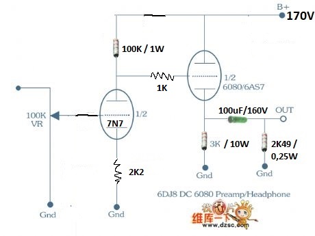

It's OK each 7N7 only draws 1.33mA, I measured 133 volts across 100K plate load resistor?
What cap value to bypass the cathode resistor of 7N7, or better how to calculate?
It's OK?
On line bypass capacitor calculator gives me min. 13uF for 2K2 of cathode resistors with a corner frecuency of 60Hz, it's OK?

You can check the datasheet for the 6SN7 for reccomended anode grid leak and cathode resistances. @ 150V B+ The anode will then hopefully bias up at +80V with respect to ground. Then you can choose whether to have the tube directly coupled to the 6080 or to include a RC bias circuit.
Edit i just checked for you, 2K2 cathode resistor, 100K anode resistor, 100K grid leak (Or the direct coupled pot like you show in your drawing. Gain will be about 24-28. You can and should bypass the cathode resistor

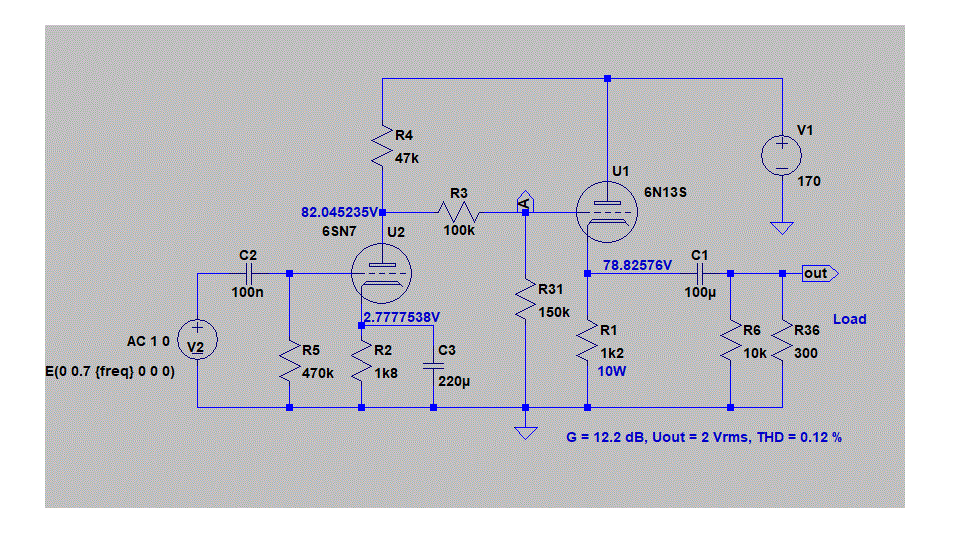

The 6AS7= 6080 needs quite a bit of negative grid voltage. the divider biases the tube up differently.
This way you can dc couple both tubes and stay within a reasonable op for the 6sn7..i do not understand the reason behind r3,r31
