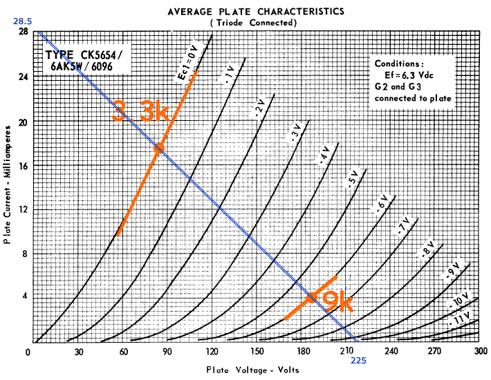

Linearity arrives from a constant ΔE/ΔI quotient in all operating voltages of the grid. When you look at the anode curves you can draw a line, representing the load of your tube. Questions: What load is represented by the blue line, and, Can you find a better load where the ΔE/ΔI quotient is optimal [IE equal within all working voltages of the grid]?
Small anode resistor means extra distortion. This is because for a large anode resistor you are using the fact that mu is fairly constant (which it usually is), but a small anode resistor requires transconductance to be constant (which it usually is not). However, with such a simple circuit a small anode resistor means that the output impedance is not as high as it otherwise would be.
I'm not very technically astute but the load looks like it would be about 7.9k. (225 / .0285 = 7895) But I don't know how to measure or figure out the the rest.
