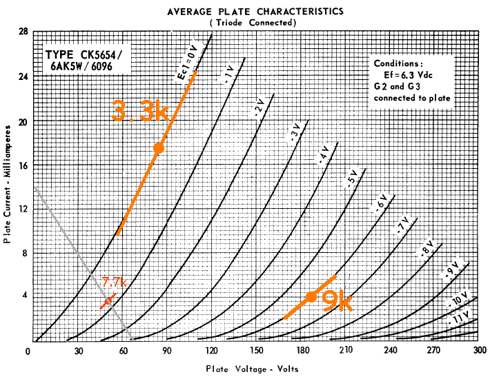

So I got the essentially "stock" audio portion breadboarded and got some measurements. The tubes I was able to scrounge up are NOS but not the same brand, one RCA, one Sylvania.
The voltages below are an average of the two channels. Plate resistor is 4.7k and cathode resistor is 200 ohms as per the schematic.
With a B+ of 68v from my bench supply:
Plate to ground: 51.4 v
Plate to cathode: 50.65 v
Cathode to ground: 0.715 v

Plots plop-on the 6AK5 curves. rp is around 7.7k. Gain is 15 or 20. Zout near 3k.
This occurs when an input signal overloads the grid and causes grid current to flow.
With Vg=-0,7V you don't need very much signal.
The grid current charges up a dc bias on the grid coupling capacitor. This has the effect of moving the operating point and of clamping the positive part of the input.Producing additional (intended ?) distortion.

He is referring to the intrinsic diode within the tube. If the grid becomes positive relevant to the cathode, electrons can flow from the cathode to the grid so it acts like a diode.
Ahhh. Thanks for the explanation. Yeah, the operating point used in this circuit is certainly not optimal.
