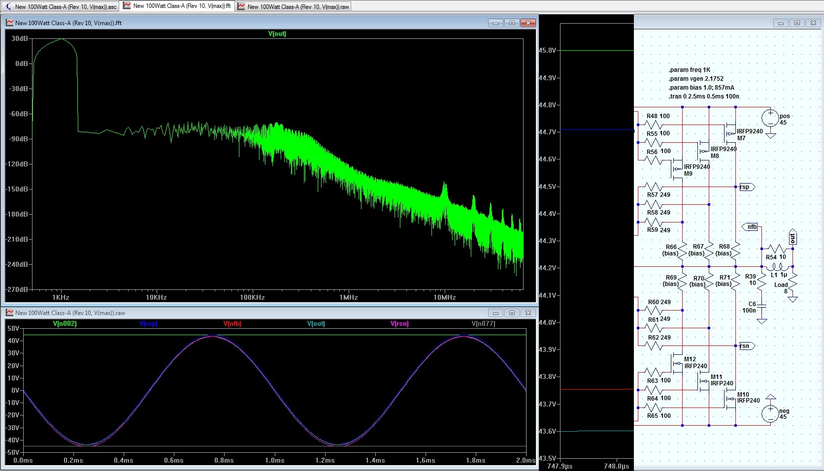

It took some doing, but it has been done, the ‘New class A’ is now running with 6 pairs of IRFP 9240/240’s, the bias current is set to 5.14Amp (857mA per device) good for 105Watt class A. power dissipation in each device is about 39Watt. Later I will show the new performance graphics, but first some absolute maximum values.
The graphics shows the amplifier running at absolute maximum output (there is some distortion showing up due to clipping in the driver stage). V(max) and V(min) on the output connector V(out) are at 43.61Volt (97% of the rail).
At V(pos) +45Volt, V(gen) 2.1752, R(load) 8Ohm
V(rsp) = 44.71Volt
V(nfb) = 43.76Volt
V(out) = 43.61Volt

output bias set to 5.14A total.
How do you dissipate 460W (45V * 5.14A * 2) from your sinks?
5.14A bias gives 10.28Apk ClassA output.
105W of ClassA into 8r0 only needs 5.12Apk
210W of ClassA into 4r0 needs 10.25Apk and that is available from your 5.14A bias setting.
The amplifier will not deliver more than the 5.14Amps until it goes into AB witch it will not (42Volt(peak)/8Ohm(load)=5.14Amps).
This is what I am thinking about (see the LA14-300 or LA15-300).
http://www.fischerelektronik.de/fischer/uploadfischerfcool/Fischer/D03_D.pdf
I'm sure they will be pricy
You don't think 5.14A quiescent current of a push-pull amp does +100W Class A continuous output power in 2 Ohm ?
But it will do in 8Ohm 🙂 (5.14*.707)*(5.14*.707)*8 = 105.34Watt(rms).
The simulation shows that the amp will deliver 10+Amps in 4Ohm and I did not test with lower loads, but I am sure (if the power supply will) it will, the Rds value is very low. But then it will be in class AB.
