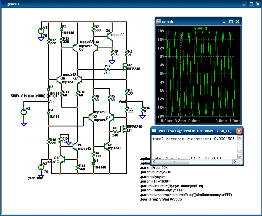

First of all, let me add the original (1982/83 or there about) schema (do not try to build this, it is rubbish 🙂) but the principle works.
Looks VERY familiar (below) Diodes 3/4 are there for biasing. Stealth was 1983 as well ,wonder who stole who's idea ?? It does work .. The full amp was 200/400/800W with 4 of the below "modules" in parallel. It sounded "nice" but I can easily match it with class AB's. 🙄
OS
OS
Yes very alike, there is one (there are more 🙂) difference the genesis will not go rail to rail and the performance at 20Volt of the one I'm talking about is way better.

Makes you wonder, same age (around 1983...) but I am (almost) sure they did not (as I did not) publish that.
P.s. I'm sure that one is running class AB at +/- 75Volt class A will not be possible with these devices.

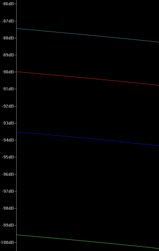

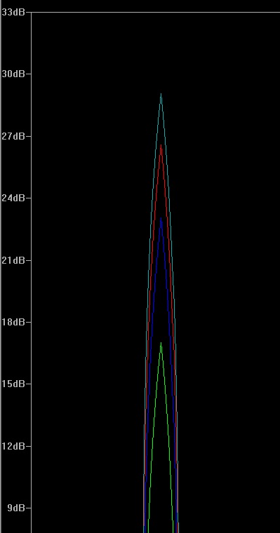

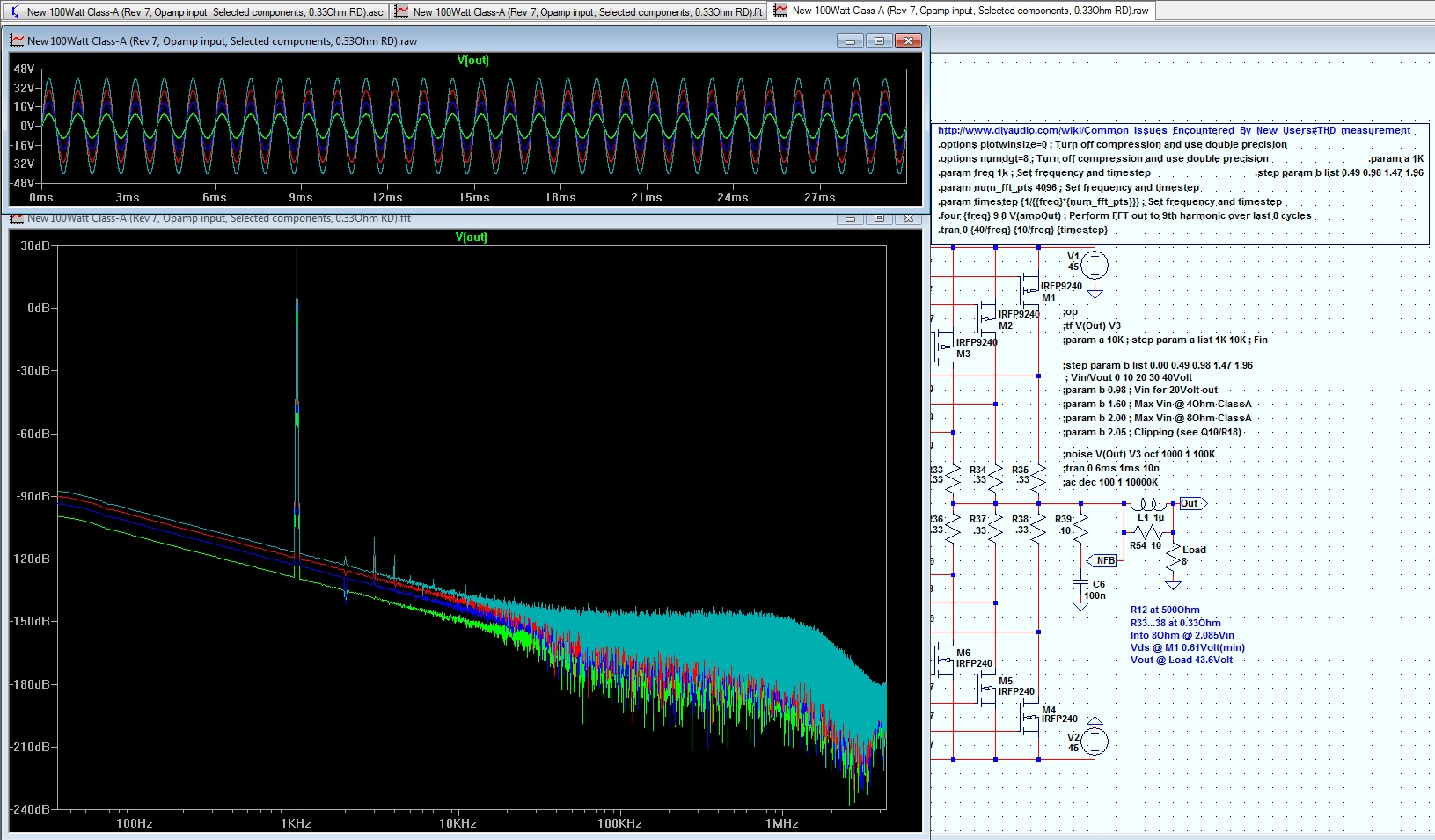

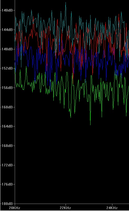

The picture shows the 10, 20, 30 and 40Volt THD graphs for a 8Ohm load
Green 10Volt 117dB to (+/-)170dB @ 20Khz
Blue 20Volt 117db to (+/-)170dB @ 20Khz
Red 30Volt 117dB to (+/-)167dB @ 20Khz
Azure 40Volt 117dB to (+/-)168dB @ 20Khz
In addition to the graphics, enlargements of the end points.
New 100Watt ClassA @ 1 Khz into 8Ohm 10,20,30 and 40Volt THD graph left side.JPG30 KB · Views: 408
New 100Watt ClassA @ 1 Khz into 8Ohm 10,20,30 and 40Volt THD graph top side.JPG26.5 KB · Views: 383
New 100Watt ClassA @ 1 Khz into 8Ohm 10,20,30 and 40Volt THD graph right side.JPG98 KB · Views: 375

Thanks, I did find this thread http://www.diyaudio.com/forums/tubes-valves/105496-how-make-sense-ltspice-fft-analysis.html and will read it completely. You may see my graphs improve 🙂
Hi FdW,
Unless you want to takle this all by yourself, it is fine and we wait on your results, but many of us use simulators. That is one aspect of the equation. Simulators are just that simulators, it asumes perfect conditions, pure capacitors and resistors, things are perfectly matched. In other words the perfect world.
Keep this in mind before getting to extatic about the numbers presented in the FFT.
Have fun I am keen to see what comes out of this.
Nico
Nico
