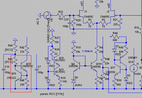

I have complete amplifier circuit diagram, I'm doing to try and test measurements.
I have given up the high distortion first stage JFET amp. Please measure the distortion of the first stage. You might want to connect the zener of the BJT cascode to JFET sources. To lower the distortion from the JFET, you need to bias it very high (14mA is top). If you can do it, this will get my vote and I will build the amp, no matter the simulated performance as long as reasonable as an amp. If not (not low distortion at JFET stage), it will be just another Goldmund clone.

If you can make the distortion low with 1mA, that's better. The point is the distortion not current. It just happens that JFETs like high current.

Just measure THD at the output of the first stage (i.e. between Q2 and R6), or between JFET and Q2, you will be surprised. Running higher current is the best way to lower the distortion.
If I'm not mistaken, the latest versions of Goldmund have higher current. (ADD: 2mA in Mimesis3, 4.5mA in Metis3. But it doesn't mean that Metis is better)

But focus on distortion because higher current doesn't mean lower distortion. I usually check every transistors' parameters to put each transistor at their best operating condition. I can get 1% with 3.5mA (half of it for each JFET).

I will try to 4mA for a JFET, and measured

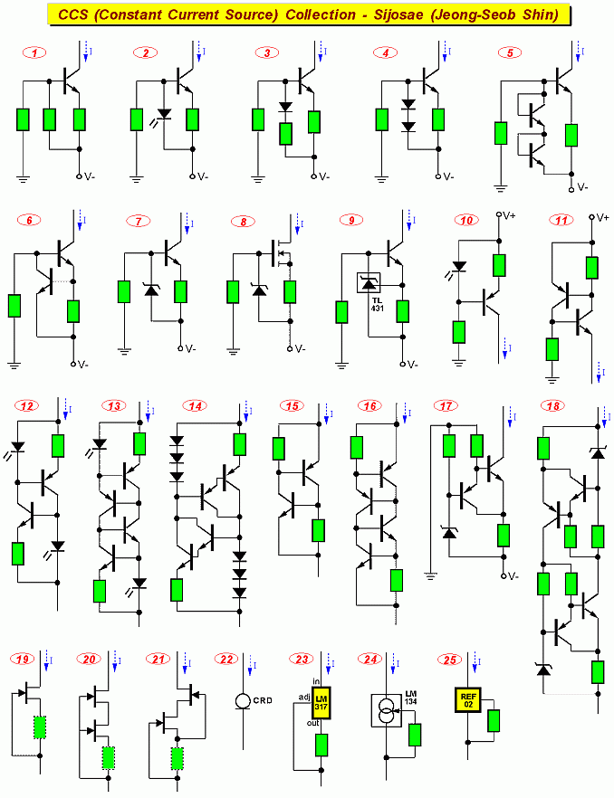

I think we can perceive the difference, but it is so subtle that I don't want to go the extra mile. If I ever built my own PCB, I will stick with the dual transistor ccs (on the left of the attached picture)

what do you say about the CCS??
Use Opam drive for CCS, it is very very low noise.
what ccs do you like??
thanks
In the past I like the sound of LED-based ccs. Even now I think LED is good for sound 😀 But nowadays I don't want to waste time getting the most out of ccs (because I can waste my time getting the most out of amp circuit, with ccs replaced with simply a "current source" in a simulator, hehe).
Also, JFET has never let me down for ccs, except for the "price".
One of my latest AlephJ uses resistor as the current source.
Currently I have been thinking about finding special LED or zener that has good properties for sound. Then I will use it everywhere by putting it in series with a resistor (the resistor will set the required voltage). But I don't know the theoretical effect of such approach.
