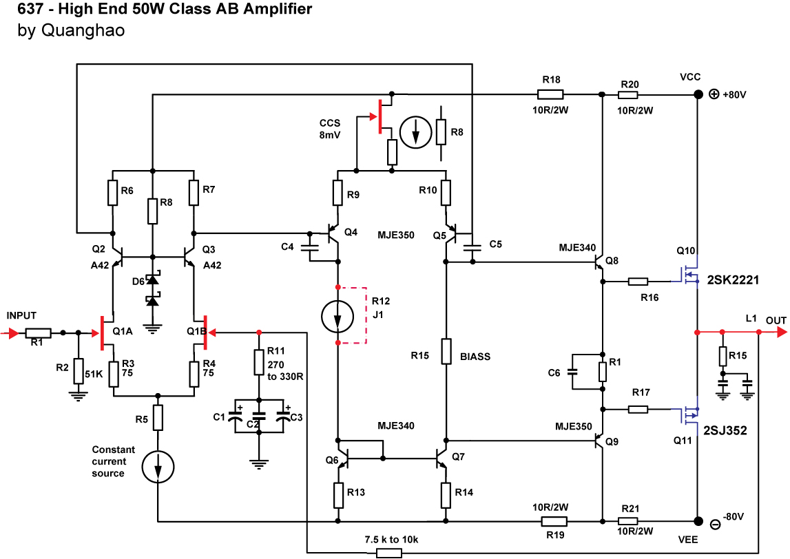

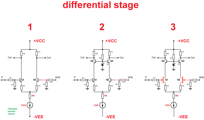

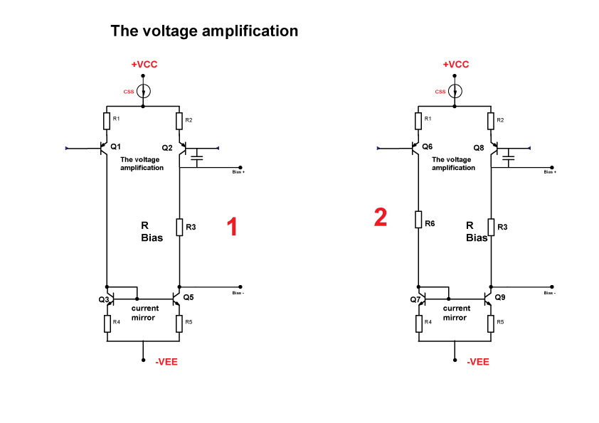

Quanghao, the input stage to the OPA6x7 is not a conventional LTP. Notice the phase is actually reversed; the Jfet sources actually point up; they are P-channel. This could give nice advantages to the way compensation is applied.
There are ways to perform this phase reversal with an N-channel or NPN LTP (something like cross-comp) but I think these may cause stability problems.
It would be interesting to see if you can make it work with the same input topology as the OP6x7. Otherwise, the circuit is actually pretty conventional, if performing well.

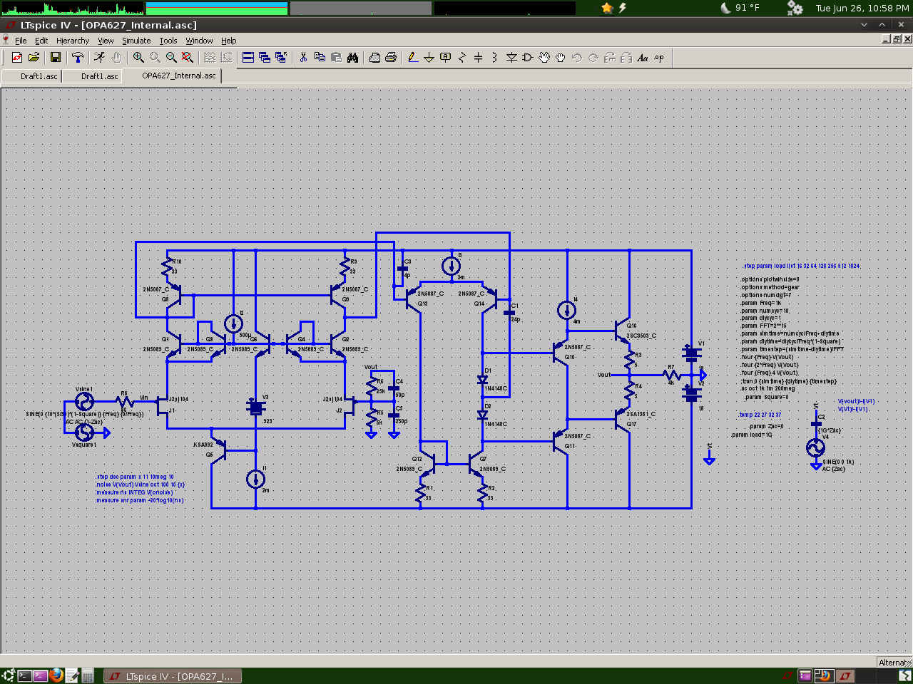

Quanghaou, none of those were the circuit used in the OPA6x7. This is the proper internal schematic. Operating points and transistors were guessed.
Again, notice the LTP is P-CHANNEL. It will not work if you remove Q1, 2, 3, 4 or 6. The input stage is the only thing, based on the datasheet schematic, that makes this opamp unconventional. Else it's just an ordinary opamp.
With discrete components, the amp should probably be converted to use the complementary parts since N-channel Jfets and bipolars will perform better.

Here is the simulation file. C4 and C5 have nothing to do with the actual OPA6x7; the high input capacitance of the J109 makes them necessary. I did not take much time to try and choose an appropriate input jfet.

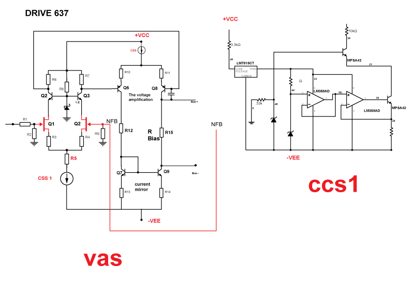

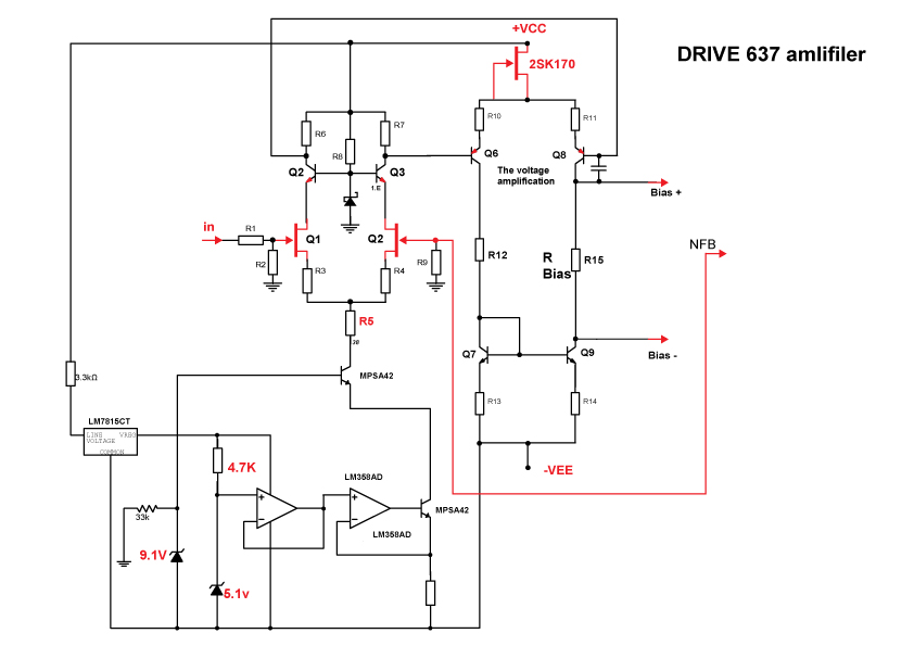

That complicated CCS is still no better than a 2-Q CCS. The base leakage of the cascode transistor throws away whatever good the opamps do. Cascode with a BC337 and it will be better.

Just replace the upper MPSA42 with a BC556B, BC560C or BC337.

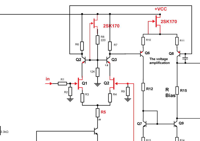

Or just eliminate all that mess with the Op-amps and noisy Zeners and replace it with a Idss, J-fet CCS like is on the differential VAS. Zeners are convinent components but come with a noise price. A Wilson mirror for the VAS would not be a bad addition either. Also, you can replace the cascode Zener with a resistor||COG type cap ~1nf, and replace R8 with another Idss bias J-fet CCS. J-fets are wonderful components to use in audio amplifiers, they have so many uses. I often wonder why they are not used more.🙄
