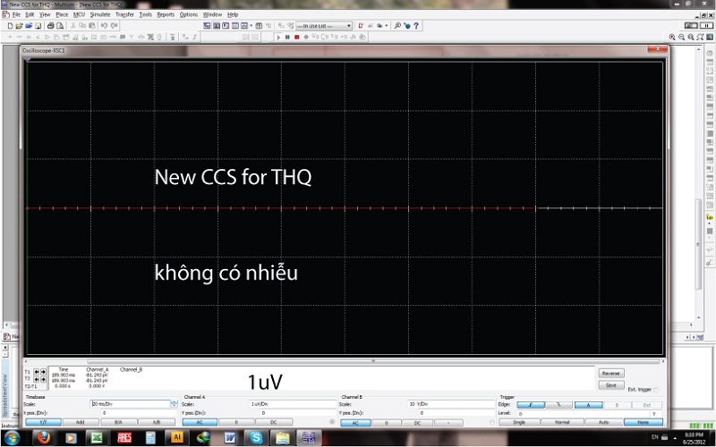

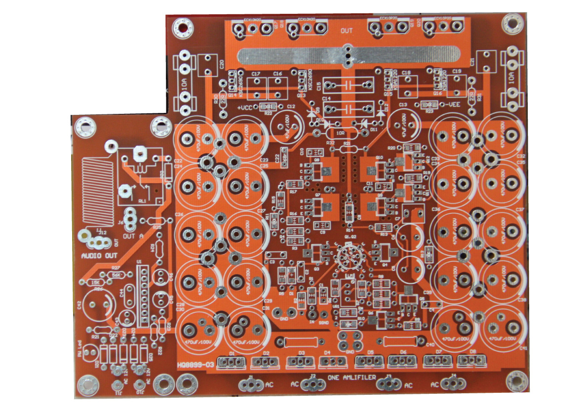

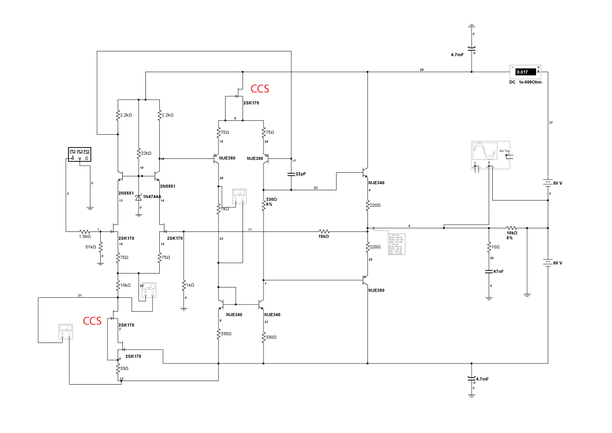

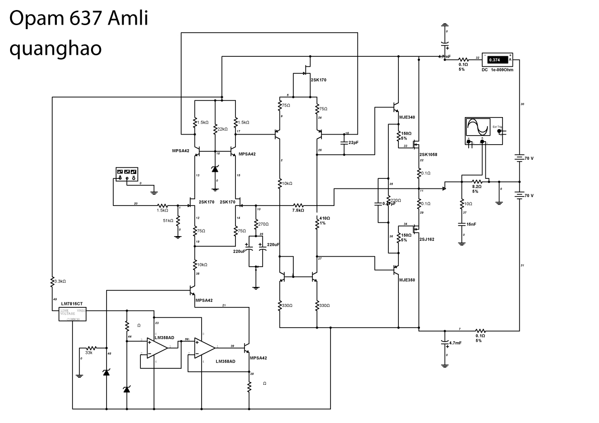

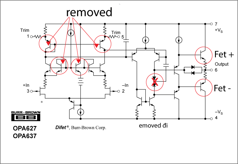

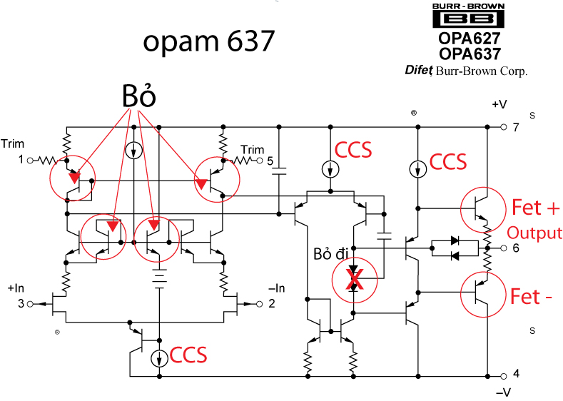

after I copy Goldmun Telos 2500 Amplifier, I was successful and not only that, on the basis of development, diy, and little understanding, learning and experience inherited their predecessors,
Quanghao also to design an amplifier with circuit diagram here. Please see
Thanks all

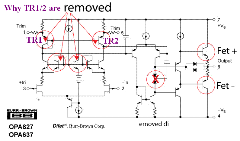

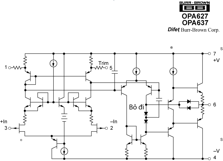

This thread originated with the idea of copying the relevant features used in the excellent-performing OPA637 op-amp, but applied to a higher-supply-voltage power amplifier. While in the process much is lost along the way with stage gains and slew-rate, etc., there's anopther aspect that was lost at the beginning and remains lost. I'm referring to the bootstrapped cascode stage used by the OPA637.
In the figure, circuit A. on the left is the form you're using, and B is an improved form that I'm suggesting. [sorry guys, I'm still figuring out how to make stored Flickr images work properly here, but you can right-click and see the image]
Unfortunately, JFETs do not have as low an output conductance as we'd like, and furthermore, the JFET output conductances in a transistor pair are not matched. Anytime you change a JFET's Vds you're going to get a change in Vgs. This is bad for amplifier distortion. Burr-Brown solved this by insuring constant Vds for the input JFETs.
Removing this feature might not be so bad for an inverting amplifier, because the input stage is always at ground, but you're using the usual non-inverting feedback configuration, which runs the input stage common-mode voltage through the input-signal voltage range.

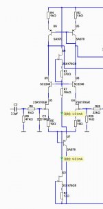

I agree with you winhill2.
I have been inspired of this thread about a OPA637 clone.
So, I have a slightly modified '637-amplifier' in my SPICE.
It is almost same input stage as you suggest, version 'B'.
Instead of Zener diode I use a resistor = R7 (15k) to generate a 15 Volt cascode.
