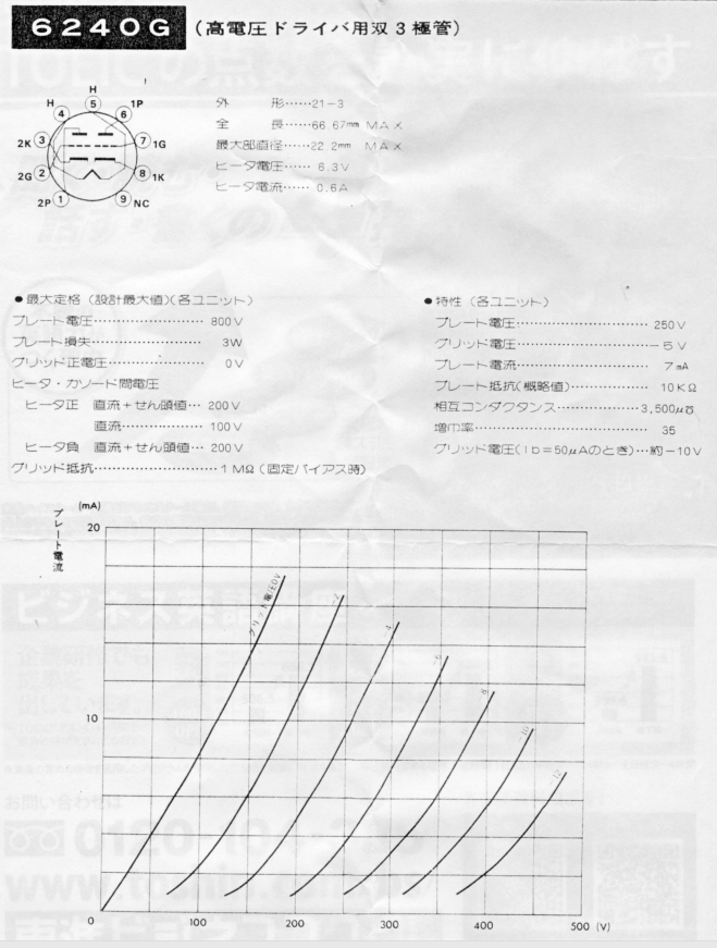

I was wondering if anyone has a data sheet for a 6240G vacuum tube? A Japanese manufactured tube used in Luxman Amps back
in the day.
If no one has a spec sheet, I am looking for whatever information I can obtain. Absolute maximum plate voltage, maximum working voltage,
typical plate voltage used in the Luxman 3045 amp, Mu, Gm, Plate Curves etc?

Bottom of the last page. https://www.museum.uec.ac.jp/archive/tube/(010L) Rating of Japanese Receiving Tubes.pdf

Not sure of the 6240G pin-out (base=m9-03??) but a substitute looks do-able with some juggling:I just did some searching around, and it looks like a 6CG7 is a suggested replacement.
- If the gain is important and the the 6240G is handling input under 2VRMS, then I'd be tempted to try the 5670 at maybe Vak=200V, ia=7mA, Vgk=-4V
- If the 6240G is handling big input signals >2VRMS, then the 6CG7 has lower gain but offers at least as much headroom at maybe Vak=200V, ia=9mA and Vgk=-6V
6240G | mu=35 | gm=3.5mS | Vak=200V | Vgk=-5V | ia=7mA | heater=600mA | base=m9-03 (??) |
6CG7 | mu=20 | gm=2.6mS | Vak=250V | Vgk=-8V | ia=9mA | heater=600mA | base=9AJ |
5670 | mu=35 | gm=5.5mS | Vak=150V | Vgk=-2V | ia=8mA | heater=350mA | base=8CJ |
Same pin-out as the 6CG7, so could try plug-n-play to see how it works
However, the electrical characteristics are more like a high rp version of the 5670 than a high mu version of the 6CG7 ....

Thank you gentlemen for your time and efforts. Much appreciated.

I know I'm late to this thread but there are a few options I've tried with my Luxkit A3600, which has the same original output (8045G) and driver/inverter (6240G) tubes. You can try either:
1. New reproduction 6240Gs here
2. NOS 6GU7s, which are a cheap, drop-in replacement (they are a 6.3V version of the 12BH7) - I bought quite a few and have found a well-matched pair which sound terrific
3. New (eg Electro Harmonix) or NOS 6CG7s or 6FQ7s, which are also drop-in replacements and, to all intents and purposes, equivalent.
