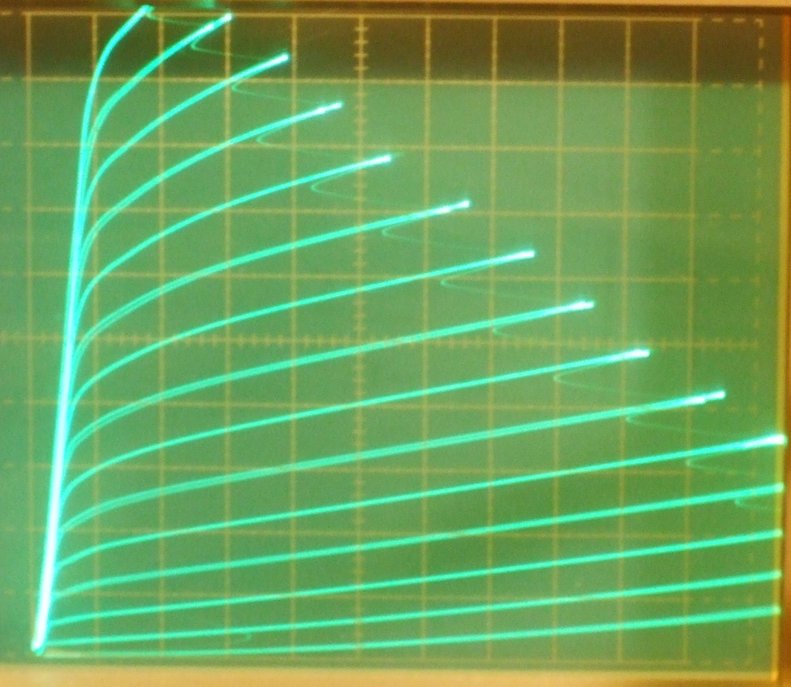

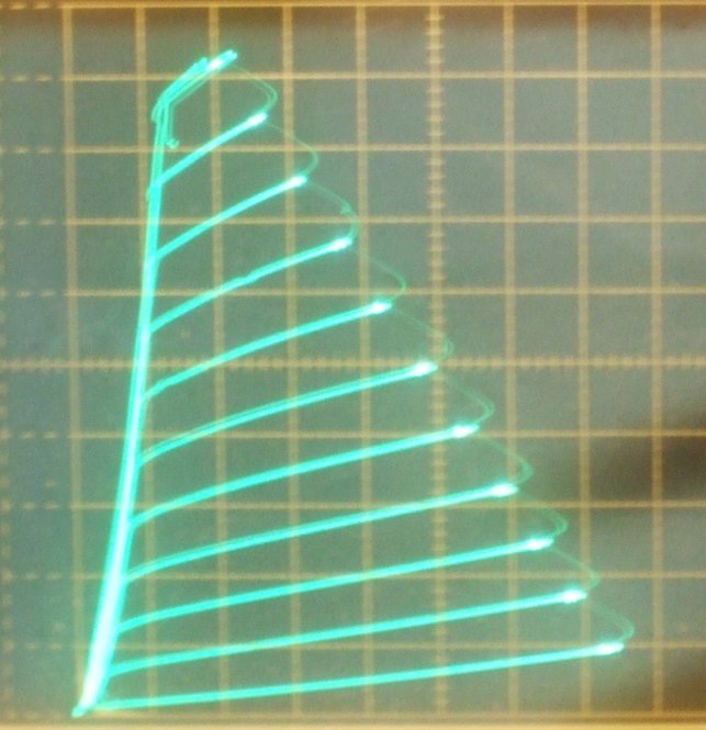

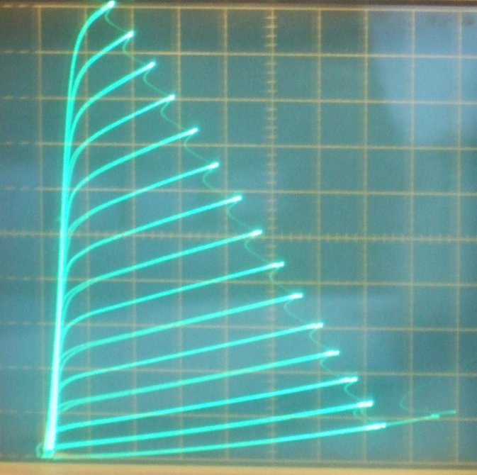

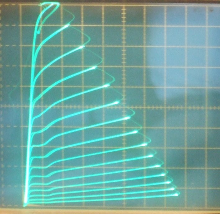

I think what scared designers off from TV Sweep tubes were the "kinks" in the plate curves near the knees. Audio tubes promoted the "kinkless" feature. But these are really out of the way for a typical load line, as long as the load is not grossly reactive (an elliptical load line).
Grid 2 drive gets rid of the "kinks" by the way. (see below) The low grid 2 voltages for the "Sweep" tubes helps make g2 drive fairly practical. With a g1/g2 Mu of only 3 or 4, it just takes 3 or 4 X the drive swing of grid 1.
The recent "discovery" or "re-discovery" of combined grid2 and grid1 drive (Twin [or Crazy] drive) now fixes the voltage swing issue further. Only about 2X that of grid 1 drive. (or about 30% less than grid 2 drive) With even further increased linearity. Efficiency should also be quite good too, since little conduction overlap is needed with either g2 or Twin drives to smooth out crossover distortion in P-P.
Some curves for the 40KG6/PL509 shown below in various modes:
(any Sweep tube seems to work quite well in Twin drive, even $1 ones)
All are curve traced at 50 mA/div Vert. and 50V/div Horiz. (except #5, is 10 mA/div Vert.)
1) PL509 normal g1 drive, -1.5V steps on g1, 78V on g2, top curve is 0V on g1
2) PL509 g2 drive, +5.5V steps on g2, g1 at 0V, bottom curve is 0V on g2
3) PL509 triode mode, -7.5V steps on g1, top curve is 0V on g1

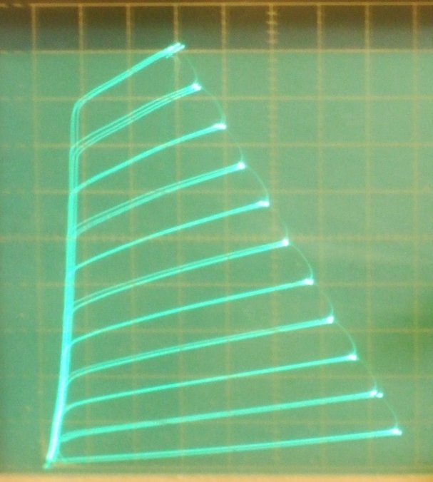

4) PL509 Twin/Crazy drive (g2 and g1 with resistors), +3.5 V steps on g2, Rg2g1 = 888 Ohm, Rg1k = 2770 Ohm, bottom curve is 0V on g2 (and g1)

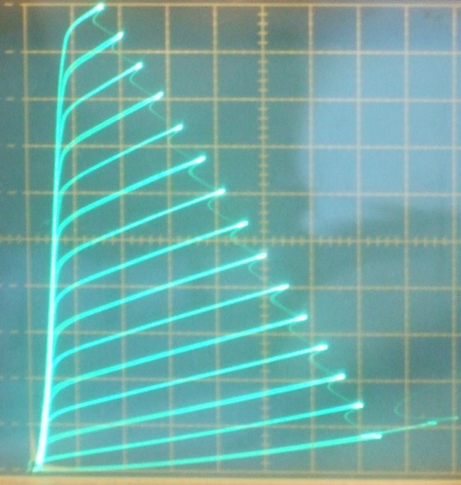

5) $1 frame grid tube in Twin drive
6) 6HJ5 in Twin drive
7) 1$ Sweep tube in Twin drive

Now I lust for a curve tracer!
Great post, thanks! Gorgeous curves. Clearly demonstrates the virtues of G2 drive but also shows the sweep tube as being just as capable as dedicated audio tubes.
As for kinks, the venerable KT88 has kinks but, as you point out, way out of the way of any normal dynamic operating point, at both low plate voltage and current, which by definition cannot be when swinging a normal load line.

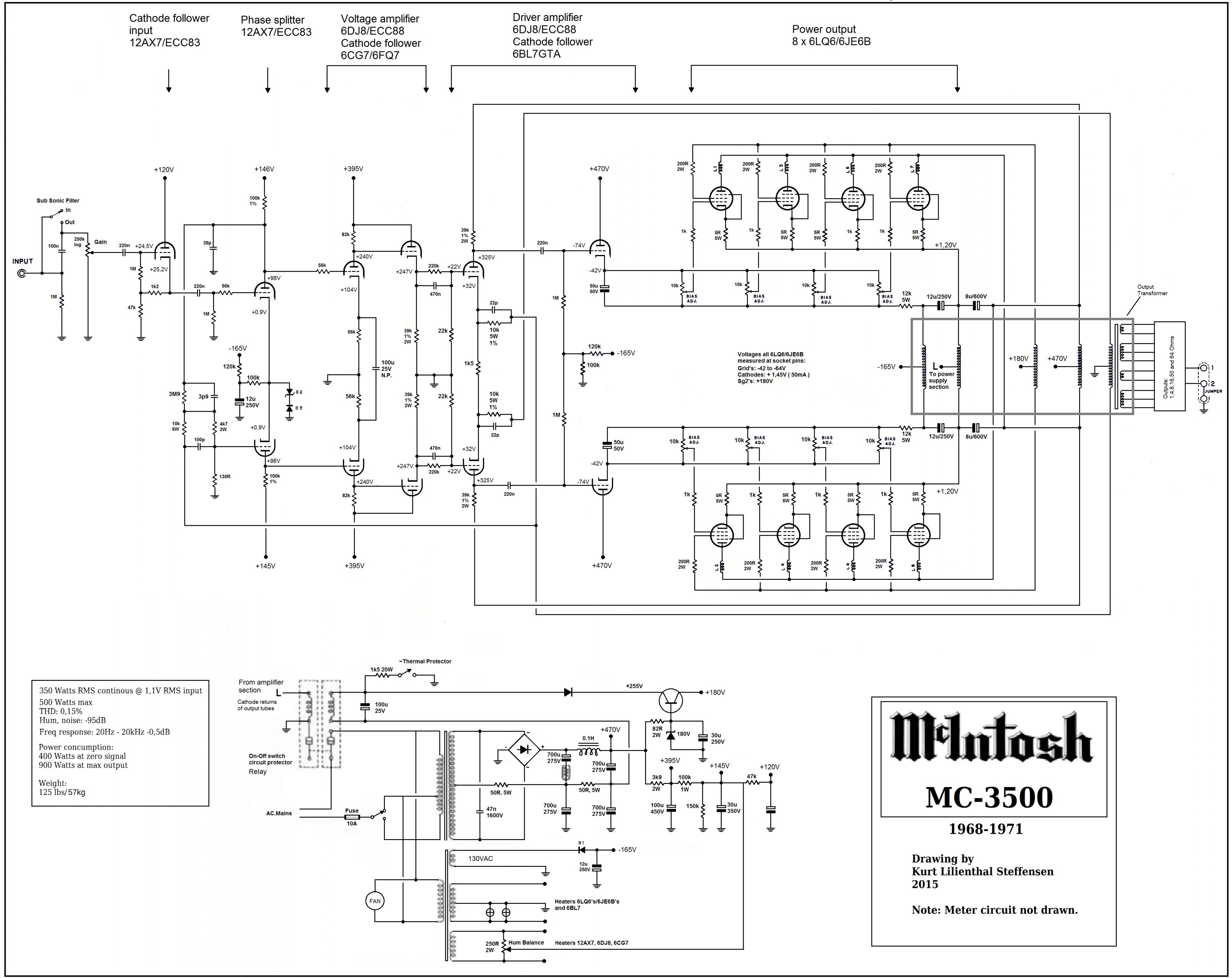

MacIntosh used sweep tubes in one of their high power units, can't remember which one now.
There were at least two high powered "industrial amplifiers" The MI-350 and the MC3500. I believe that they are similar designs using the 6LQ6 / 6JE6C tube.
The Grateful Dead used several MI-350's in their "wall od sound" for huge outdoor concerts. The MI-350 was also used to power the 1969 Woodstock Music Festival.

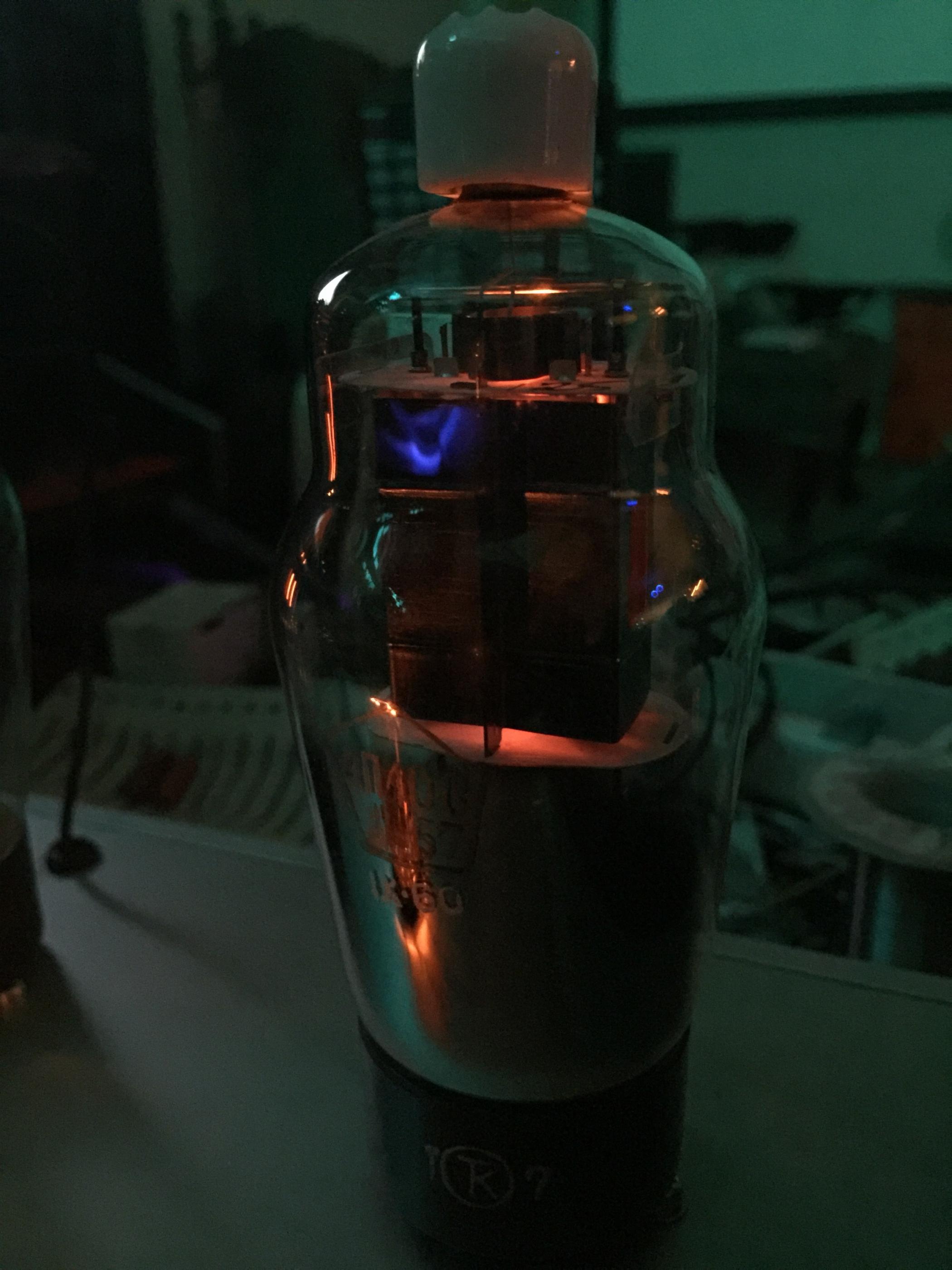

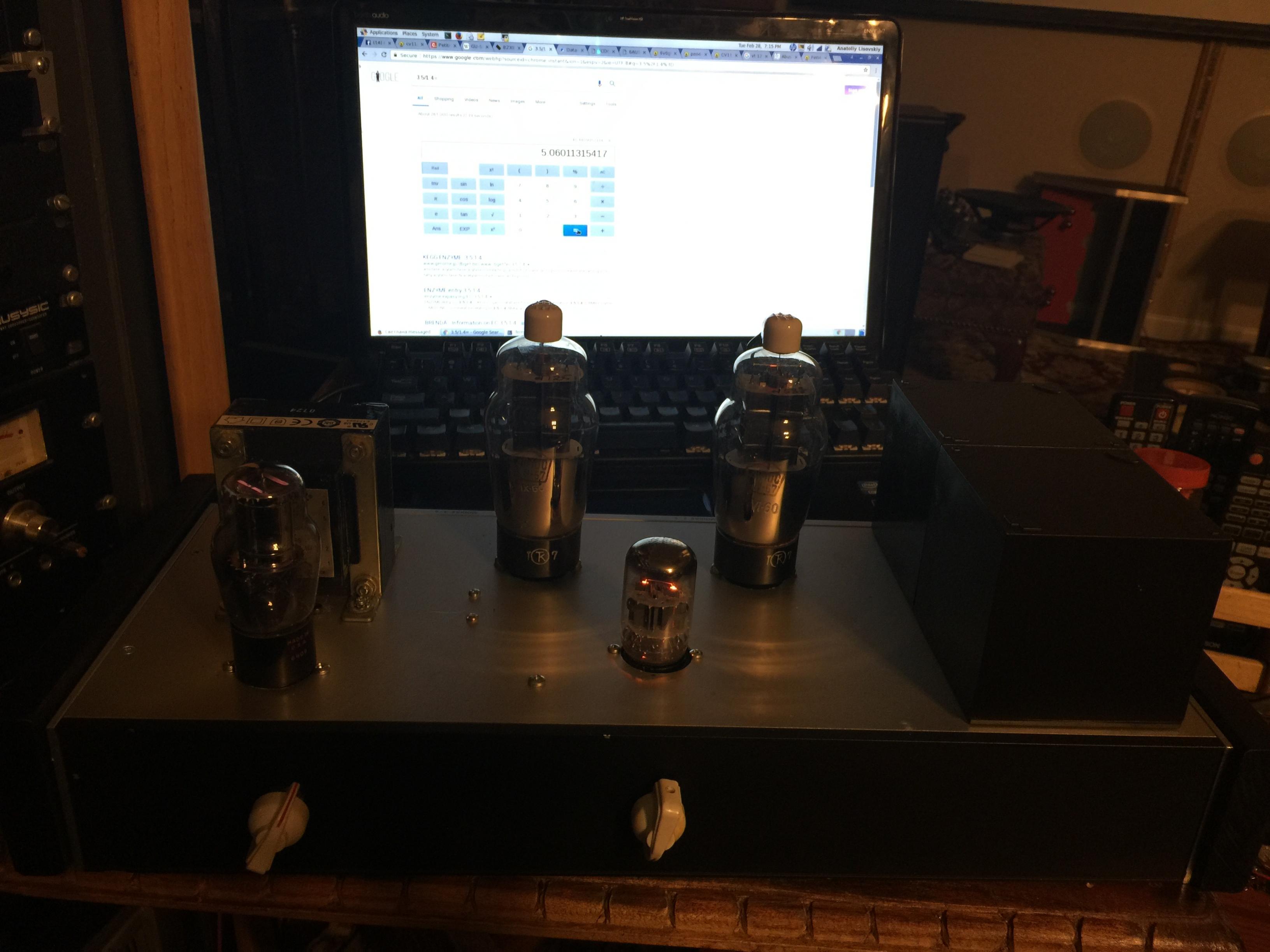

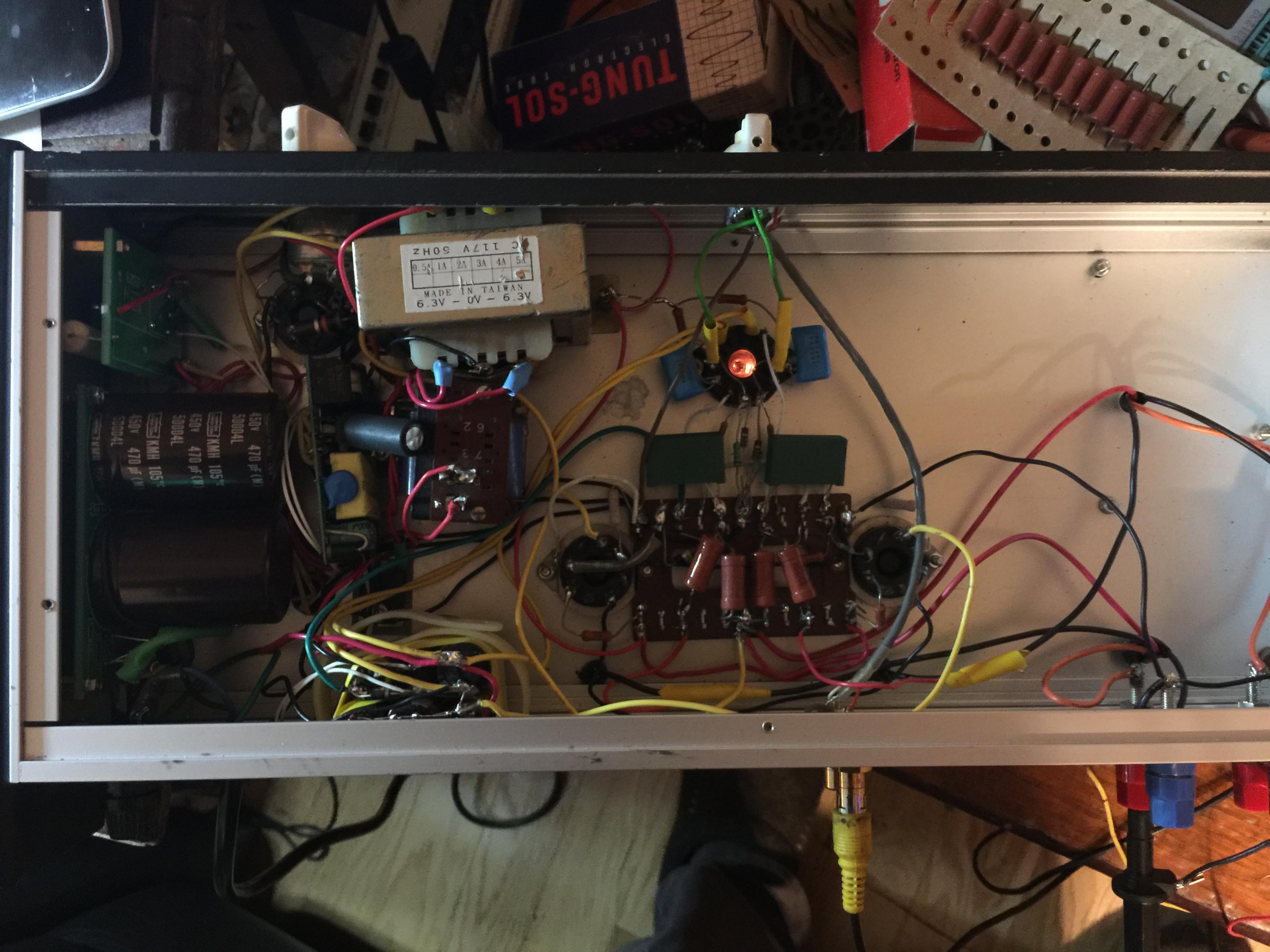

It turned out that a "secret WW-II sweep tube" is capable of 5W of pristine clean sound in SE, with 310V B+ and 4K5 transformers. I wonder though, why Edcor positions them as 15W transformers, if they are capable of 4.5W only down to 110 Hz, then saturate? 😱
-9V bias, 215V stable on G2.

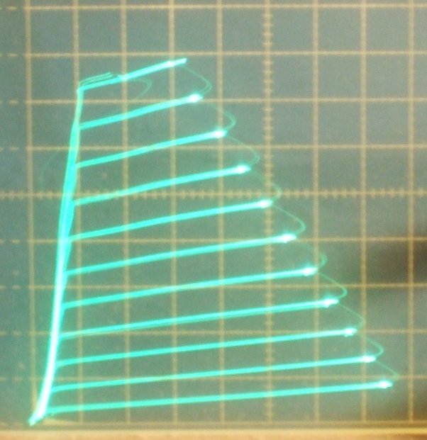

"The 6HJ5 curves to be found only have one G2 voltage listed but the close cousin, 6DQ5, has a full set."
Here are some 6HJ5 grid2 curves.
+8V grid2 steps, starting from 0V for the bottom line. (and +112V for the top curve)
This particular tube gives a 650 mA knee for +150V on grid2 (well above the datasheet spec of about a 550 mA knee [extrapolated by 3/2 power law from 110 Vg2 curves, or from +135Vg2 curves for the 6HD5])
If you need higher grid2 curves than the top +112 V one shown here, you can use a 1.1 power law for current versus voltage on grid2 to re-scale them. (ie, for a 150V top Vg2 curve, with 14 +10.7V Vg2 steps, the Vert. scale factor would change to 69 mA/div, giving about a 650 mA knee as required)
Scale: 50 mA/div Vert. and 50V/div Horiz.

"I wonder though, why Edcor positions them as 15W transformers, if they are capable of 4.5W only down to 110 Hz, then saturate?"
How much DC current are you putting through that SE OT? The GXSE-15 I measured once did just hit hard saturation at the 15 Watt level. No room to spare. SE OTs should be de-rated for max power at the max permeability point, or just above, I think. So about 1/2 the Watt ratings given. Those who rave about SE OT performance don't have any idea how badly those things actually perform. 🙄
