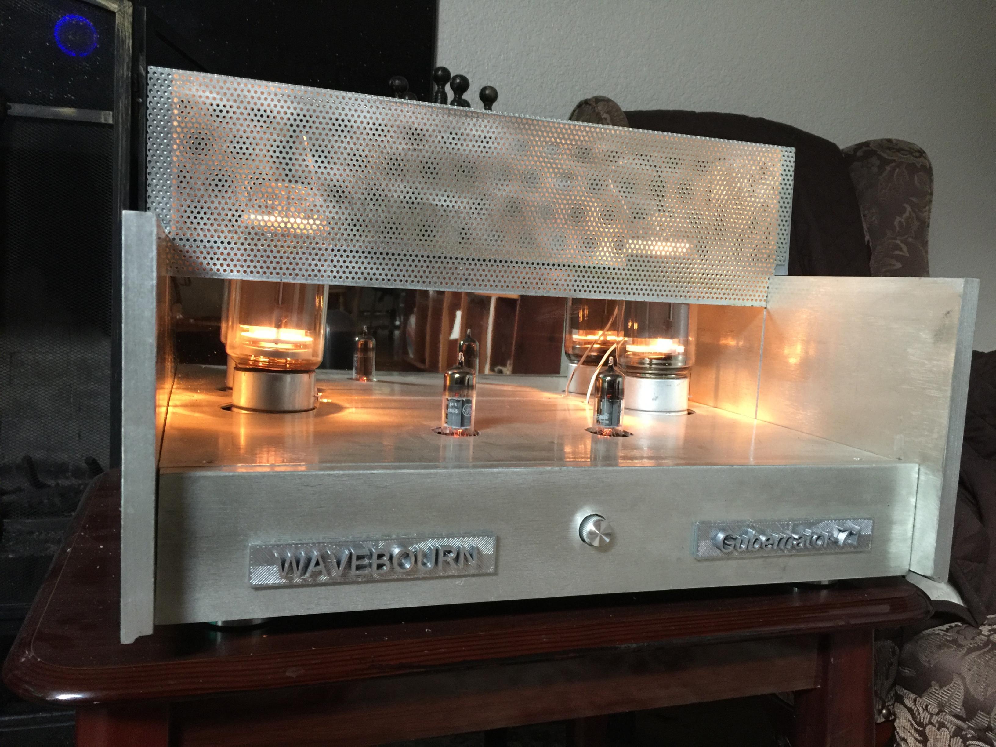

So what? Grid voltages are actually different, since there are different values of grid bias resistors drawn. Now they are equal, and additional degeneration resistors 1.5k in cathodes added. But as is, we measured the amp with SY, and saw only -80 dB of 2'Nd harmonic when below 40W power. The rest was under the noise floor on his screen.

The amp already looks pretty well. Probably no dominant pole compensation will be needed, since the amp has probably not enough gain by the loop for instability. I would start breadbording it. However, since you already have feedback by voltage on first grids of power tubes, I would try also a version with cathode feedbacks to driver tubes.
