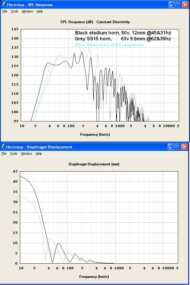

stadiumhorn fills the bill.... 30hz it can do.
You've got the hornresp posted -- go find whatever driver you want to put in it, and see how it fares.
It was designed for a 3015lf.

If you want a sub that works with a variety of different speakers, and has an actual measured corner frequency of 35 Hz (or lower with a reduced mouth size)
http://www.diyaudio.com/forums/subwoofers/185588-keystone-sub-using-18-15-12-inch-speakers.html
The Keystone design could be made a bit wider and use two 15” speakers and still occupy less volume than your size specification.
It is smaller and goes lower than Jim’s (jbell) stadium horn, and is easier to build.
The Keystone would probably even work with your thrift store speakers, but usually thrift store speakers have wimpy magnets that make for a peaky one note bass response.
Tapped horns work well with strong magnets (high Bl) stiff cones, and lots of Xmax.
Get a dB meter, a VOM (volt/ohm/meter), down load some test tones so you can actually start comparing the speaker output of what your hands build.
And take Jim’s advice and learn Hornresp 🙂.

Seriously, if you're looking for an easy-button tried and true, proven single cabinet horn sub solution, Jim's Stadium Horn is great.
I have another DIY option (33 Hz corner, loaded with a $90 15") that is a bit smaller, but it does not get as loud, and it is a far more complicated build. It is also far less refined and tested. As far as I know, there are only two out there in the wild.

Things to Consider
For all cabinets to date I had the parts cuts by the timber shop. My only cut was the circle for the driver.
The BFM cabinets took me a long while to build, I don't know how long.
I built two Stadium Horns from scratch in a couple of hours. The 3/4 inch wood makes them easier to construct than the BFM designs, but considerably heavier.
I had a pair of Tuba 36. I could lift a 30 inch T36 over my head if necessary. I certainly can't lift the Stadium horn. However, the Stadium Horn is so solid I regularly have people dancing on it, and I can easily manoeuvre it on its wheels - blue wheels cost me 6 Euro a piece.
What do you want?
Light - BFM or the SS15
or
Extra strong cabinet - Stadium Horn
Small - the smaller BFM or the SS15
or
Single cabinet capability - Stadium Horn
Lower response as you stack more cabinets - BFM and similar
or
Flat response - the JBELL designs
