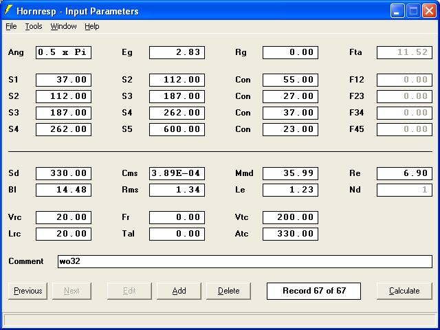

and here's my terrible attempt at reverse engineering a hornresp for this sub using the recommended driver. (actually it's half of the cabinet)

I think there is a bit of misunderstanding on what 60ndown actually said:
not me, always was, always will be about the music......
im never going to spend my hard earned money on drivers amps and plywood, and my time building something so i can hear/feel a dinosaur footstep or a 16hz cannon shot,
read carefully guys
I think his point was that he doesn't want 16hz, but likes to listen to m&m (sorry couldn't resist) which has some strong 28hz. His problem is he's using a 5' long horn with a 5.5mm xmax driver trying to play 28hz notes. Even corner loaded that is problematic.
The wo32 needs a smaller rear chamber and a longer horn path to do this. making another trip front to back, all 2"x12" (no taper) will give another 2 feet to get to 7', and the smaller resulting chamber will add a bit of reactance annul, and he'll get closer to what he really wants. Now, is that a 12' path to really play those 28hz notes with authority? no, but it'll be better than having to cross at 60hz 12db/oct to offset the 10db rise from 50hz up to 100hz to make things kinda flat. And with a real corner helping to lengthen the path -- who knows, he might just get what he's looking for.
