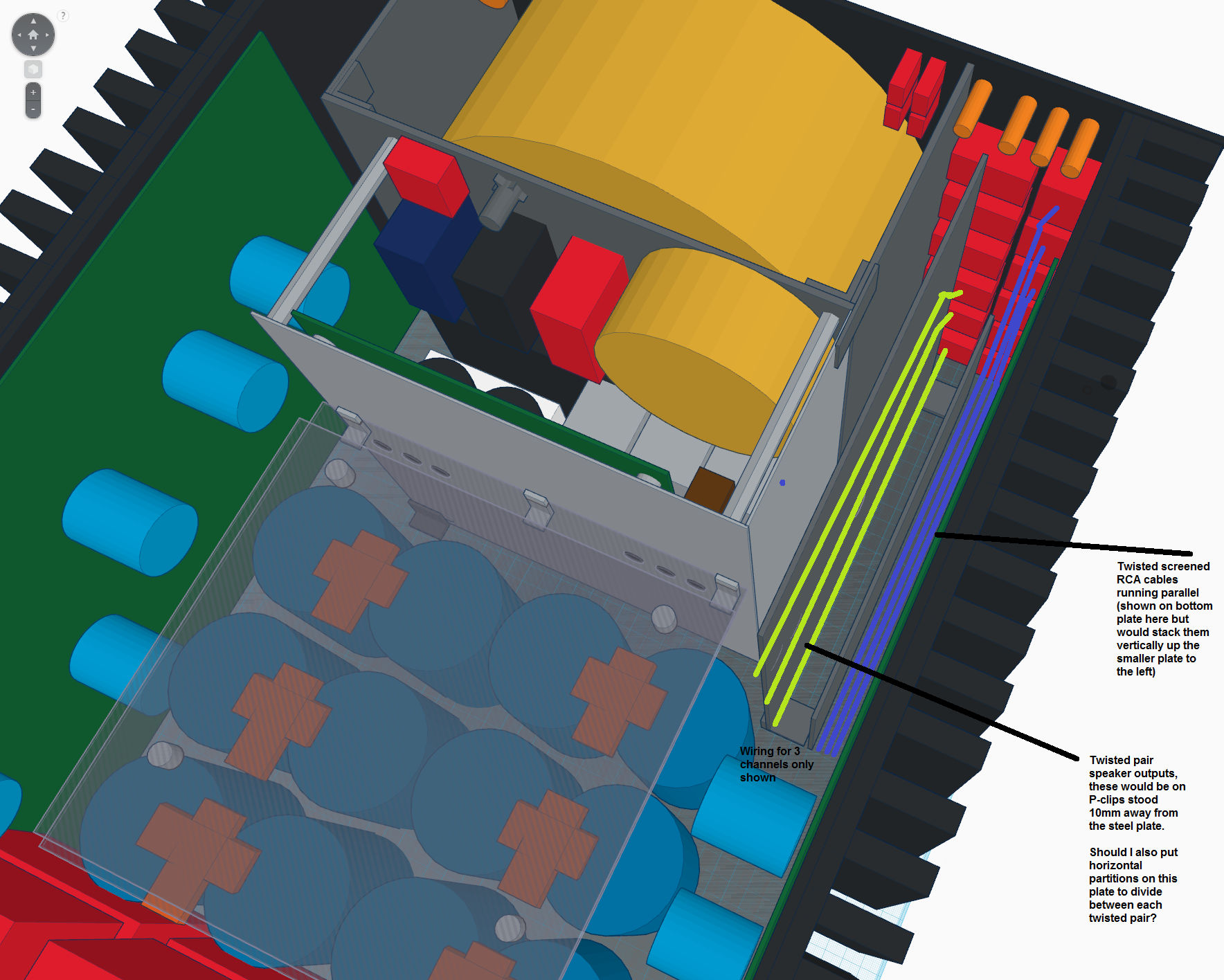

Could someone please advise on screening between amp PCB and speaker terminals to avoid cross talk? Is it necessary to segregate twisted pairs from each other and if so would something like copper tape onto the metal chassis with a 10mm gap between each be sufficient, or should I make trunking like slots from steel, to effectively screen them from each other? Bearing in mind that there could be some fairly large transients at 600W+.
I have already added a 2mm steel plate to tie output and input cables to on separate sides, since the lack of space unfortunately means they are in close proximity to each other.
Cheers
If you mount cable on it then there is no air gap. Unlike electrical conductors, we don't have the equivalent of a magnetic insulator; all we have is distance.
If you have two circuits some distance apart then putting steel between them (well spaced from both) can reduce magnetic coupling. Putting steel next to one or both of them can increase coupling.
I was meaning the implied air gap due to the insulation thickness of the cable. I guess at what point/distance does an air gap become beneficial is the question then?
I was assuming the "sandwich" of 1.5mm insulator, 2mm steel, 1.5mm insulator would still be beneficial vs 3mm total insulator cables running parallel with no steel.
Is the steel actually required if I just maintain an air gap of 10-15mm or so? Or is it advisable for a multi-channel amp where the speaker terminals aren't soldered directly on a PCB to combat crosstalk?
My current design for input and output wiring is shown in the attachment, much easier than trying to explain. Is this as optimal as it can be given the placement of transformer etc? Should I add extra mini horizontal metal partitions, in between the twisted speaker output pairs?

I would not run input and output wiring next to each other.
Please describe or modify the diagram to how you would run the cables as I can't see any other way of getting more distance when the connectors are panel mounted next to each other? The are already divided by a steel plate.
By "twist lengths" do you mean the "tightness" of the twist?
Should I use horizontal steel partitions as well on that plate (unless you have an idea where that plate is no longer there) ?
I would not have mounted the input and output connectors so close together.
Strictly speaking, twist tightness refers to how close the two wires are to each other but people often use it to mean twist length instead.
I think you need to get away from your obsession with adding steel plate everywhere to solve layout problems. Steel does not shield magnetic fields in the way that any good conductor will shield electric fields.
There is nothing I can do to solve this, I either have them there or next to the AC IEC inlets on the other side. The transformer takes up most of the space on the back panel and it is too large to sit in the middle above the caps. I can't extend the panel any wider without violating max rack mount width which I want to maintain.
Given the locations of the output and input are therefore fixed, what is the best strategy for minimising coupling based on my suggestions or any other ideas?
Most of the other steel panels are for structure support btw.
