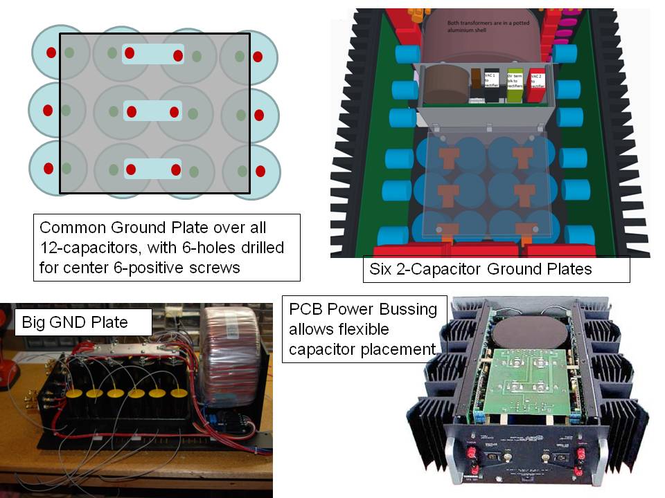

This is still easier than trying to place a common plate across 12 capacitors that cannot all be lined up in "twos". All amps will be identical.
If necessary, a designer could construct one Common Ground Plate over all 12-capacitors, with 6-holes drilled for the center 6-positive screws,
OR
use a PCB with heavy copper layers for greater capacitor placement flexibility, plus reduce some wires by using solder-down relays and diode bridges. The +/- 15V protection power supply could also be built on this PCB.
OR
Commoning all the capacitors doesn't gain anything since they are already connected together at the 0V terminal at the transformer centre tap?
Creating a PCB with heavy copper layers isn't the easiest option for DIY. I also like the idea for keeping things seperate for modularity in terms of future maintainance / upgrade.

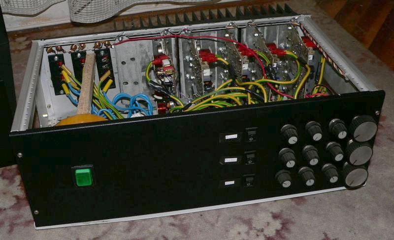

And - if the "P'n'P" approach was already mentioned - what about an
integrated layout when you build each channel with its PS on one PCB?
Then you can spare a lot of air-wiring and you only have to lead the AC lines to
these modules. And you could place each channel as a card on a motherboard.
So 3 channels / side. Similar to the attachment. (I made this ugly one about 15 years ago... :blush:)
I started with 2 or 3 bigger trafo then I kept only one ~200VA, and it was more than enough for HT... :p

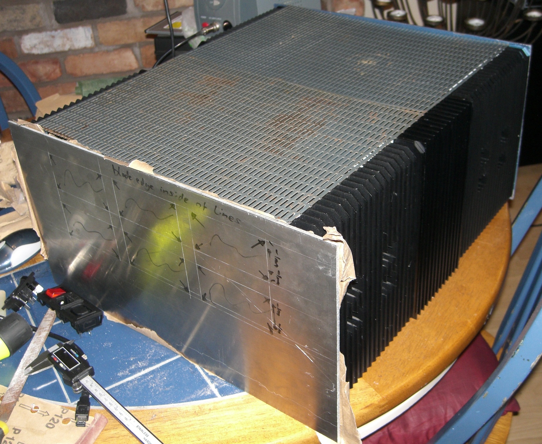

Heavy indeed.. the bare case with heatsinks is coming in at 23kg, another 22kg for the transformer and that's 45 before anything else! Total weight is looking to be around 56kg. I really don't want to use casters as they're look ugly although I'm now having to reconsider.

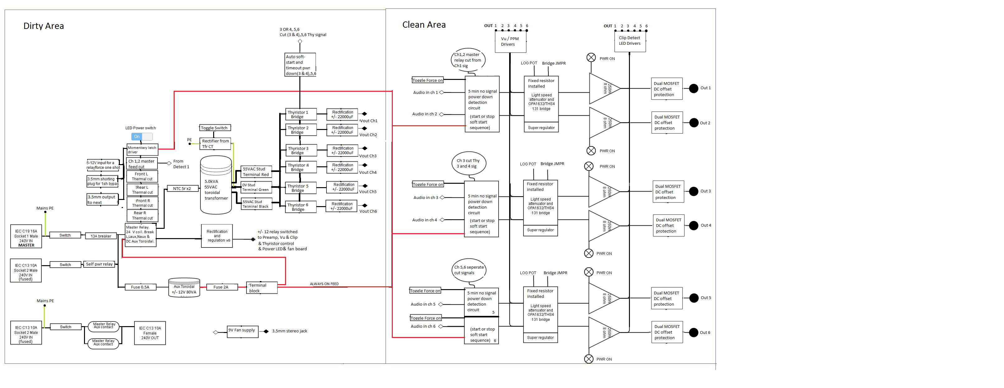

Yes, remember to enlarge!
It's not the greatest diagram I know, It's been added to over the course of a year.
It began life in a software program I lost / didn't reinstall so I've been editing it in paint since.

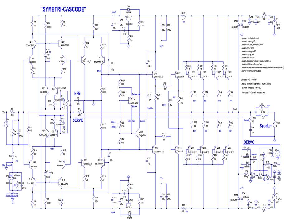

For your schematic collection:
Slewmaster - CFA vs. VFA "Rumble" thread has PCBs for a "SYMETRI" amplifier topology similar to attached "SYMETRI-CASCODE" LTSPICE schematic. A careful thread read is necessary to find the latest schematic and PCB. A cascode front-end allows the use of low noise input transistors. The symetrical 2nd stage assures robust clipping. I have built amps with 10x lower THD, but none which could safely scale up to 75V.
FOR YOUR 75V POWER SUPPLY, you will need to check and re-check the max-voltage specs for all devices and run enough simulations to feel safe. For a 75V power supply I suspect you will find more PA-style medium sound quality Class-B designs than high sound quality Class-A/B.
75V ... Be Afraid....Be Very Afraid!
I can share some simulations if you decide to use opamp based analog protection circuits instead of the PIC microprocessor designs that are now popular.
