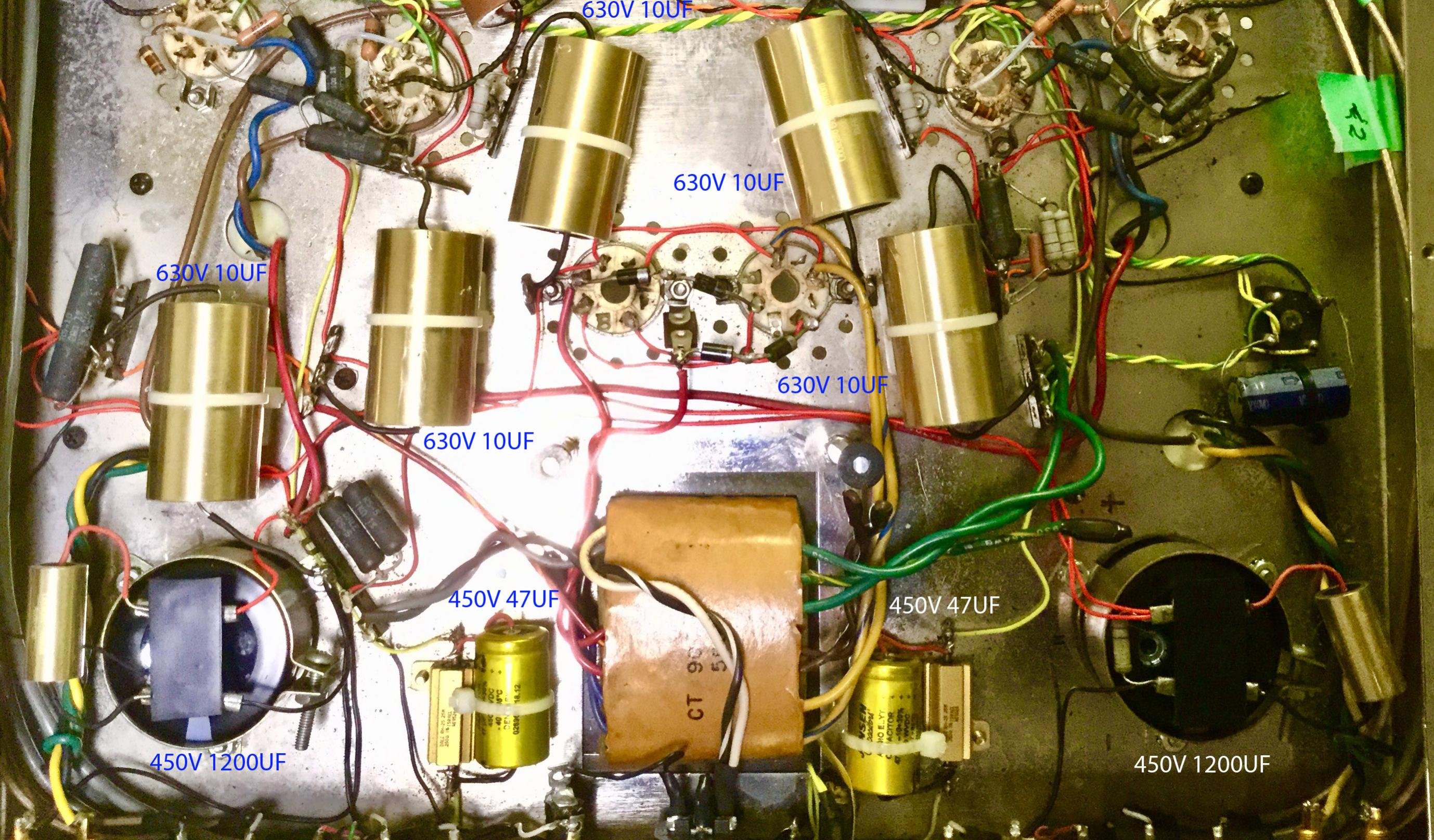

Hmmm. OK, so, perhaps help me understand. Lets start with what goes to and from the 5U4's. If you tell me what I should be looking at in terms of components and what the current (pun intended) values are or those in the 5U4 "chain" then perhaps I can understand better what this "design problem" you are referring to is.

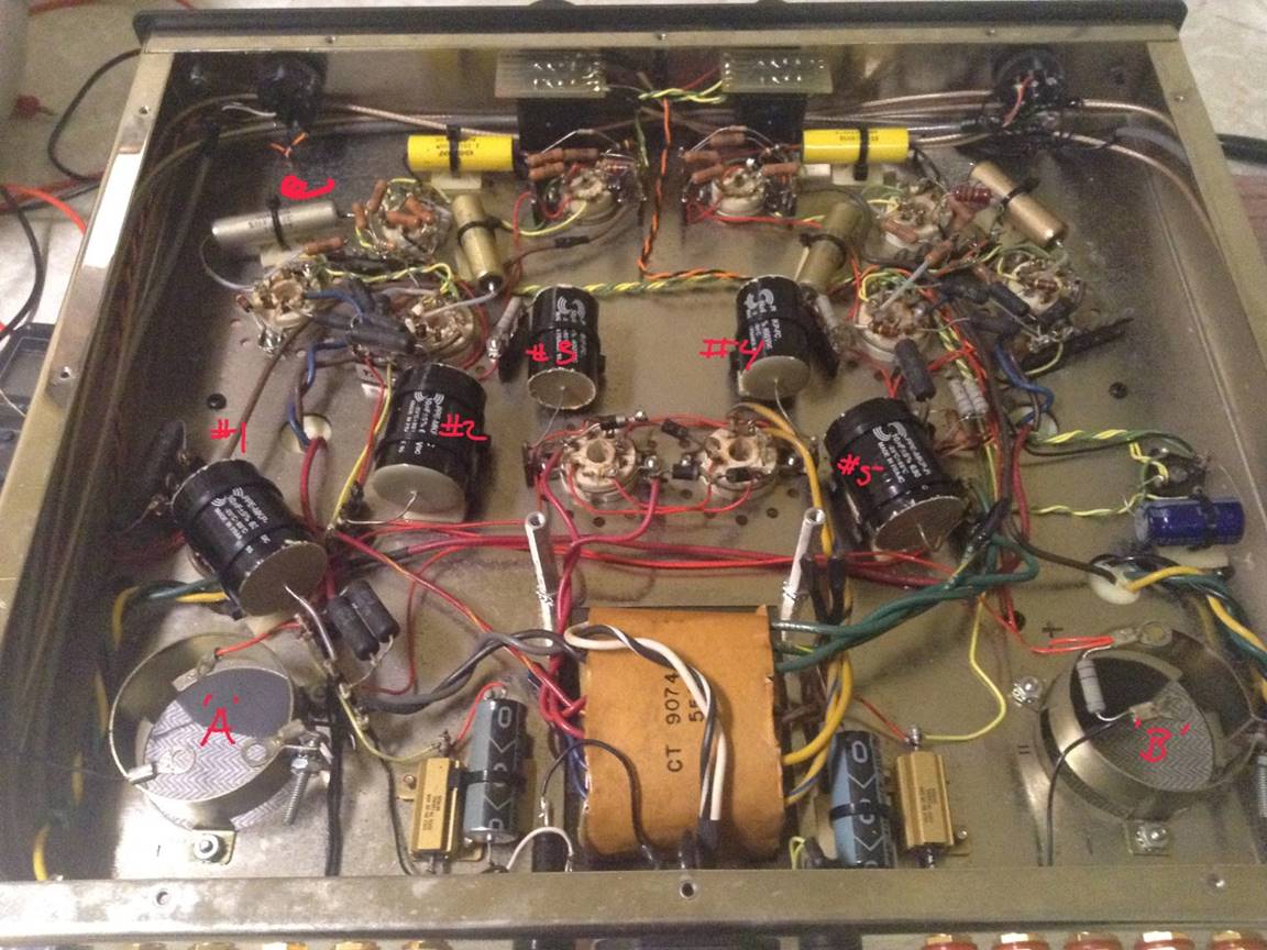

Oh, and this is the amp pre any work (big power supply caps have been removed in this image)

I'm trying to figure my way through this and what the exact problem with the rating of the caps used is?
More than happy to get in there and make changes, however, kinda want to understand why the changes need to happen?

The capacitors are much too big for the input of the rectifier - because the enormous capacitor doesn't discharge much from the amplifier load between the 120hz pulses of DC, the conduction angle becomes very short, and the rectifier can only conduct for very short pulses because the capacitor can only charge when the voltage of the cap is lower the the voltage common off the rectifier.
This causes lots of stress in the rectifier because there is nowhere for the current to go except for a small window.
Now if the first capacitor the rectifier sees is small, and preferable followed by even a small choke, the current has somewhere to go because the small capacitor is discharging quickly and has room to accept the charging pulse. The choke can accept charge 90deg later than the cap and therefore helps give the pulse somewhere to go and smooths the supply quite a bit.
Anyway, after the first CR or CL, you can make the filter reservoir as big as you like.

"Note 2) To prevent large charge current peaks, the first capacitor (C1) should NOT be larger than 40uF. If the input capacitor is too large, this will result in heavy AC charge current through this capacitor. This is not good for the rectifier tube, and also not for the capacitor lifetime. The AC capacitor current peaks may cause hum radiation into the preamplifier. With the given C-L-C values in table, the rectifier circuit will work best. For filtering, with oversized components, you will have best results by increasing the choke. Do not oversize capacitor C1, this may increase hum. You can choose the choke large as you want. This will have better results with high voltage rectification."
"Note 3) Rectifier tubes may under no circumstance carry larger current peaks as what they are designed for. The current peaks are mainly a function of: power supply DC load, first capacitor and transformer copper resistance. The copper resistance for 5U4G and 5Z3 may not be smaller than 170 Ohms. This is very important to check, and too low copper resistance may damage the rectifier, no matter what brand or construction. Use a small series resistor if the copper resistance of the used transformer is too low. If you scroll further down this data sheet., there is a link to a table with historical information about this, for several rectifier types, not only 5U4G."

I'll check what is where. Trying to find a schematic...
Why don't you draw out what you have? 😉
...I mean draw the schematic from what you see. Start at the transformer, to the rectifier sockets, to the various things in the PSU, to where the PSU connects to the audio circuitry.

It seems that a lot of the comments have to do with large caps. There are none other than the big 1200uf power caps??? So, trying to figure out if there are no big caps, then what do the caps have to do with arching as if they are bigger than 40, they cause a problem?

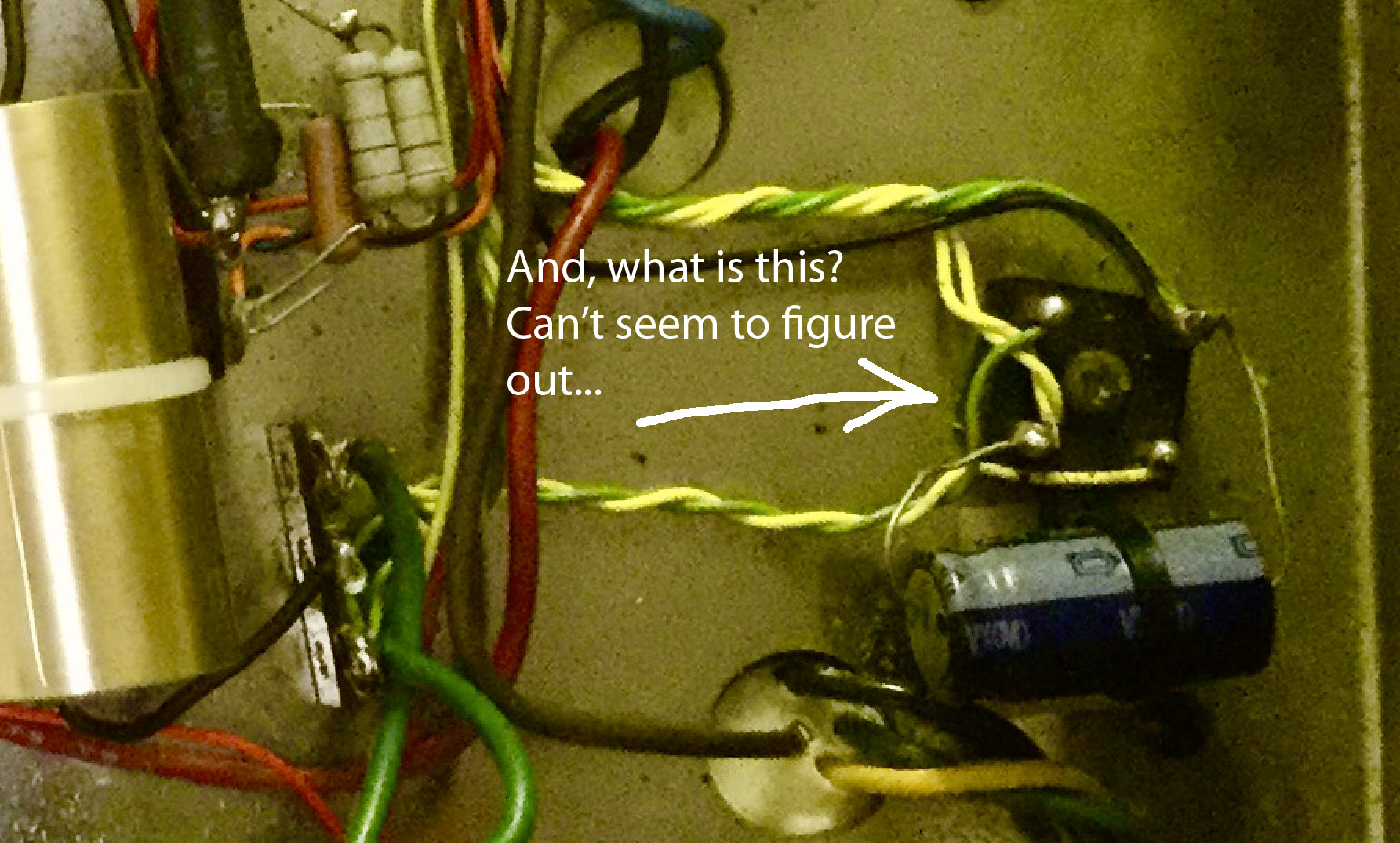

Also, does anyone know what this is? It's connected to the only cap I did not replace...

Dual 5AR4 rectifiers with 1000uF input capacitors were not totally uncommon in the 1980s and later. I have worked on several pairs of early Quicksilver 8417 amps with 800 - 1000uF input capacitors. These particular amps were built when new Mullard 5AR4 were still readily available, current production types don't seem to survive for long in these amps.
I don't think it was a good idea, but the manufacturers got away with it for some period of time apparently.
To the OP I would look for a very rugged pair of 5U4 like the GE or RCA, and I would install 1N4007 diodes in series with the plates which may or may not help in the arcing problem (should help with hot starts I'd think)
Hopefully people have noticed the standby switch in negative side of the supply - the Cary schematic is not particularly clear. I'm not convinced this is the safest way to do it. (I'm also not a fan of the standby switch)
