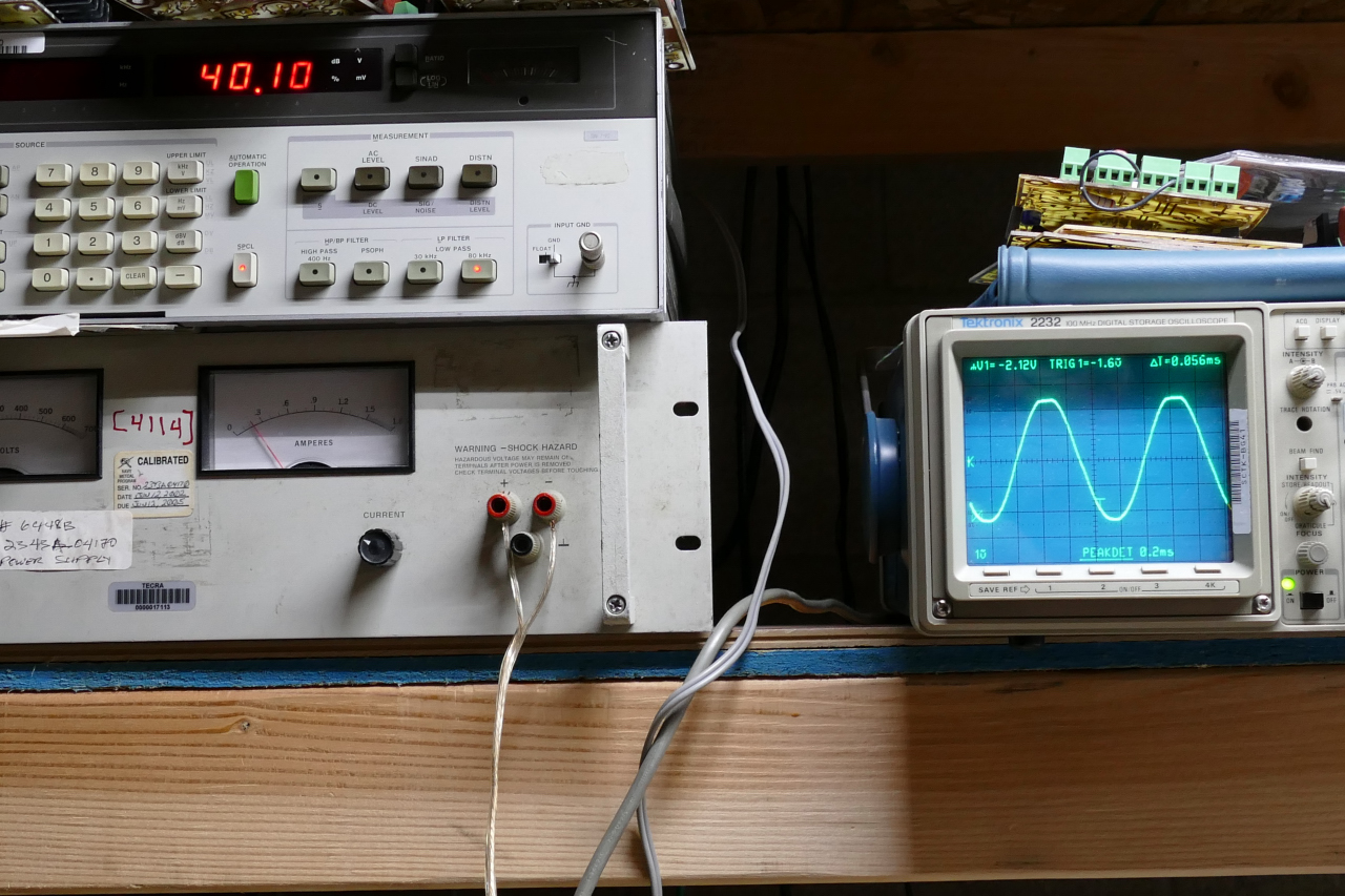

I decided to really hammer on some 32ET5's since I have about 50 of them. I had already explored 340 volts on the plate (rated for 150) and 150 volts on the screen (rated for 130), so I turned the knob to the right. For several hours I had 400 volts on the plates of a 150 volt tube, saw power levels in excess of 50 watts and NOTHING was glowing.
This is too good to be true, you certainly can't squeeze 50 watts (OK at 14.3% THD) out of these things, I must be doing something wrong. Is there really 40 some odd watts flowing from these tubes? Touching the 120 watt load resistor leads me to believe there is (it's pretty hot)......OK sanity and reality check, hook up a speaker and crank it.

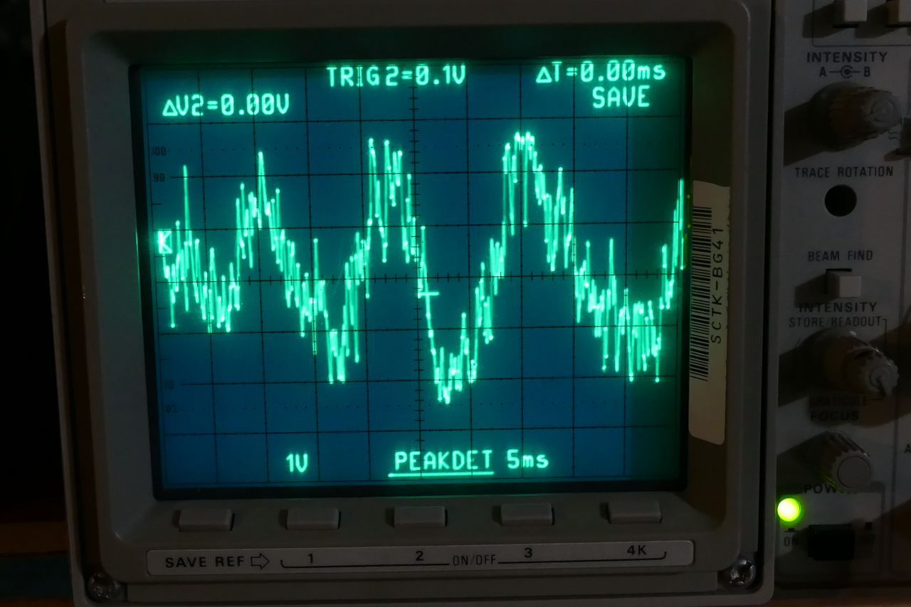

I connected my iPAD to the input, and a $10 thrift store Cerwin Vega speaker that is quite inefficient to the output. I wired my scope across the speaker and played music for at least an hour at full volume. Simple music (Jesse Cook's flamenco guitar) comes through nicely with unclipped peaks touching 50 Vp-p (pic 1). Lets get loud, Trans Siberian Orchestra at full crank, again 50 to 52 volt peaks, unclipped (pic 2). OK crank some modern uber compressed stuff, TNAF Punching in a Dream, clipping happens....a lot! (Pic 3) So if these speakers are 8 ohms, clipping happens at about 43 watts. And nothing blew up.

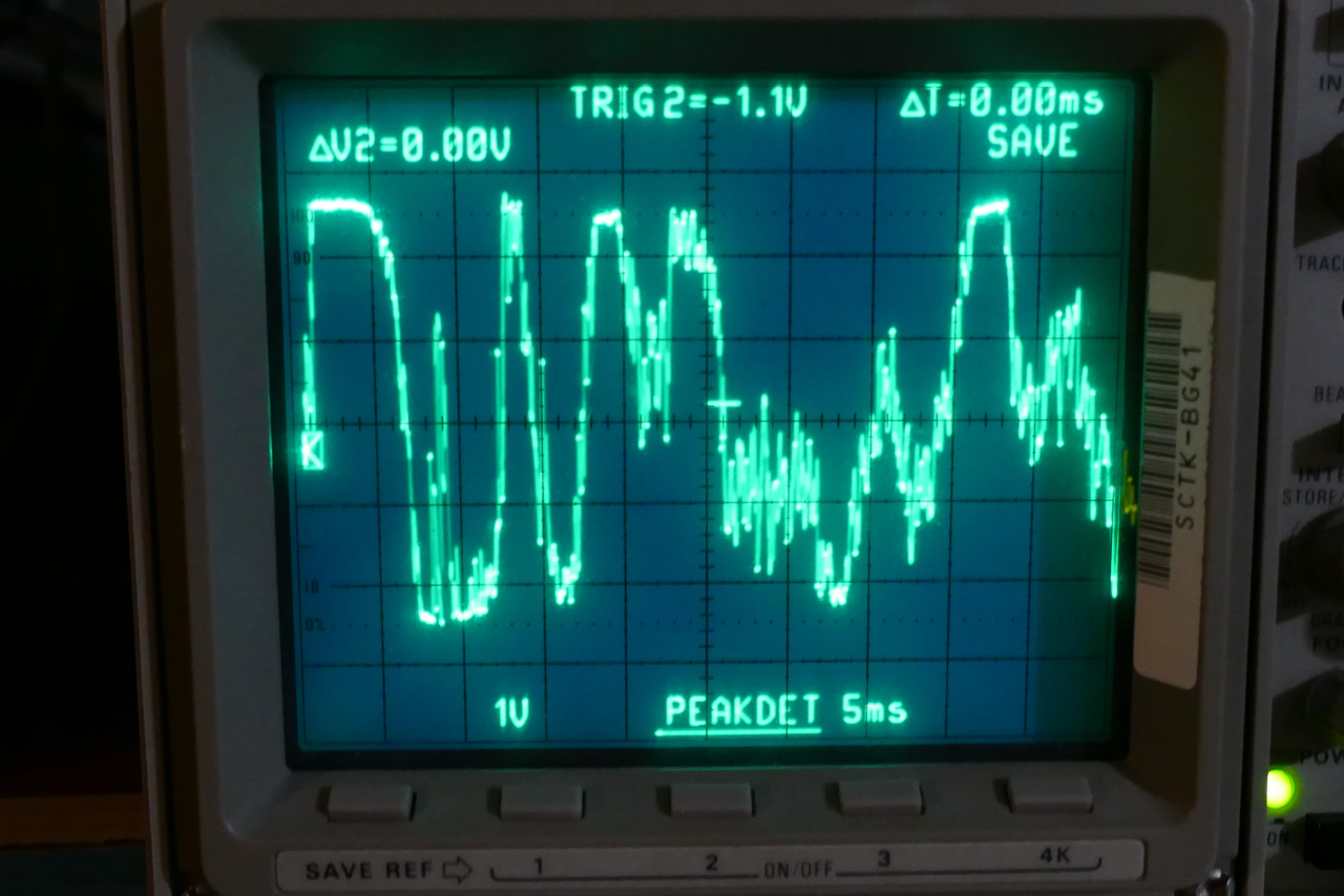

All of the music sounded great, and the plainly visible clipping on the TNAF music was not as obnoxious as it looks, although quite audible. It was the bass sound from a synth, which is distorted to begin with, and the small satellite speakers couldn't reproduce it faithfully anyway.
My guess was wrong. Squeezing 40+ watts out of tiny tubes is happening because we are well into AB2. This also explains the 100+ watts from some 6L6GB's. The transition from AB1 to AB2 occurs at about 13 watts on 340 volts, and 16 watts on 400 volts. This means that the power seen in previous testing was also helped with some grid current. How much grid current?
That's where things get tricky. I saw excursions over 30 volts at the INPUT OF THE TEST BOARD. The boards have 1K grid stoppers on their BOTTOM side. I need to remove the test board, install a smaller stopper, and make both ends of it accessible for grid current measurements.

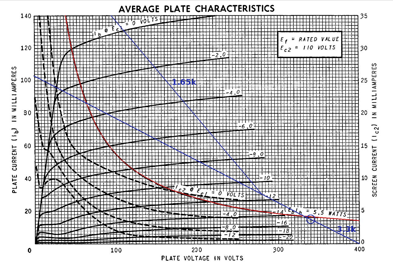

I was really curious what this recipe (106V screen, 340V anodes, 15 mA idle, 6.6k Raa transformer) would look like in a traditional load-line plot. So I went ahead and plotted it.
I started with data-sheet curves for 110V on the screen grid, which is at least somewhat close to the actual 106 V.
Assuming 6.6k is the end-to-end impedance of the output transformer, the load seen by each valve around idle should be 3.3k. Idle current is 15 mA, so at anode currents of more than 30 mA, the second valve should turn off, and the working valve will now see a 1.65k load impedance.
The resulting plot is a head-scratcher for me, because it is so far from reality! George's measured numbers tell the truth: in practice, a 50C5 is happy with these operating conditions. But my load-line plot looks so far above the maximum dissipation curve that it seems like a terrible mistake.
Incidentally, from the load line, I would only expect 12 watts RMS, mainly because a lot of voltage seems to be lost in the valve on negative peaks (the anode can't drop below 120V or so). Clearly, this wasn't happening in reality, since George measured 30 watts output, not 12 watts. This probably has something to do with driving the valves into AB2 mode, creating new curves above the topmost Vgk=0 curve on the datasheet, and so allowing the anode voltage to drop much lower than 120 V.
For what it's worth, the "no more than 12 watts in AB1" seems to agree fairly well with what George reported - that AB2 begins above 13 watts.

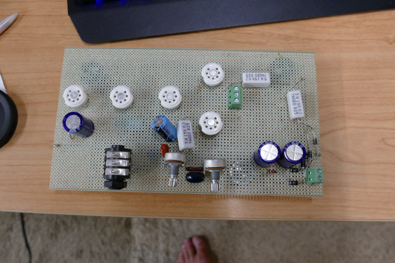

All experiments done today used a pair of 32ET5's into a 3300 ohm load. B+ was 340 or 400 volts, G2 was 150 volts and the OPT is 6600 ohms. Idle current is 12.5 of 15 mA per tube.

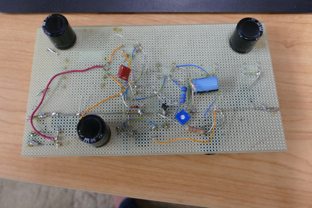

I rewired the board so that there are 100 ohm grid stoppers on the top side of the board in place of the 1K ohm on the bottom. This makes it possible to put a scope probe on both ends of the resistor. One of my old scopes has a way to do a differential measurement, thus measuring the voltage across the resistor to determine the grid current.
The 32ET5 when running on 400 volts and being driven to clipping sees 15 mA of grid current on peaks. It does this at the +15 volt peak of the sine wave drive. This means the control grid dissipates 225 MILLIWATTS for a brief instant when the tube is driven to clipping. No grid is going to burn out here.
The reduced grid stopper removed the soft clip seen previously. These tubes now clip like most other tubes. The rising distortion once entering the grid current region is gone too.
Enclosed is a spreadsheet of two test runs. The first is at 340 volts B+ with the idle current set as 15 mA per tube. This gives the lowest distortion within a reasonable plate dissipation. The tubes see about 9.5 watts of dissipation when pushed hard at this voltage. There seems to be no issue at this level. The plate is the same size as the 6AQ5's 10 watt plate. I have not yet found the power level needed for red glow. The screen dissipation hits 1.6 watts when the amp is pushed to 30 watts out. It goes way up when pushed harder. Attempting to hit 35 watts results in a glowing red screen grid and 40 mA screen current per tube.
The second test run extracts 40 watts from the same tubes by turning the B+ up to 400 volts, and lowering the idle current to 12.5 mA per tube to reduce idle dissipation. I ran the tests, then set the generator for 40 watts output (slight clipping on the top of the wave) and left it for 1 hour while I made this spreadsheet. The tubes were dissipating about 13.5 watts each, yet nothing was glowing, so I took pictures. The shot in the dark is at 40 watts output after over 1 hour of continuous operation. The yellow "Sylvania" paint is still yellow. I have been able to turn it brown within a day by extracting 100+ watts from a pair of 13GB5's. Anyone ever see blue glow on the glass of a cheap radio tube?
The 40 watt test is probably a bridge too far, but it proves the feasibility of 30 watts on 340 volts. I can see AMP 1.5 becoming AMP 1.6 although I'll leave the original alone, and make a new one.

I'm a little confused, the OPT is now wired for 3300 ohms anode-to-anode? So each valve sees 1650 ohms in the class-A (less than 30 mA current change) part of the cycle, and 825 ohms in the class-B part (more than 30 mA swing)?All experiments done today used a pair of 32ET5's into a 3300 ohm load. B+ was 340 or 400 volts, G2 was 150 volts and the OPT is 6600 ohms.
Idle current is 12.5 or 15 mA per tube.
Or is it 6600 ohms anode-to-anode, 3300 ohms per valve in class A, and 1650 ohms per valve in class B?

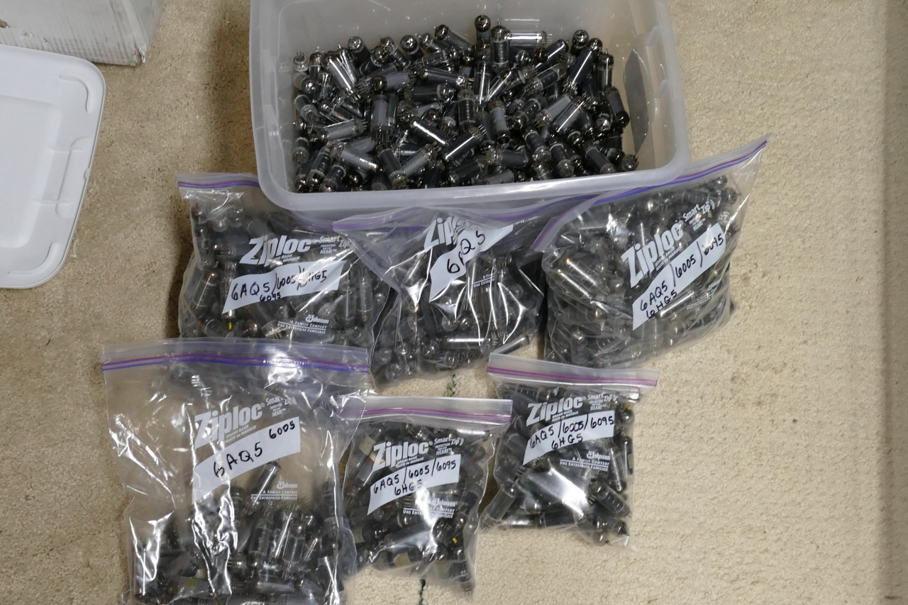

I said that I had LOTS of 6AQ5's!

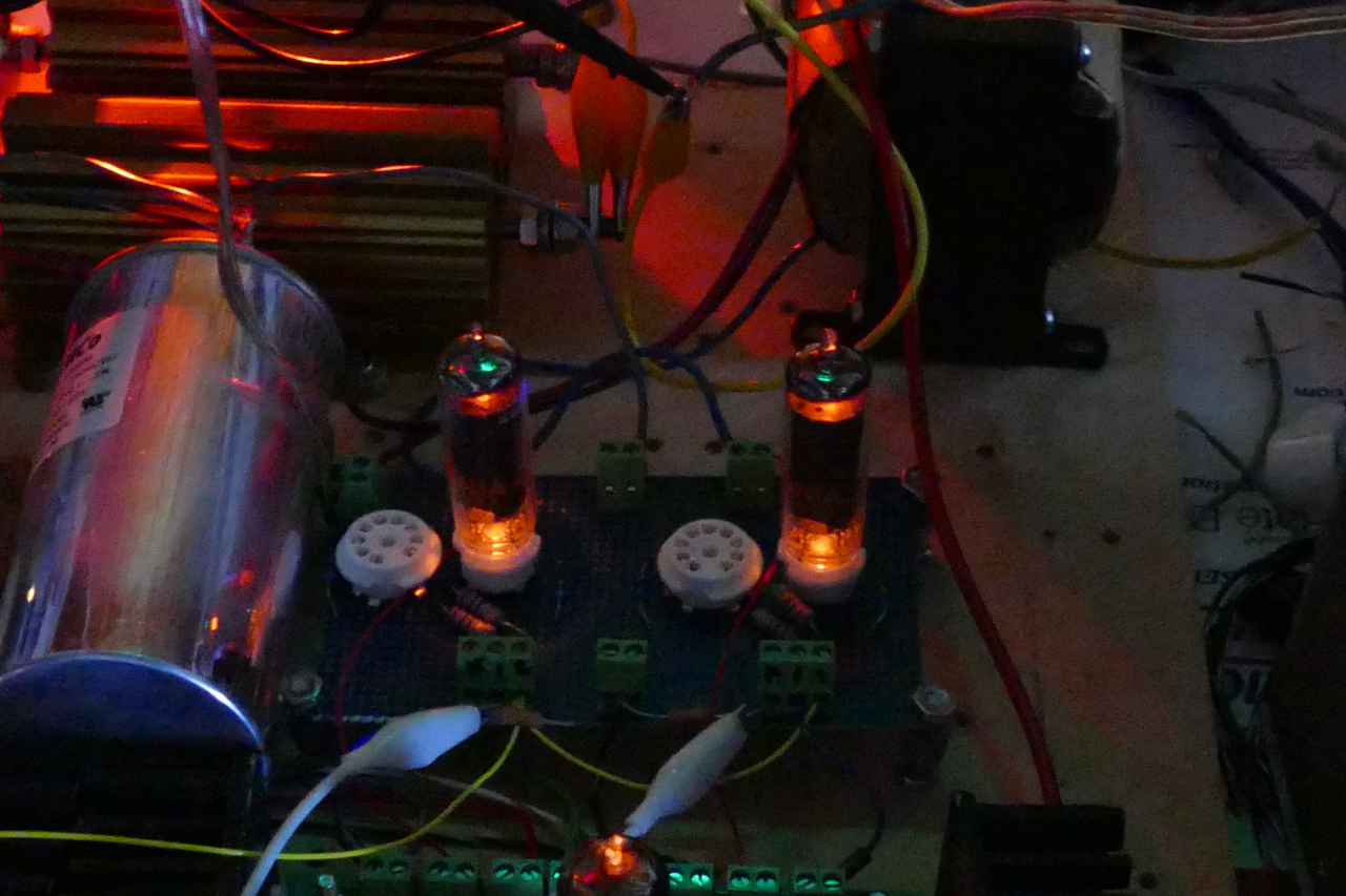

Initial testing on 340 volts revealed a brick wall at 20 watts with AB2 happening. Trying different combinations of screen and bias got me to 22 watts. So, the next obvious thing is to turn up the B+. 400 volts brought 30 watts AND a pale red spot on one plate after a 10 minute heat soak. More experiments will dig deeper, but this means trying different load impedances.
A rough calculation shows that red starts at about 14 to 16 watts of plate dissipation.

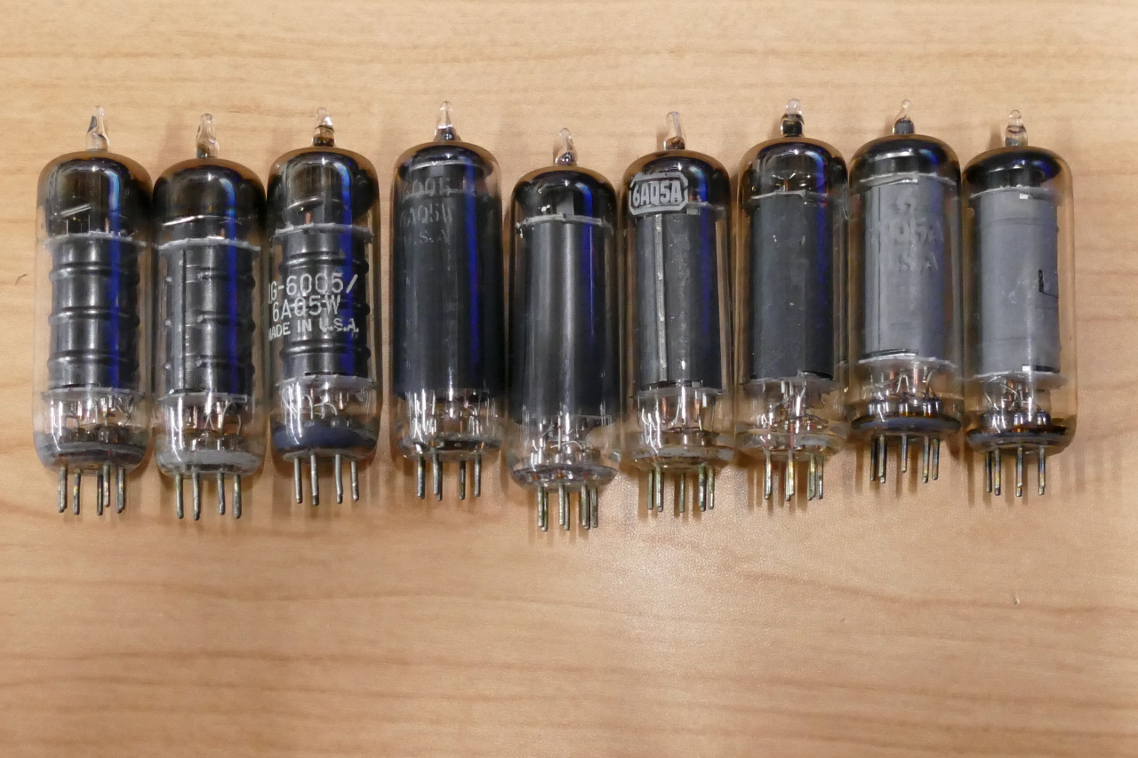

What is a 6AQ5? All of these have the numbers 6AQ5.. on them.
The three on the left are also numbered 6005. They are GE made, and have plates that are about 20% smaller that "normal" 6AQ5's. When tested on 400 volts they make 23 watts. They don't glow red, they just won't go past 23 watts.
The next pair are Sylvania 6005 / 6AQ5W, the exact same number found on the clear glass GE's. They however have no problem cranking out over 35 watts without glowing. I now have the third set of these sitting in the hot seat cranking out 36 watts @ 3% THD in the exact same setup as the 23 watt "wimps." They have been in there for over 30 minutes.
The black plate RCA 6AQ5A's are another winner, two pairs made 35 watts for 10 minutes each....no glow.
The grey GE's on the far right however do glow at 30 watts. Note the tab on the plate in the tube on the right. That's what glows.
There are several more different "6AQ5's" that I haven't tested, but id does seem that the 15 watt limit is bogus when AB2 is allowed.

This afternoon's fun was attempting to blow some 6AQ5's. I found one that has most of its cathode coating rattling around loose inside the glass. I figured that it would be good for some fireworks on 400 volts, but there were no sparks, just weak and distorted output.
I did however find that there are two kinds of tubes with the number 6AQ5 on them. Those that make under 25 watts on 400 volts, and those that make over 30. The low power flavor has a smaller plate. I put them aside and proceeded to torture several pairs of the big boys at absurd power levels. 40 watts output brings tube killing screen grid current, but I made some quick measurements and cut power. Distortion at 40 watts is in the 10 to 15% range and severely clipped. 35 watts however comes at 3 to 5% distortion and 14 to 15 watts of tube dissipation against a 12 watt spec. Screen dissipation is 1.5 to 1.9 watts against a 2 watt spec. The efficiency is still 8 to 10% lower than the 32ET5 / 50C5.
I ran several pairs for 30 to 60 minutes at 35 watts , and only the tab on the GE tubes showed a faint red glow.
Would I recommend making a 6AQ5 amp on 400 volts, probably not, but this testing proves that the 250 volt spec has some margin, and more than 10 watts are possible. Where Is the line? I don't know yet.
I spent several hours with a BIG box full of tubes and didn't blow any up. That's far better that my previous experience with these same tubes....I have owned these for over 20 years.
1st round of experiments.
I sorted these out of probably a few thousand 6AQ5's that were on their way to a landfill when someone found mercury inside some rectifiers and stopped the bulldozer that was tearing down the building with the tubes inside. Many were broken or so corroded that the pins would fall off when touched. I had fun blowing some of them up while sorting.

All this talk about 6AQ5's made me look up the few that I have.
Sure enough, only one RCA 6AQ5.
The others are French SFR 6005/6AQ5W, shorter plate looking like the GEs but with the plate ridges flattened.
The SFR logo is etched on the glass, together with the type numbers.
I wonder why the French used US type numbers instead of the European EL90 name. Could it be different specs?
Looking around datasheets, I find different max disspiation (10-12W) and max cathode current (55-67mA)
