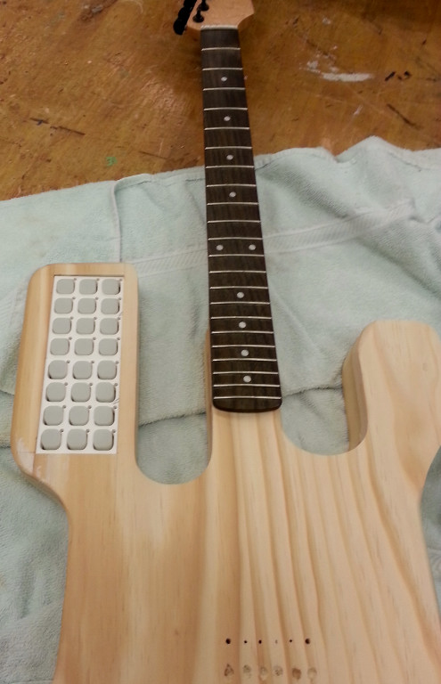

Most of my guitar building were experiments in where to put extra features like MIDI pads, faders and knobs and maybe some drum pads so the whole thing could be wired up to a PC running Ableton Live. I had worked on several just to find that they were not playable in a real life situation. This usually resulted in the neck and hardware being removed and the body being tossed into the dumpster and me starting over.
My first one took nearly forever, was made from good poplar, and looked pretty nice. Unfortunately it has no sound, was not very playable, and didn't fit well with my body. NEXT.....after a few iterations, I had resorted to using whatever scrap pine I could get (usually old waterbed frames) and slapping something together in two class times (maybe 5 hours). I remember building one, playing it, stripping it and tossing the body over my head into the dumpster in the corner of the shop.

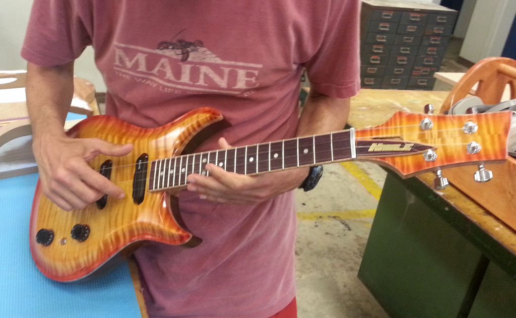

A friend in the class was making electric ukes. He finished one of his basic (no electronics or paint) instruments on the same night I finished one of mine, so we sat around the classroom until late one night playing old Beatles songs without amplification. It would be my last build in that class (lost my job), and never got finished. He would go on to finished his, and build three more before being diagnosed with terminal cancer. Here are some pictures.

He did a nice job. I have some waterbed pine that I picked up when a neighbor tossed it out. I am going to use it for making some necks as it is pretty stable by now. My pine body Telecaster that I need to finish. Poplar neck and maple fretboard.
