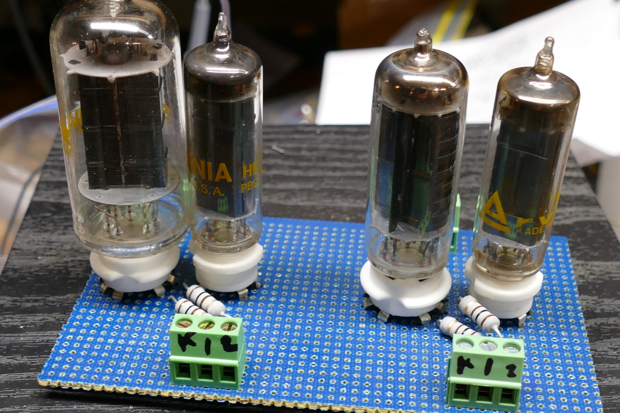

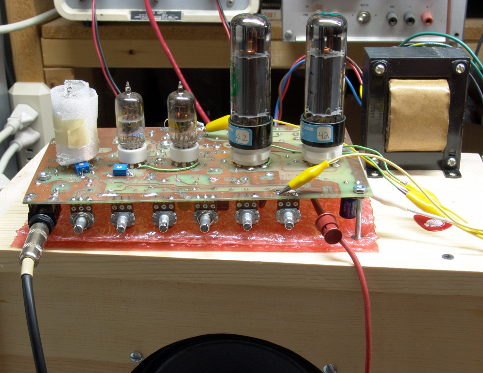

I stuffed the two 9 pin 6W6's into the test board next to a pair of 50C5's. The skinnier tube is the 10 watt flavor. Its plate is almost touching the glass, so I'm guessing that there isn't much margin between cranking and melting, but only testing can find that limit. I have a few of these and most of them were made in Canada, in fact the word Canada and the type number are the only markings on the tube. I have 4 that were made in the USA, but I can't tell for sure who made them. All of them (USA and Canada) have identical guts.
The fat boy IS a 6W6 with 9 pins on it. Same diameter glass as the octal version. It is rated for 12 watts. It should crank up like a 6W6 does.

I have 5 50C5 tubes. One has an open heater, and one has low emission. So I have 3 usable 50C5 tubes. There is not a good matched pair available, so I tried many of the possible combinations with each test.
All tubes were from collections of tubes purchased at hamfests primarily for sweep tubes, 6SN7's and a few other goodies. One tube was actually a NOS Sylvania 50C5, the others were obviously used, and none matched the box they came in except the new tube. In all cases the NOS Sylvania outperformed the others, so better results might be obtained with two new tubes.
Test 1
No combination of tubes were happy with a 3300 ohm load at any B+ voltage., so I rewired the OPT for 6600 ohms.
Test 2
The maximum rated plate voltage for the 50C5 is 135 volts..... I decided to start with an even 300 volts, because my driver board has not been tested below 300 volts. Screen voltage was set at 110 volts (max spec). Bias was set at an arbitrary 15 mA per tube, then tweaked a bit in an attempt to match the tube currents at high power. The distortion at 1 watt was 0.89%. At 15 watts the distortion was 3% and 5% was reached at 19 watts. Cranking the drive into hard clipping read 24.5 watts, but that's not a reliable reading.
The cathode current meters read 62 and 64 mA at 20 watts. The screen current was 10 mA total, assumed to be roughly 5 mA per tube. This makes the total plate current 116 mA. 116mA from 300 volts is 34.8 watts going into the tubes, and 20 watts coming out, so the total plate dissipation is 14.8 watts split roughly even, so each tube's plate is eating 7.4 watts. The screen current is 5 ma from 110 volts, which is .55 watts. So the plate is burning 7.4 watts against a 5.5 watt spec, while the screen is well below spec. The freakin heater is burning more power than the plate!
How long will they last? Idle dissipation is 4.5 watts. The Typical operation point given for use in a radio is 110 volts at 49 mA or 5.39 watts. Unless you play it wide open all the time and can produce almost constant audio from your guitar, I would say that the typical radio runs hotter. 15 minutes at 20 watts brought no glow or ill effects, and the bias was stable, SO........

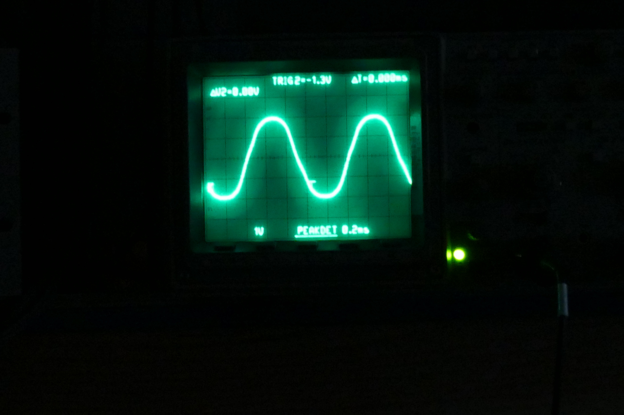

Test 3
If 300 volts didn't blow them up, what's next. Well if you are using series heater tubes, the easiest B+ voltages are rectified isolation transformer, 170 volts, or doubled isolation transformer, 340 volts, so 340 volts it is. I didn't readjust the bias, just nudged the screen voltage down a bit to keep the current around 15 mA per tube. It was 106 volts. Max power was just over 30 watts, but the distortion rose to 8%. There was no clipping until 33 watts, but tube imbalance warped the waveform a bit, it would definitely pass for "clean guitar."
The cathode current meters read 76 and 79 mA at 30 watts. The screen current was 15 mA total, assumed to be roughly 7.5 mA per tube. This makes the total plate current 140 mA. 140mA from 340 volts is 47.6 watts going into the tubes, and 30 watts coming out, so the total plate dissipation is 17.6 watts split roughly even, so each tube's plate is eating 8.8 watts. The screen current is 7.5 ma from 106 volts, which is .75 watts. Again nothing glowing inside except those 7.5 watt heaters after 15 minutes of cook test.

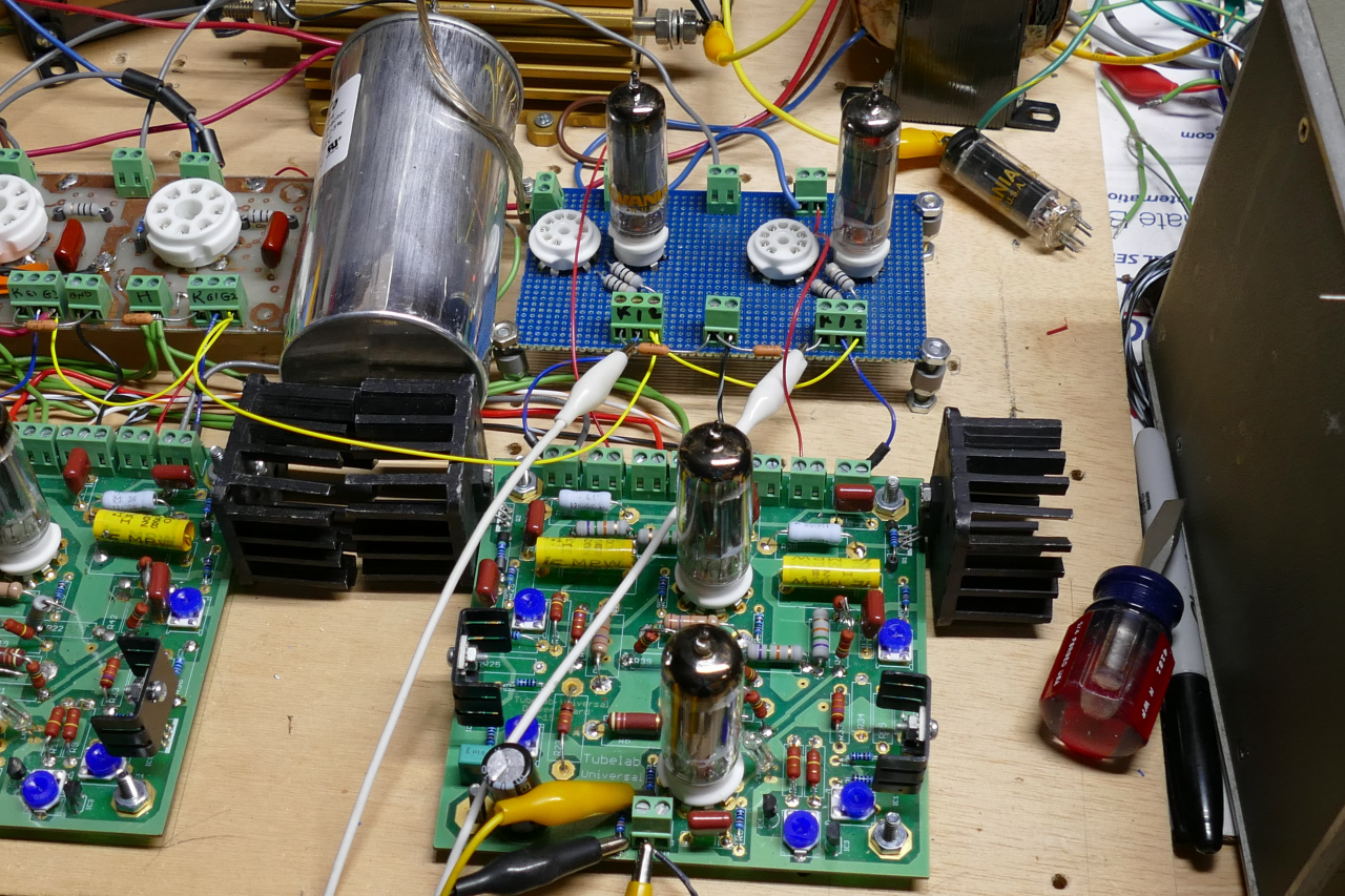

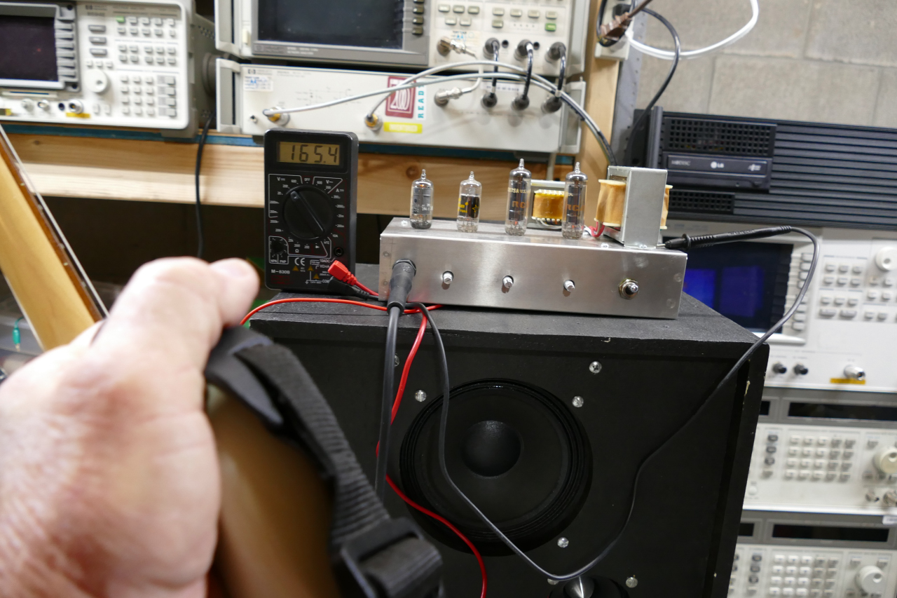

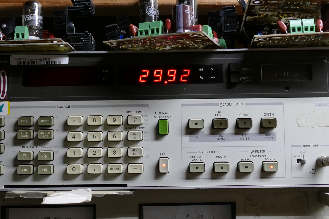

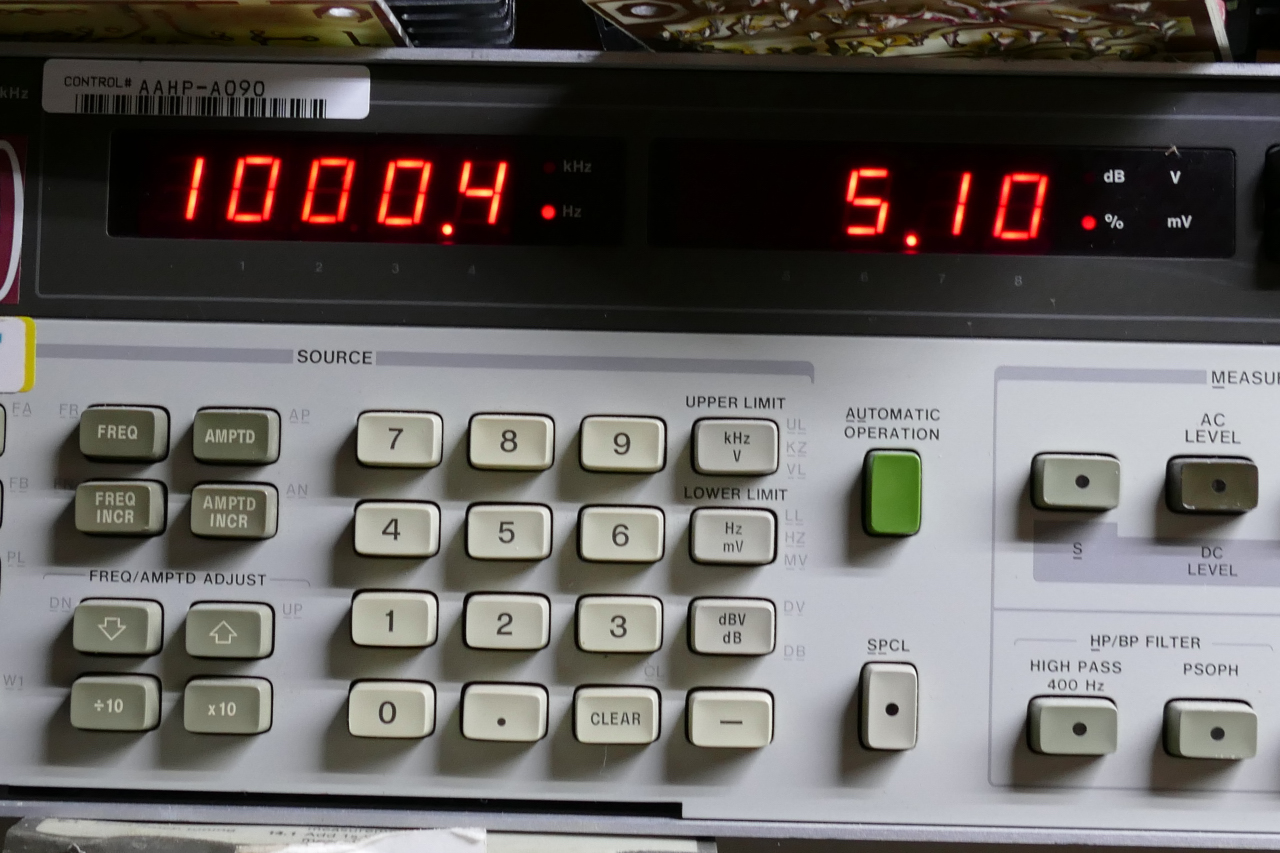

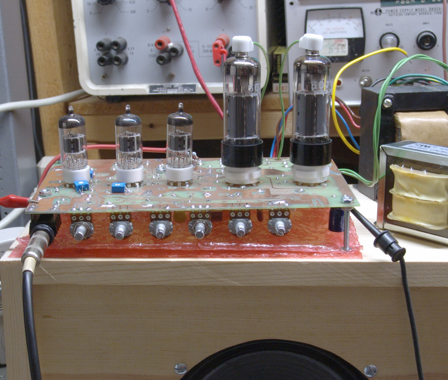

Picture 1 shows the setup with the lights on.

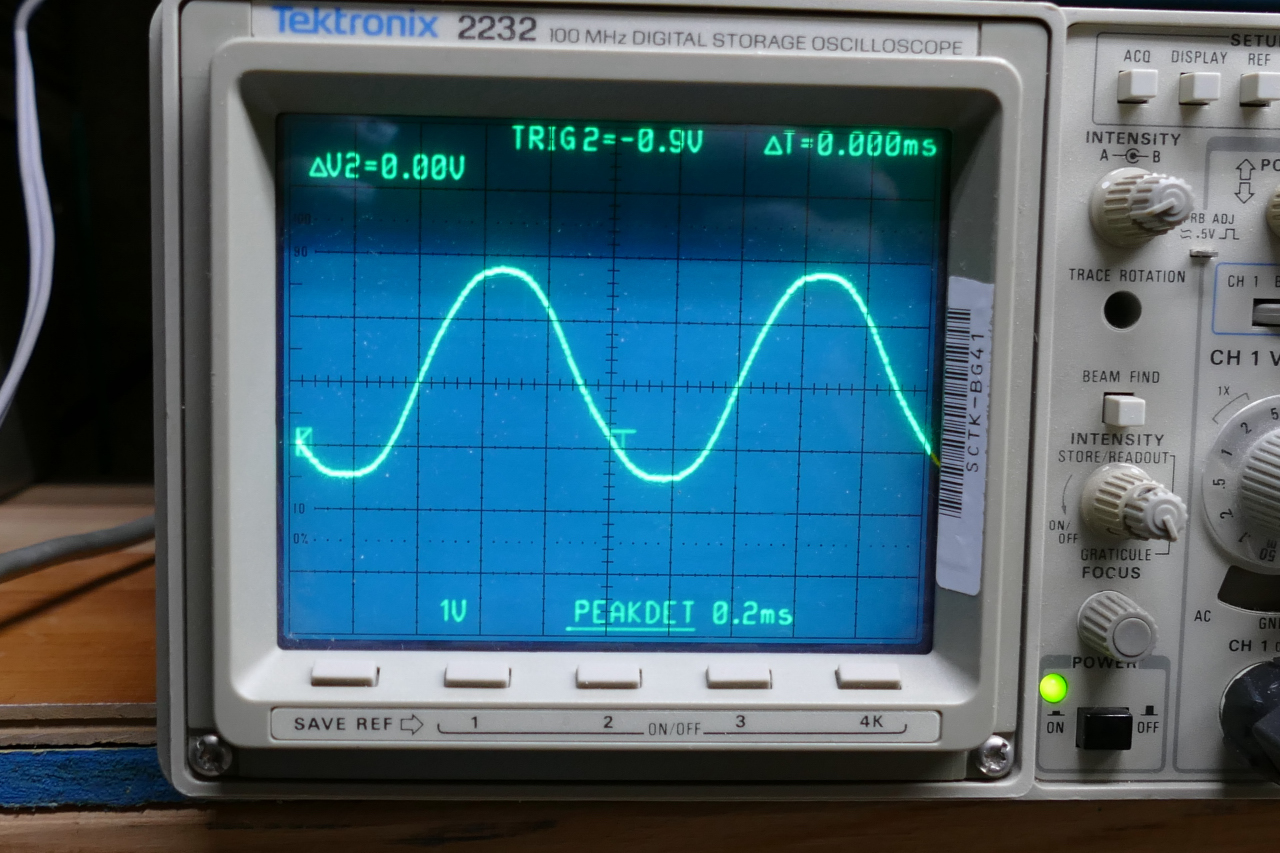

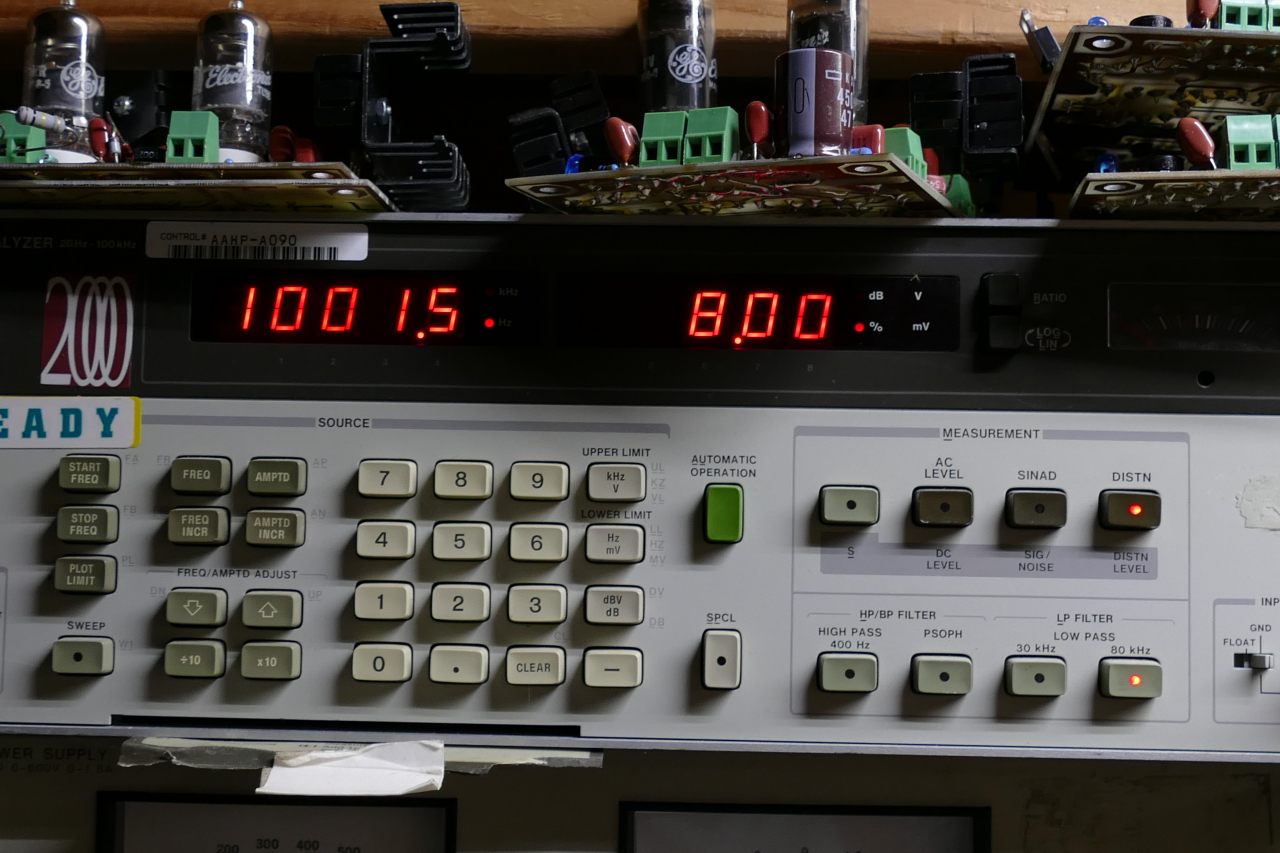

Pictures 2, 3, and 4 show the board making 19 watts at 5.1% distortion. I would later find a different combination of tubes that made just over 20 watts at under 5%. They were used for test 3

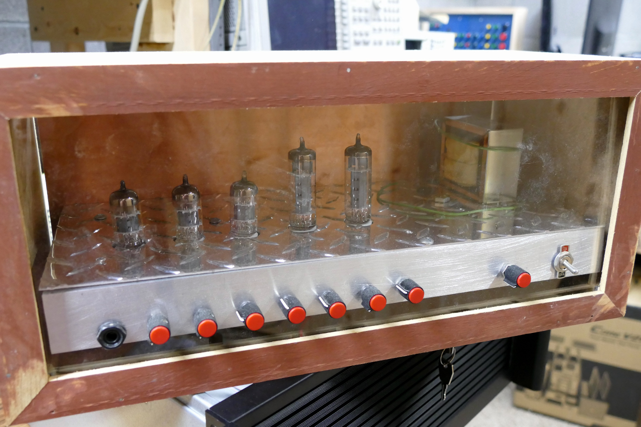

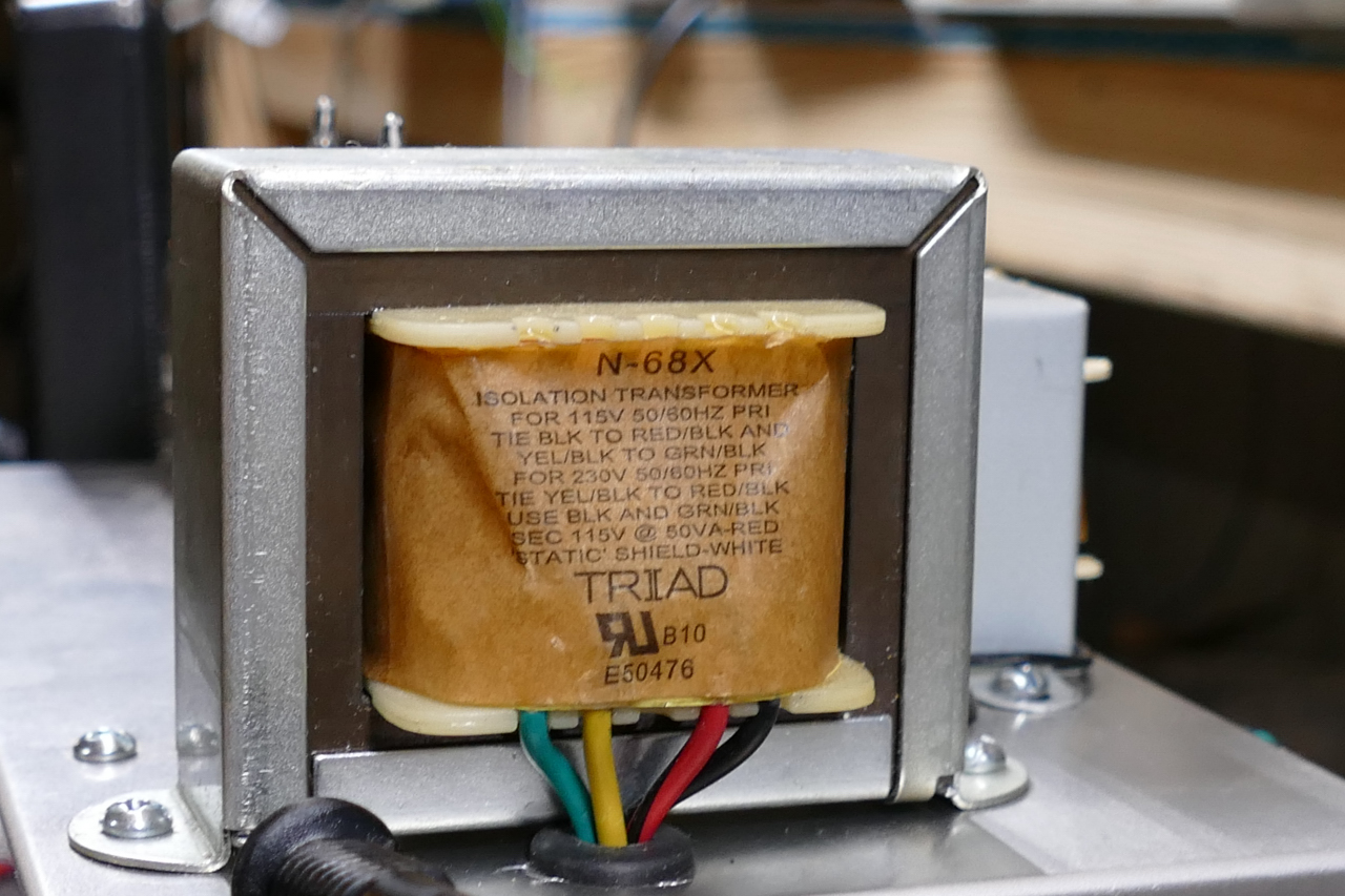

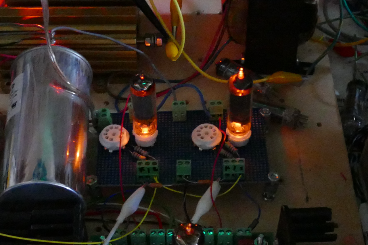

Picture 5 shows the board in the dark while making 30 watts. It had been running for over 15 minutes at this power.

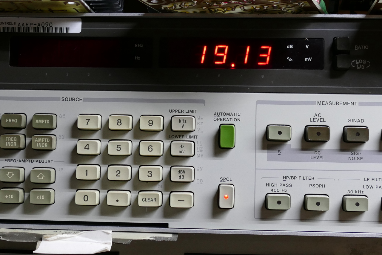

Pictures 6, 7 and 8 show the readings and scope screen at 30 watts

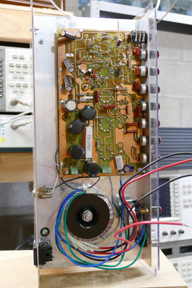

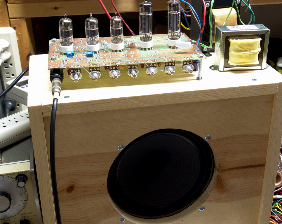

This amp design is a refreshed version of one I designed for the Hundred Buck Amp Challenge. Cost was the ultimate driver for the design, good playable sound was the driver for the refresh. The refreshed version has about $55 in parts cost in it. It uses a series string heater supply fed from rectified, but unfiltered isolation transformer, The B+ comes from the same transformer, but it's bridge rectified and filtered. The schematic is included.
Upon switch on the B+ voltage reads 164 volts and rises as the tubes begin to warm and their heater resistance rises. It will hit 170 volts, then turn downward as the tubes draw B+ current. B+ stabilizes at 167 to 169 volts depending on line voltage. It's cold outside and the electric heat is cycling. I blasted away on the guitar and saw voltage readings from 165 something to 167 something. A constant full power (all 4 watts) feedback made by holding the guitar to the speaker such that the "A" string as vibrating produced 165.4 volts long enough for me to get a picture with the camera in my other hand. A feedback note with the "D" string read a little higher, and an electromagnetic squeal from speaker coil to bridge pickup was 166 something.
Why is this? The Triad N-68X is a cheap isolation transformer with two 120 volt primaries for international use. They are wired in parallel for 120 volts here. The secondary has more turns than the primary so that it will make 120 volts into a resistive load at 50VA. I am running this transformer at 35 VA or so. It's measured secondary voltage is 135 volts with the amp running. Other cheap Triad isolation transformers act the same.
This amp has two bigger brothers, also using series string tubes, with DC power, but two different B+ voltages, 170 and 340 volts are developed by a unique full wave bridge / doubler. The power transformer is a Triad FD8-120 100 VA isolation transformer. Unfortunately those amps are not currently operational so I can't test them, but memory recalls the high B+ in the 340 volt range on the test bench. The amps were tossed in a moving box, unfinished, but they will soon be finished and refreshed.
Experience tells me that 6AQ5's will not stand up to this. The wimpy 2.8 watt cathode can not emit enough electrons to satisfy the current demands beyond 12 watts or so of audio output. This causes higher voltage drop across the tube under hard conduction leading to higher dissipation for the same power output as the 50C5.
The 7 pin tube that curve matches the 6W6 is the 12R5, which should be the best case tubes in the maximum power contest, I don't have any to test though.

The pictures of the unfinished amp show the Anteck under the deck, but the bench test on top of the speaker cabinet shows the real OPT. I also rewired the sockets, added a real power transformer, and stuffed the sockets with 6BQ7's and EL34's on the bigger big brother.....it flat out rocked at the 50 watt level on 450 volts. The foam is to damp out the microphonics......too many gain stages......refresh amp number 3.

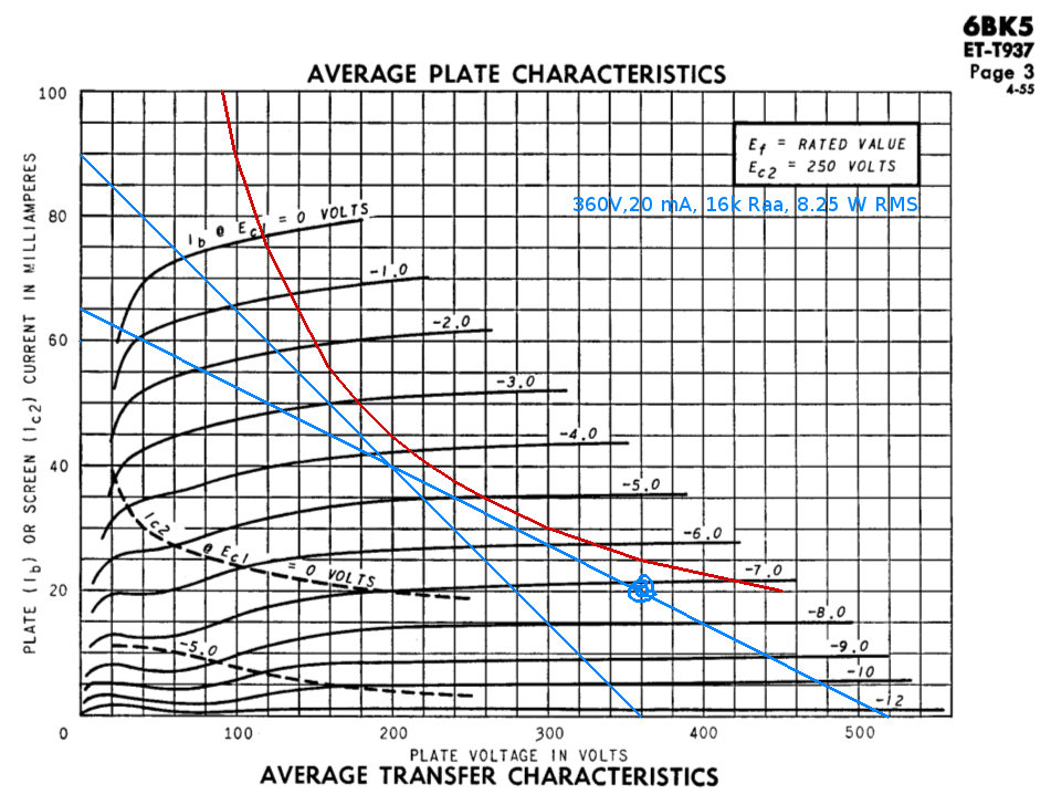

I have a few 6BK5s, the 6-volt flavour of your 12BK5s. I came up with the recipe in the attached image, but haven't tested it yet. Predicted power is around eight watts RMS. (If you send a one pair of your 30-odd 12BK5s to George, I wouldn't be too surprised if he manages to pull three times that power out of them.)Alright, then I will abuse some 12BK5's. They draw 7.5W for the heaters and only make 3.5W at 250V.
Back to the attached image, B+ was intended to come from either a voltage doubler and 1:1 isolation tranformer, or bridge rectifier and 1:2 transformer like the Triad N68X. Somewhere in the 330 - 360V DC range.
The output transformer needs 16k Raa. I figured that would come from a readily available 8k Raa transformer with the usual trick of an 8 ohm speaker on a 4 ohm tap, or 16 ohm speaker on an 8 ohm tap. I think something close to 16k can also be had with some of those 70V audio line transformers (can't find my transformer spreadsheet at the moment.)
Theoretical max efficiency of a class B push-pull output stage is pi/4 or 78.5%. In a perfect world, two 9-watt valves should be able to pump 65.8 watts into the speaker without exceeding their power ratings.
In my very imperfect world, that same pair of valves struggles to put out one-eighth of that. 😱
Meantime, in George's world, the valves manage to put out half of what they would in a perfect world, four times what I can get out of them!

12AQ5 amp that I thought could do better than it is. I doubt I am getting more than 6W out of the pair.
Their low current handling capability means that they don't like low impedance OPT's. I have several 6600 ohm OPT's. With them I could get right at 10 watts from a pair of 6AQ5's. Too bad, because I have hundreds of them. Somewhere I have a Hammond 8K or 8.8 K OPT (don't remember which). Maybe it will allow some more power, if I can find it. I remember squeezing about 15 watts from a pair of carefully selected tubes. I don't remember how I got there.

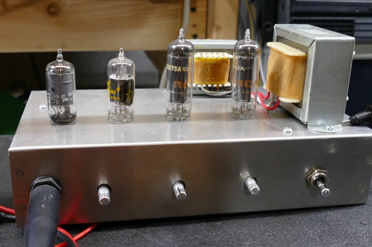

The 50C5 testing was hampered by lack of good tubes. My little guitar amp uses 32ET5's. I squeeze 4 watts out of a pair on 170 volts through a tiny 70 volt line transformer. Before rewiring, I'm going to find out if the 32ET5 or the 60FX5 can eat 340 volts. If so, maybe a new version of that little amp is in order. I will rewire the 7 pin sockets for 50B5's. They are the same tube as the 50C5 with a different pinout. I have a dozen NOS 50B5's for some more serious testing......and the 6AQ5 has the same pinout. I walked over to my storage building to look for "testable" tubes. I have to revise my estimate of how many 6AQ5's I have. There are 4 one gallon zip lock bags full and a 2 cubic foot box, all full. There has to be a formula for more power, more testing is needed.
I don't know what I will rewire the 9 pin socket for next. That depends on how hard the rewiring is VS how many different tubes it will fit once done.
