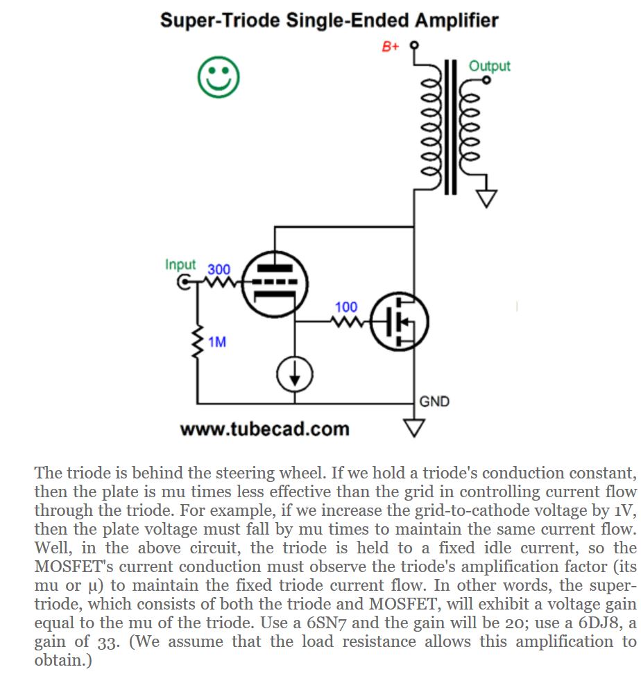

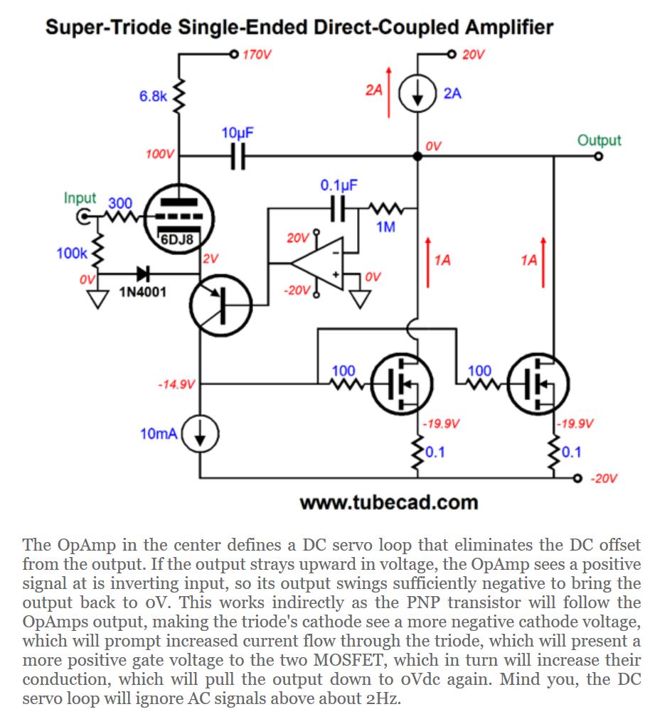

There have been a few attempts to demonstrate the supertriode topology (including from me) but there seems to be a distinct lack of interest. I have built a 50W push-pull version. I think it sounds great but I built it for my own interest and enjoyment and don't really care what others think.I thought 0.25% distortion (mostly second and third) at 36 watts with no global negative feedback was pretty good, output impedance 3 ohms.

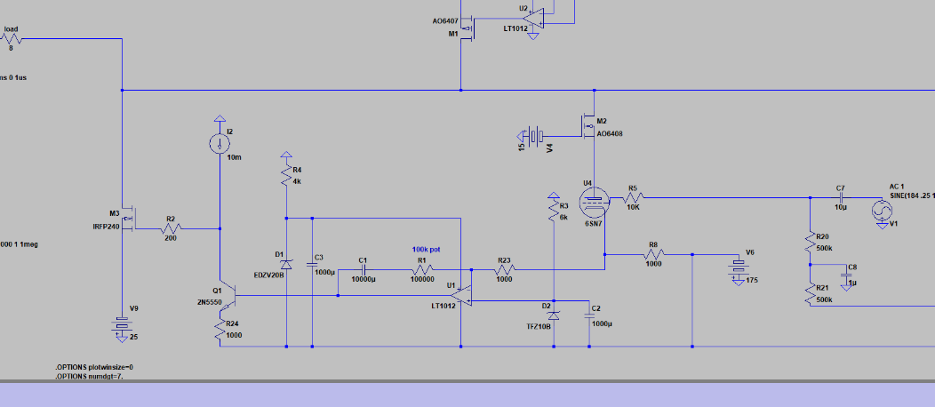

I found it difficult to follow the circuit you posted, it was laid out in an unusual way. Can you please explain how each part works? I've posted it again here for reference.
Okay fine, I'll give the thread one more chance.No kidding.
Working simulation? Really? More like a back of the napkin scribble only using a PC.
Similarly impressed with the pcb layout.
But it's the thought that counts 😀
Agreed the PCB looks like garbage, I typically like to minimize trace distances at the expense of an aesthetic layout. Unwanted parasitics are not fun.
Instead of trash talking people could (gasp) actually give constructive feedback. Whoah, new concept, I know.
The schematic looks perfectly readable to my eyes, not sure what to say there.

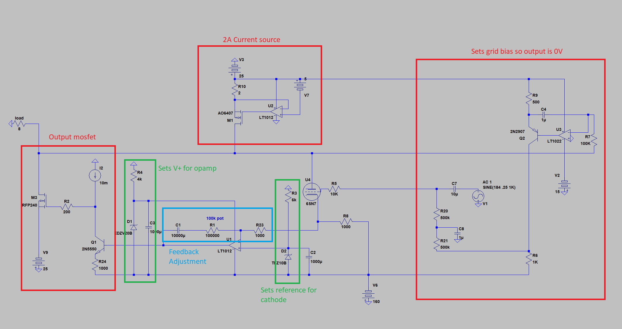

The current source at the top sets the total current. The opamp applies the reference voltage to the cathode which applies a constant current across the cathode resistor.
It does this by making the output mosfet react to the cathode voltage, applying the transfer characteristics of the triode to the output of the mosfet in order to ensure the AC voltage at the cathode = 0v.
The potentiometer adjusts the AC gain of the mosfet to allow the tube to start sharing the load current which increases the output impedance up to the RP of the tube.
As shown earlier it does a good job at perfectly replicated the harmonics of the triode under load.
There's a number of other ways to configure the circuit I but this is the one I like the most (so far).

I don't see any feedback path to make sure the Mosfet is actually putting out current proportional to the tube current. With a bipolar and a Mosfet in series at the output, it would like at least a source resistor to get close to linear response without the N Fdbk monitor. Fdbk would be even better.
The tube current is stable if the mosfet feedback loop is fully engaged. The mosfet reacts to the voltage at the cathode, not the current.I don't see any feedback path to make sure the Mosfet is actually putting out current proportional to the tube current. With a bipolar and a Mosfet in series at the output, it would like at least a source resistor to get close to linear response without the N Fdbk monitor. Fdbk would be even better.
If the pot is turned all the way down there is no feedback and the mosfet does nothing at AC. The tube drives the load completely.
If the pot is turned all the way up the mosfet ensures a stable current at the cathode, in order to do this it must ensure that there is no voltage variation at the cathode. In order for that to happen the output voltage must be exactly the same as what the tube would have produced on its own.
Therefore the tube characteristics are transferred to the solid state portion of the circuit.
Of course it can be somewhere in between where the tube and the mosfet are working together which means a variable output impedance and variable tube loading.
The bipolar is only there to allow the opamp to control the mosfet which functioning on a separate and much higher (relatively) voltage supply in order to keep the dissipation in check given the class A nature of the circuit, hence the 25v supply at its source.
A feedback resistor at the mosfet would only serve to reduce the loop gain.

It's actually a gain of 100. I'd probably make it a gain of 1000 because an open circuit here is ideally what we want if the gain is fully engaged.you used a cathode follower to drive the input of an op amp with a gain of 10, and then drive a common emitter amp to drive the gate of a mosfet...
the op amp gain times the common cathode gain is a lot, you you really need that?
The bipolar transistor is only there to boost the voltage of the opamp, the potential gain added from it is an unintended bonus.
You could just cap couple directly from the cathode to the mosfet and ignore the opamp and all that stuff but the feedback in this circuits needs to be high in order to have complete control over the cathode. Plus if the point is for it to sound like a tube then why risk it and have a weak feedback loop to begin with? Just do it right the first time.
In this particular circuit since we are using the tube as an amplifier instead of a cathode follower any voltage variation at the cathode is going to have a large effect on the output impedance. Opamp levels of gain are needed here to ensure pure DC is on the cathode when gain is fully engaged.
Yes, the current becomes less constant as you adjust the gain pot and let the tube share more current.Oh, OK.
So the tube is running constant current. There will be very low tube distortion in that case. You may not hear much illusive "tube sound" in that case. (2nd harmonic mainly)
The problem here in this particular case as I noted earlier is the plate resistance is high so there's no scenario where it will have a large amount of current variation regardless of how much of the load it is driving, if you let the tube drive the whole load then the output impedance will just becomes so high that the output voltage is be too low to cause much current variation.
In a manner of speaking the solid state part of the circuit is just an impedance multiplier that varies the impedance that the triode sees from the load between the load impedance and "infinity".

Here's a crude concept example
Or I could just do this and make the plate work under constant voltage for the same effect.

Yes it was all that gain that I was wondering about. Below are a couple of screenshots from Tubecad.com explaining the basic premise then fleshing out a SE DC coupled supertriode that does not have the extra gain between the cathode and gate. The point is to make a compound device that has the same mu as the tube but much higher transconductance and much lower rp.

The gain of U5 allows you to adjust the load line angle from horizontal all the way through vertical.

your op amp drives the base common emitter trannie that in turn drive the gate of the mosfet, you posted several schematics....i attached the the said picture..
It does. I don't understand what you mean.Why use a simulator if your simulation does not even indicate dc currents and voltages at key points?
I explained it perfectly in post #85.It doesn't make a whole lot of sense to me
simulators just like calculators can do a quick job at computing, but they do not make you any more smarter if you do not know math and can not do long hand calculations...
That's not really a helpful bit of feedback.
What did I do wrong and where?
A simulator should not even be needed for these schematics to show that they work. The theory of operation is fundamentally easy to understand and the circuit is simple. I don't see why people here are having issues when others post annoyingly complex circuits with many many parts.
