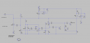

I know people aren't interested in it but I made an early partially completed PCB draft for the super triode I posted earlier for my future self if nothing else since it's the only tube thing I want to build that I haven't tried.
Before I finish it I want to know peoples thoughts on what tube I should use that has potential for the tube "Sound".
I'm planning on using the 6sn7 because it will quickly and easily begin reacting to the load and quickly allow a significant output impedance shift during current sharing adjustment since I'm using its plate as the output and it's a low current high RP tube.
Also because it's linear and shares a socket with 6as7/6080.
Any thoughts on alternatives?
you tell us your choice and then explain why you choose a tube, and then we can offer advice...unless we understand what you are up to, we can only opine...guess, i guess....

I guess I'll just use my 6sn7 then. Not that I'll be able to build it in the foreseeable future but it's good to plan ahead.
I have to admit the lack of interest, technical discussion, criticism, or even mention of the circuits I posted that this thread was supposed to be about is disappointing. I at least expected some more interest in discussing the super triode considering how much effort people go through to use tubes in their system.
How boring. I'll take my leave I think. In 4 days I'll be forced to abandon this crap for a few years anyway. If anyone with the means to measure that super circuit I discussed earlier wants to hit me up send me a PM. If not
There have been a few attempts to demonstrate the supertriode topology (including from me) but there seems to be a distinct lack of interest. I have built a 50W push-pull version. I think it sounds great but I built it for my own interest and enjoyment and don't really care what others think.I thought 0.25% distortion (mostly second and third) at 36 watts with no global negative feedback was pretty good, output impedance 3 ohms.
I found it difficult to follow the circuit you posted, it was laid out in an unusual way. Can you please explain how each part works? I've posted it again here for reference.

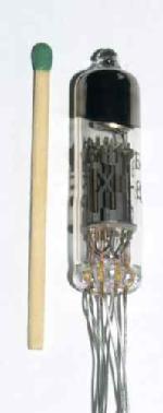

This gold grid device is in the 1-3USD bracket.
They are also some of the last valves ever made in high quality production 12/84-86
(Typically Moscow region MELZ plant - now still alive as a factory making ultra high quality precision military optics today)
common in portable electronics and missile on-board circuits. The early S-75 and S-125 missiles were full of them

As you may see by curves, 6N16B is more suitable for output stage, it is kind of tiny version of 6SN7.
This one from 2018:-
Looking at the curves on the datasheet will show that the 6N16B will perform excellent when implemented correctly, if going for voltage amplification and loaded correctly.
It's one of the better tubes around and is a real gem, also long life and affordable. I wouldn't hesitate to use one here personally, although I wouldn't really want to do a portable tube DAC ("transportable", yes, portable, eh...)
No kidding.
Working simulation? Really? More like a back of the napkin scribble only using a PC.
Similarly impressed with the pcb layout.
But it's the thought that counts 😀
