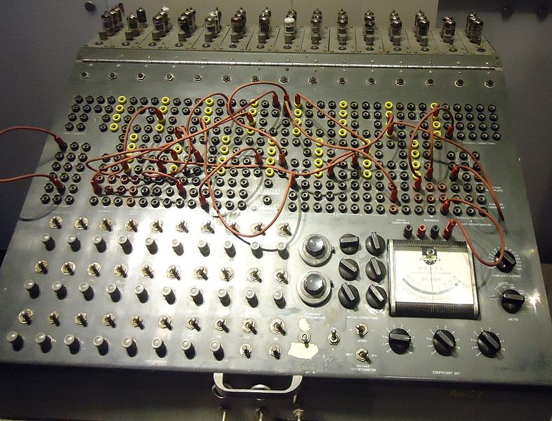

Suspension can be modeled as a complex LCR circuit from what I remember in my Strengths and Materials course in college.
IIRC, all mechanical systems can be modeled as equivalent electrical systems.
Heatkit tube Analog Computer: (notice all the tubes for the Op Amps along the top of the device.)
File:Heath Electronic Analog Computer at CHM.jpg - Wikimedia Commons
With -290 dB distortion Op Amps, you could give digital simulations some competition. Single precision floating point is not that accurate.
