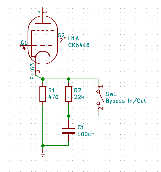

hought about hooking the capacitor (C6) on a switch, is that correct?
Yes, you can put a switch on the cathode bypass cap. There may be a thump when the switch is flipped as the cap gets charged. You can also experiment with different resistors in series with the cap.

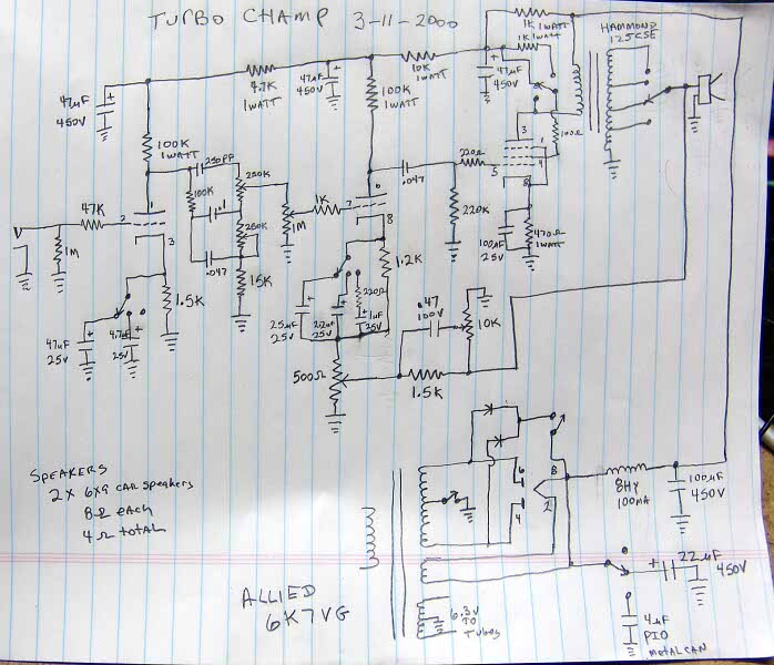

Nearly 20 years ago I made several small guitar amps loosely based on the Fender Champ. I called them Turbo Champs and no two were the same. Some used real guitar speakers and some used car stereo speakers that I got when a local K-mart store closed down. Some used the Allied power transformer shown on the schematic, some used transformers and chokes I ripped out of some old HP audio oscillators that were scrapped. Some used Hammond OPT's, and some used transformers from old TV's and radios. I did use the cap and switch arrangement on the output tube in some amps, but didn't put it in the schematic. All the switches show 3 positions, because I had a big box of 3 way switches.
I drew this schematic from memory after the fact, so it is "best guess" and probably doesn't match any one of the amps exactly. Feel free to steal any of the switch ideas I used.
I plan to recreate something like this on a bigger scale, except it will use relays and a microcontroller so it can be operated by footswitch, or even buttons on the guitar.
George didn't mention it, but simply putting a large resistor in parallel with the switch will get you thump-free switching. The resistor lets the cap charge up to the right DC voltage in advance, but the big resistor doesn't let it bypass the cathode until the switch is flipped.
The exact value of the resistor is not important. It needs to be much bigger than the actual cathode bias resistor (470 ohms in your schematic.) And it needs to be small enough to supply whatever small leakage current the 100uF cap needs, so don't use an enormous value such as 1 meg. I picked 22k for the schematic, but anything from 10k to 100k should work just fine.
The picture shows what I mean. (Please ignore the weird pentode model name and pin numbering - I just grabbed the first pentode symbol I found in Kicad, to stand in for your 50L6.)
That's what I'm gonna do.. I wonder why any commercial amplifier is having that switching option?
I see.. I didn't experienced any thump while I tested on the breadboard but it's very good to know, I will use it anyway to stay on the safe side.
Many thanks gentlemen for the switching ideas and little drawing, picture is worth a thousand words! 🙂
