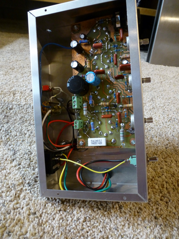

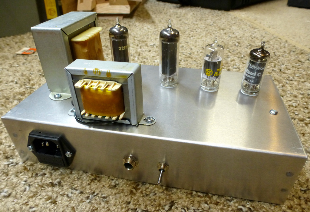

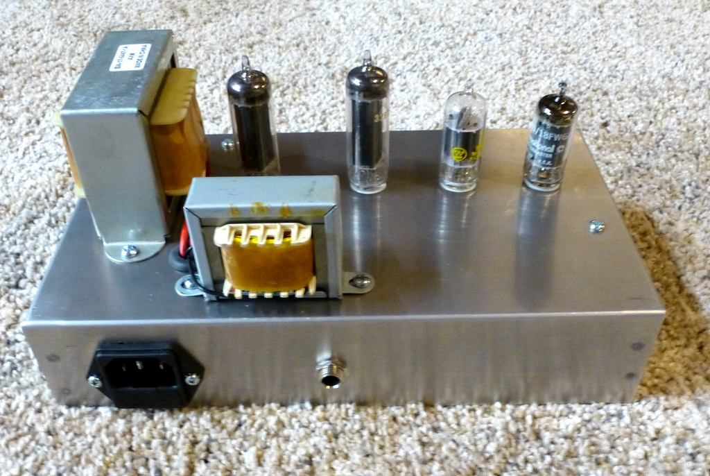

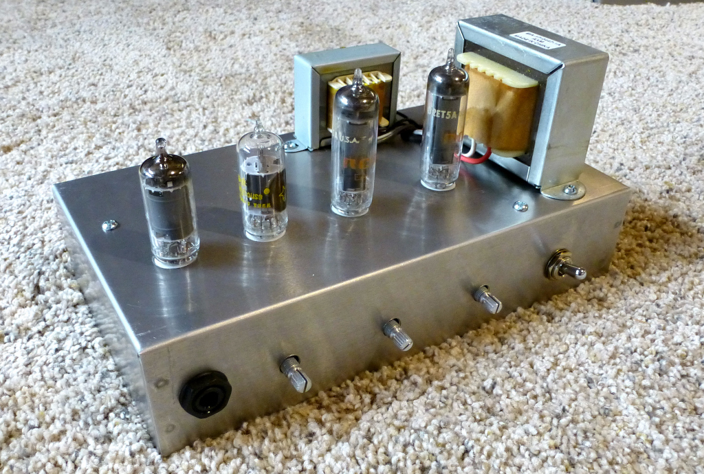

I built an amp using this transformer for an OPT. It makes about 3 watts from a 170 volt supply with 32ET5 tubes. It has been the only working guitar amp that I have except for a 100 watt monster that's far too loud to crank. I have played it off and on for almost 4 years without issue. Maybe someday I'll make a proper box for it.
What plate voltage were you running?
I was using a no-name 100VA, dual 115V secondary toroid for power, with a single winding for the heaters (all strung in series, with the 50L6 filaments on either side of the 12AX7s, and then grounding the center tap of the 12AX7 filaments with them wired 4/5 and pin 9 for 6 volts, sorry if it sounds complicated, as it's not really) and a full wave voltage doubler for around 300V raw supply voltage with the amp idling. The doubler sagged a bit under high power, and was a nice way to go for a cheap build, with similar results to the sag from a tube rectifier.
Sorry that I don't have more details, as it was practically a sweep-the-floor build with parts-box grade parts, and a chassis from inside an old record player. None of the specifics are all that critical :)
