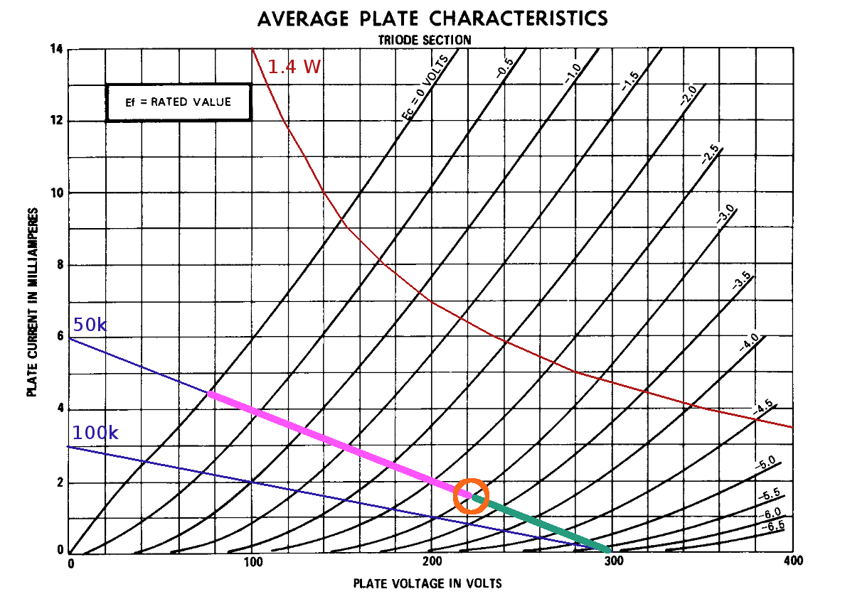

A triode output will probably give more bass with the 70 V transformer due to it's lower output impedance.
Lovely for Hi-Fi (i.e. very linear), or lovely for electric guitar (i.e. quite nonlinear with lots of tasty 2nd-harmonic distortion? 🙂 )Which is handy, because the 50L6 types make lovely triodes 🙂
The attached image shows a very non-linear triode that I think sounds quite good for e-guitar. Just look at the enormous difference in length between the green and pink half-cycle swings. This is no 12AX7!
-Gnobuddy

Gnobuddy, it took my about 8 miliseconds to figure out where those triode curves came from. Both of it's suggested uses do not require good linearity, so maybe it was optimized for something else, or it's parameters were specified explicitly by a TV set manufacturer.
