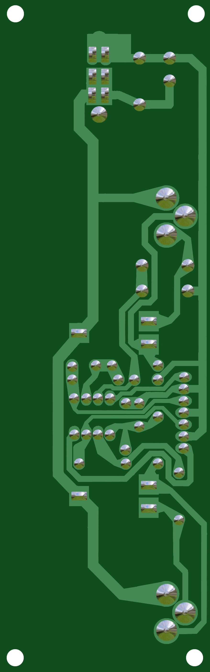

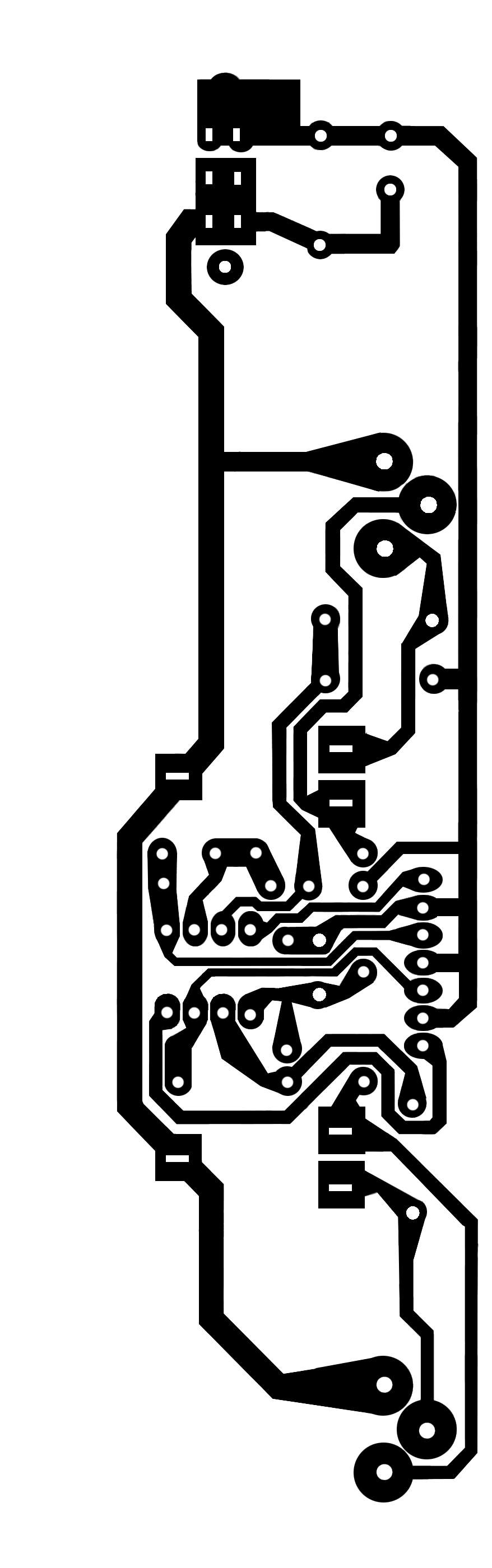

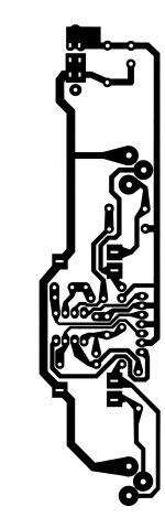

can you give me the foil pattern of the xlr input circuit?
thanks,
joel
please reduce the image until it fits with the parts size.
