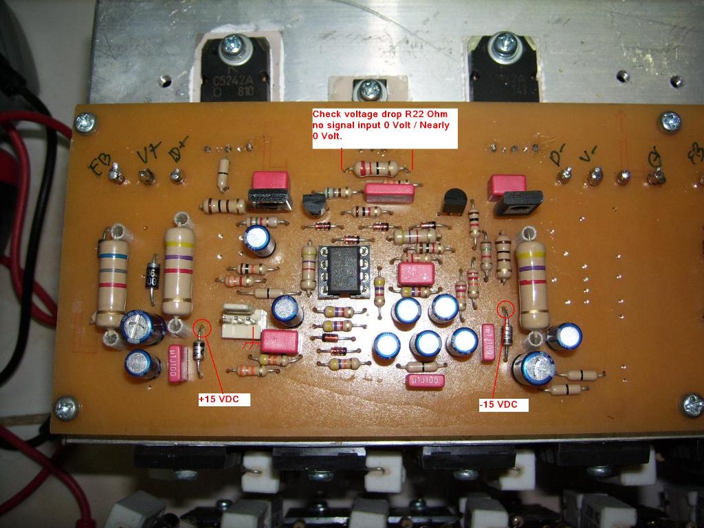

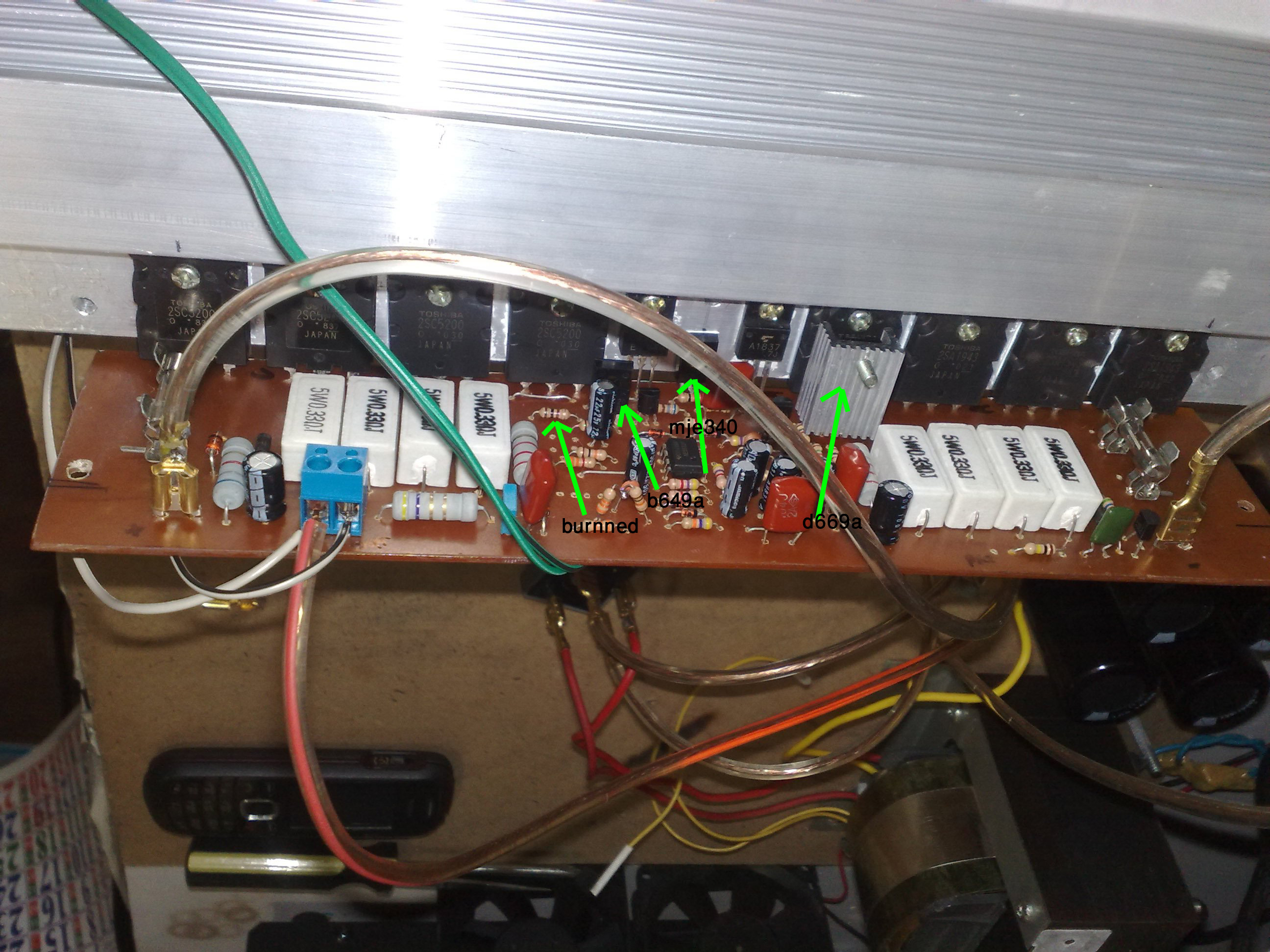

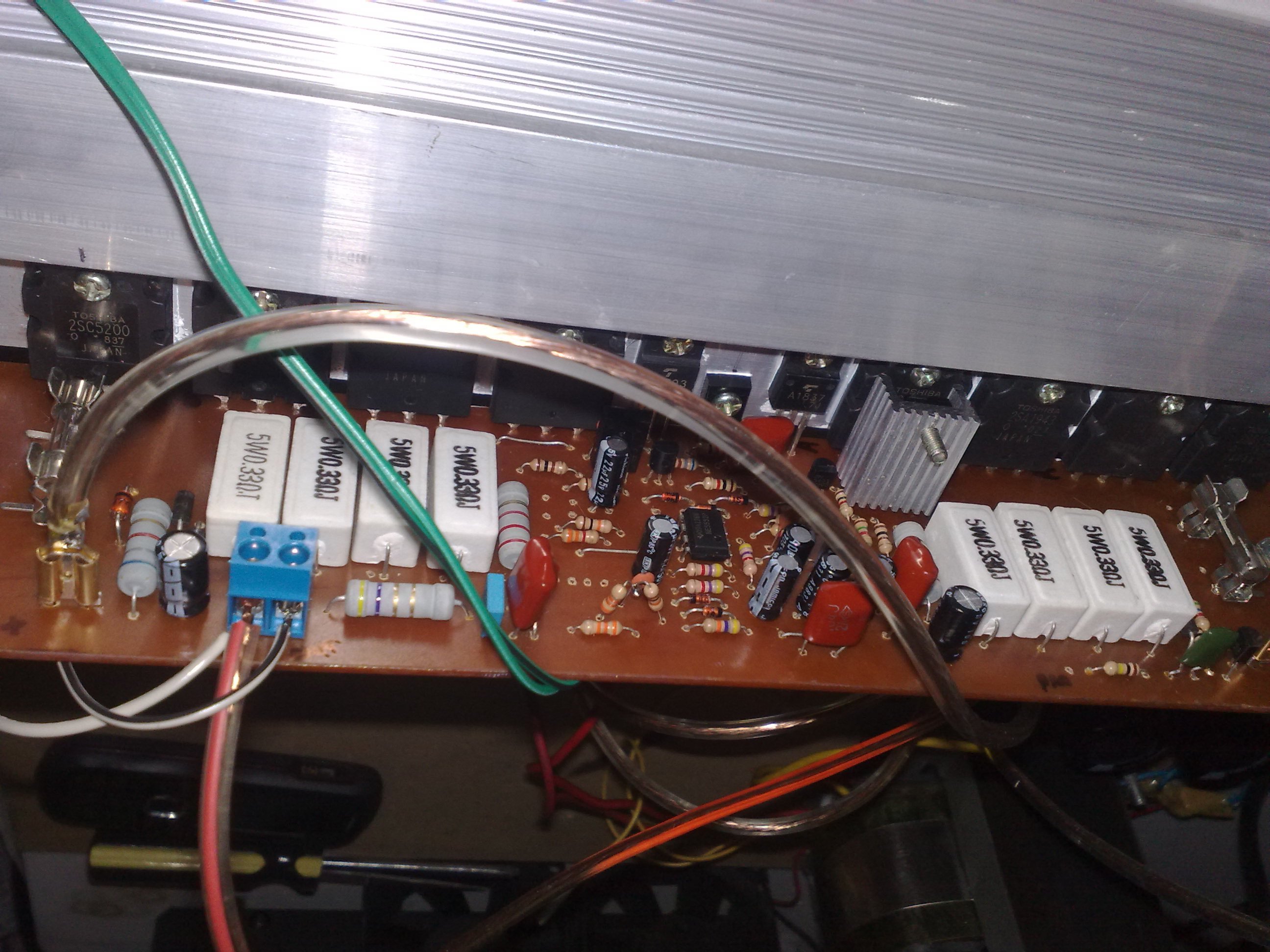

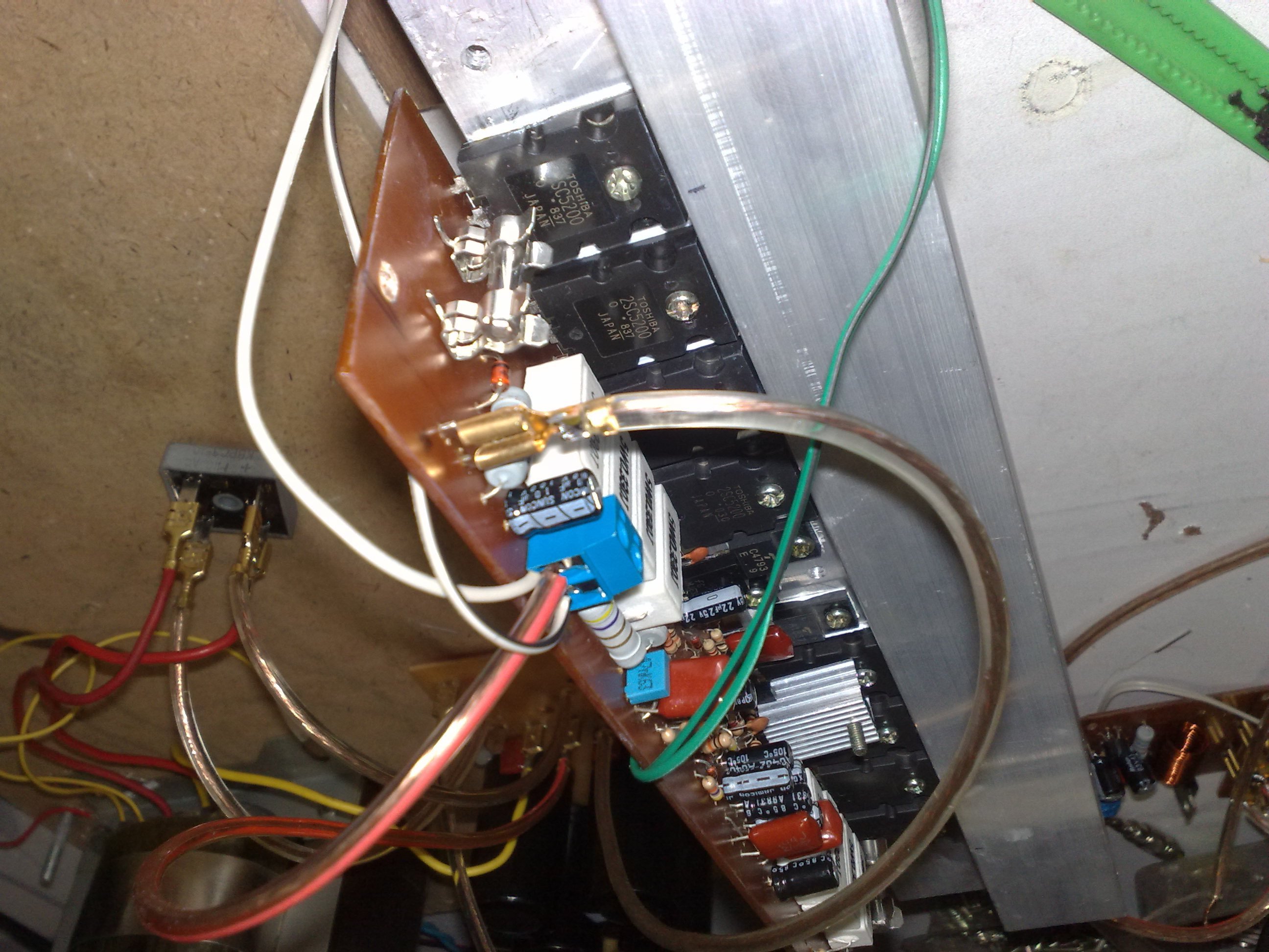

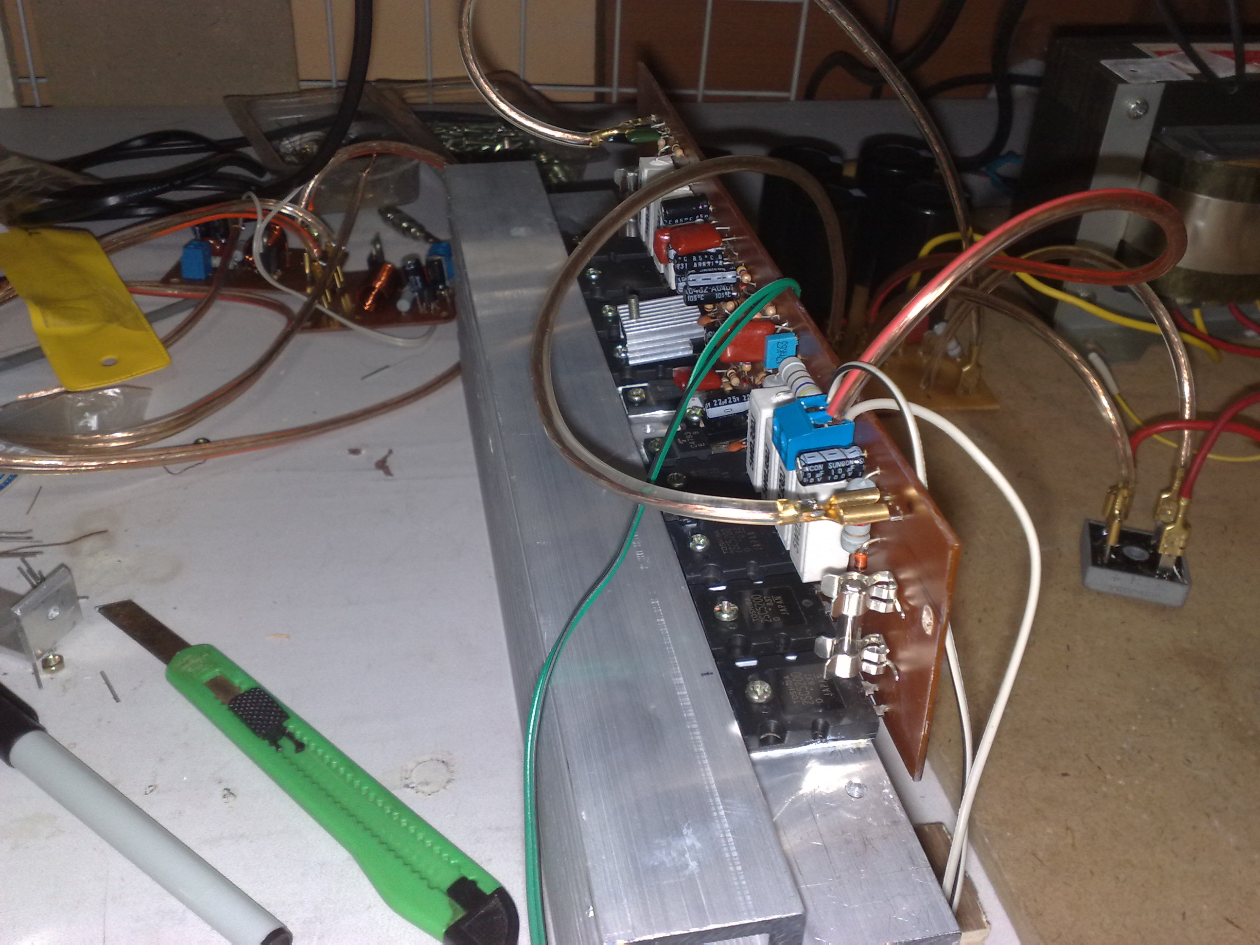

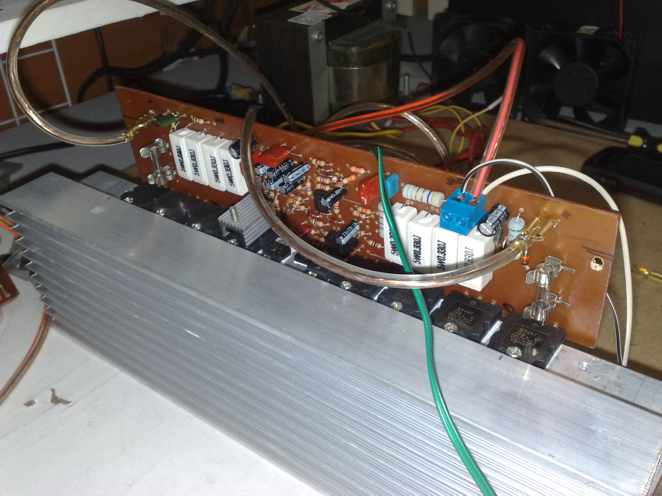

here is my b500.
first powering up with fuses 53vdc,0,53vdc amp works fine.
i used 2sd669a instead mje340. it works fine .
after one hour i change mje350 to b649a. in near d669a 100ohm resistor burned and fuses blown.
after i remove d669 and 649 with mje340,350 but same problem fuses blown.
can any body help to solve this problem.

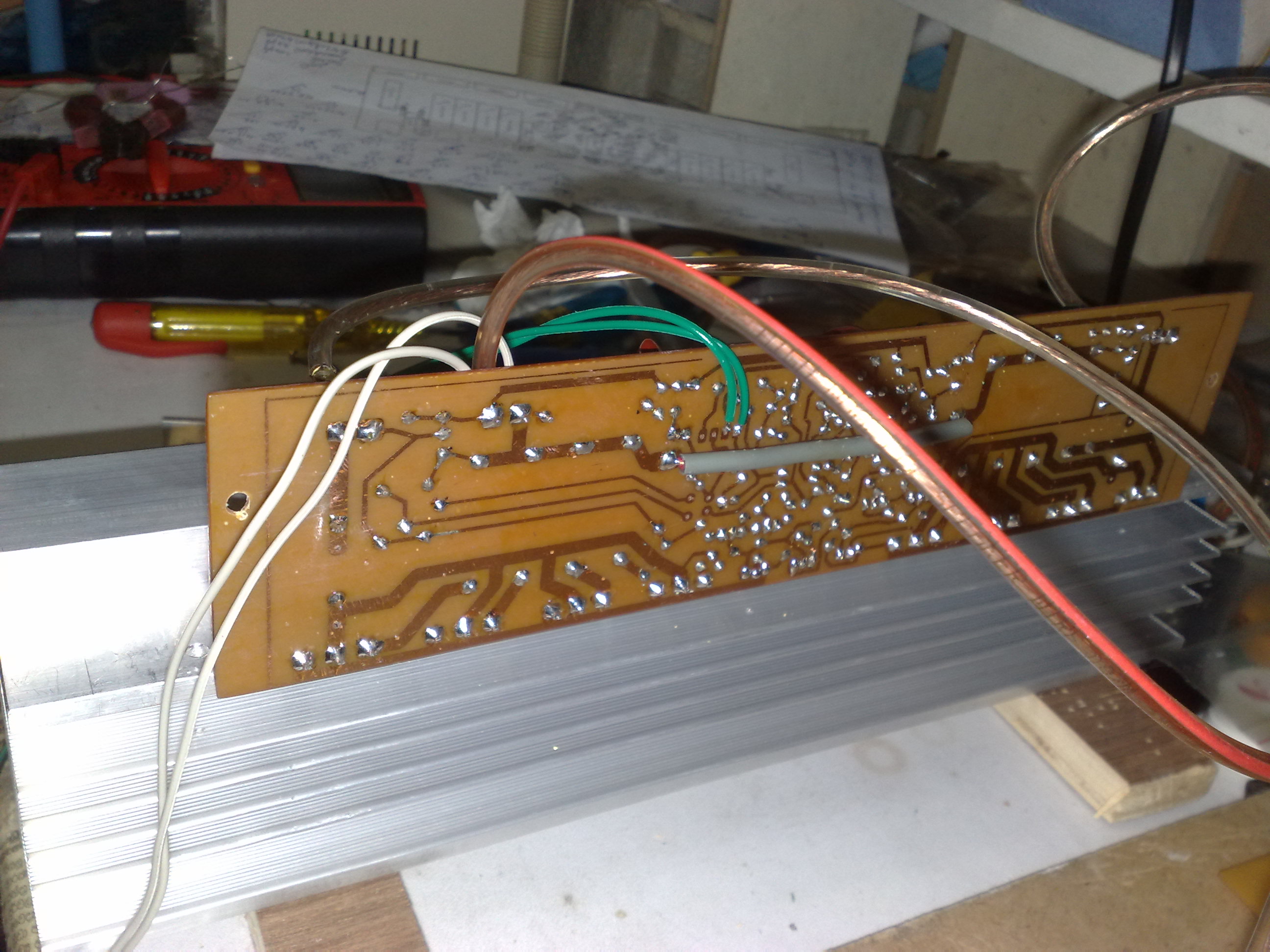

here is my b500.

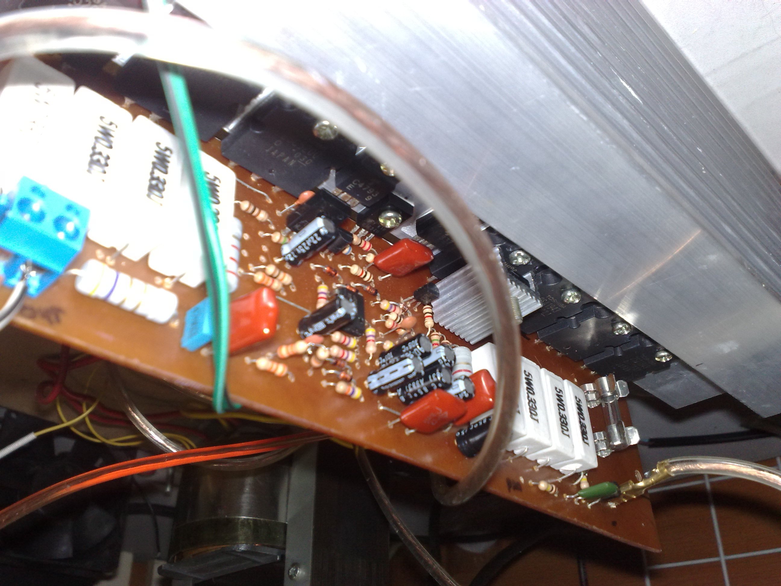

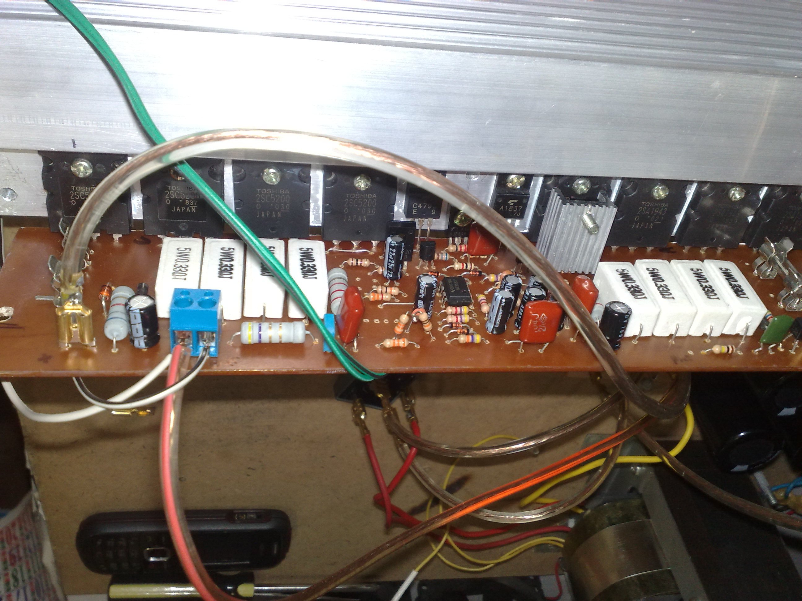

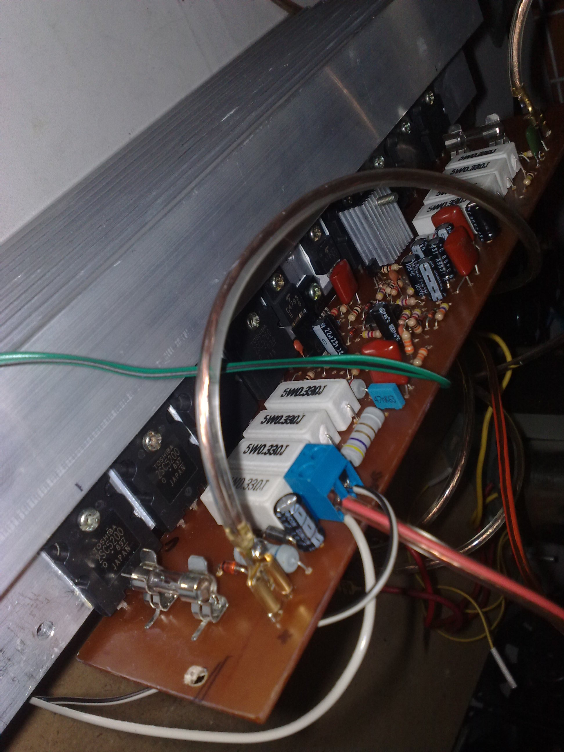

this is the photo of the parts.
Hi nazirdigi.
I think pre driver & Out put problem.
1.Teak out all power transister out put.
2.Replace all berned part.
3.Check DC power at attachment.
And surely all power transister out put no short to ground and heatshink.
Regards.

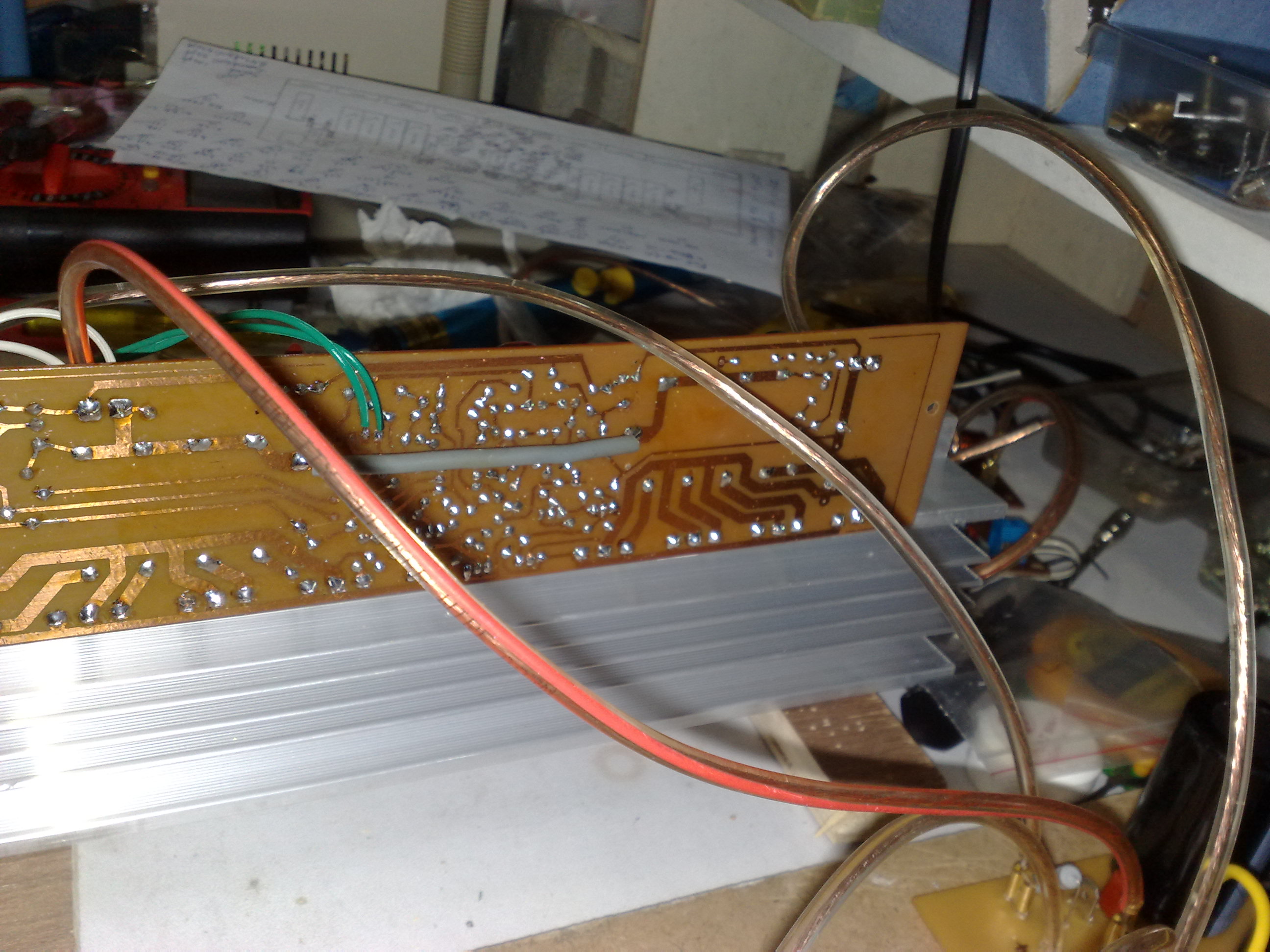

nazirdi

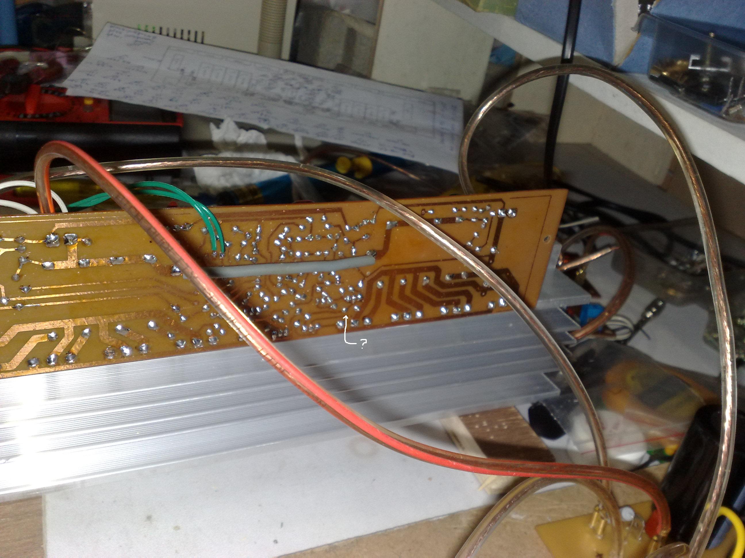

please double check this traces
i try to figure but i can only assume maybe i was wrong.
hi engel dela pen
i removed all power trans and checked 2 trans burned.
i checked the traces its fine.
may be b649 is fake i think.
